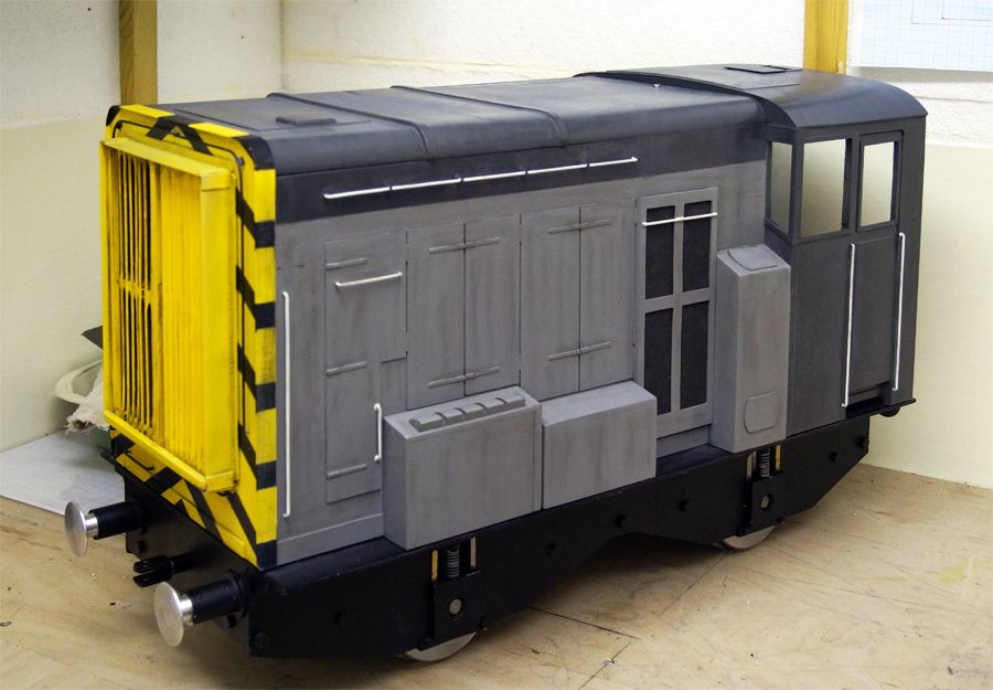

              Hi John,
              I have built two electric locos to date both my own designs I dont know if any plans exist for electric locos I havnt come across any but thats not to say they dont. The first thing you should consider is what type of loco do you want to build, scale, semi scale or a fun type loco, obviously a scale loco needs a lot of research and build time compared with a small simple fun type one. Pictures below of my two, the little 0-4-0 shunter with a simple 08 style body I built first and it didnt take too long the aim been to produce some thing quite quickly that would carry me and the grand kids around the club track. Its quite simple with a single 12 volt battery and 4 x 65 watt motors giving 260 watts total, 2 motors driving each axle through 6/1 gears, it turned out quite a capable little engine it copes with 4 adults or me and 5 children no problem.
              The Class 22 is my latest offering, semi scale as the aim was for a reasonable representation of a 22 which allowed some licence in certain areas. A lot more work and build than the little shunter though, twice as long and almost 3 times the weight 60kgs against 23kgs, 4 motors again but 150 watt each, belt drive and twin bogies driven from 2 x 12 volt batteries giving 24 volt.
              I have a build thread for each of the locos 5 inch 0-4-0 Shunter and Class 22 Diesel have a look it may give you some idea but bear in mind that I am no expert they are just my approach and take on things (keep it simple), though there is lots of ways to skin a cat.

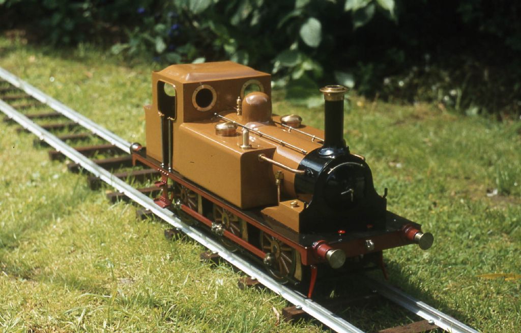

                    John, if you fancy a steam outline loco, here is a 5" G Boxhill I made many years ago. It uses all standard Boxhill parts, but the boiler shell and tanks are dummy, and under this there is a 12v motor and chain drive to one of the axles. The battery is carried in the driving trolley.
