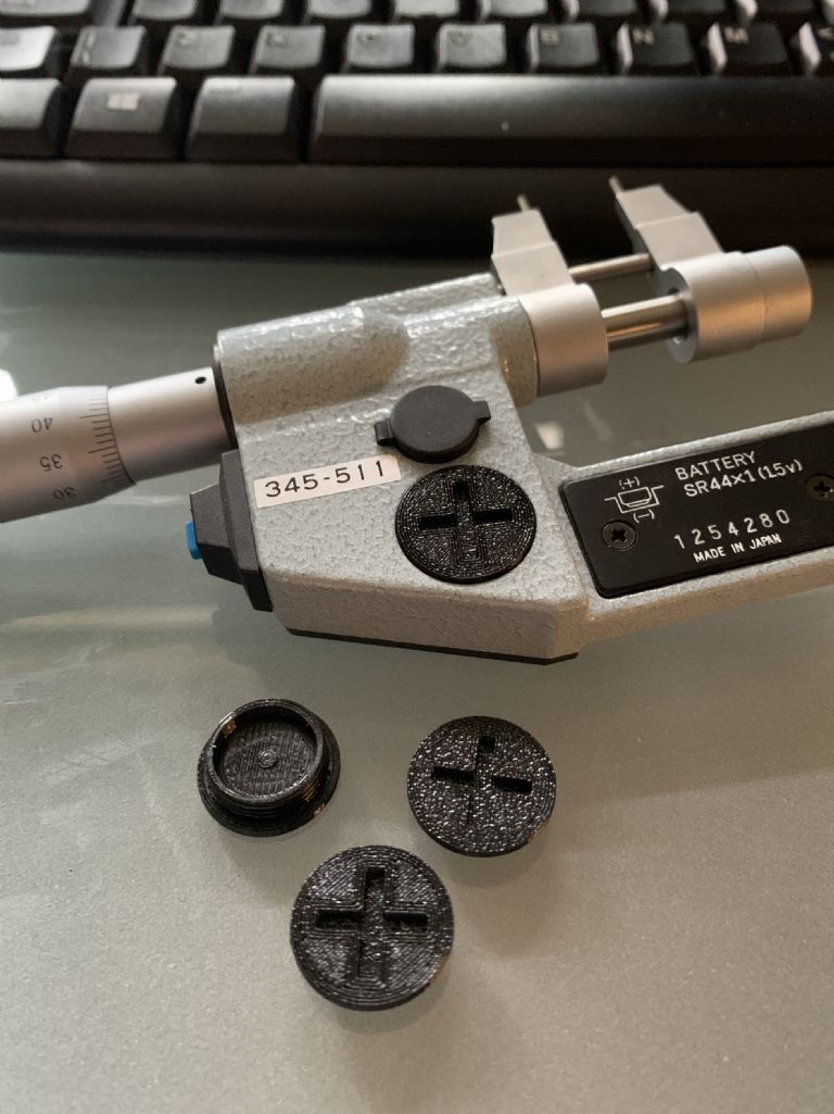

      This may be of use to others, so I’ll post it here.
      All of my electronic micrometers are second hand purchased from eBay. They’re all Mitutoyo – and they all had munged up / worn battery covers.
      Rather than purchase new spare parts from Mitutoyo, I decided to model and print some. They came out pretty great if I do say so myself, and I’ve uploaded the files to thingiverse for anyone else in the same situation to use.
      Mitutoyo micrometer battery cover
      Cheers
      Jason

          They do look great Jason and you saved yourself a pile of money. I asked Mitutoyo's local office here for a quote on some similar covers a few years ago and was told $40 CDN each!
          One thing to keep an eye on initially is that the black and grey coloured 3D print resins are sometimes conductive. This may cause dead batteries too early by draining charge away slowly to ground. If it does happen you could easily print some covers in white or clear resin as these colours are low or no conductivity in the resins I have tested.

                These parts aren’t printed using resin. It’s PETG filament, which as far as I know isn’t conductive at all… maybe some of the metal filled filaments are, but plain coloured PETG is as non conductive as any other plastic. smiley

                        Sorry Jason for the "resin" nomenclature confusion. I work a lot in industry with plastics and to many in this industry any sort of polymer material is called a resin, whatever type or form it is.
                        Your parts did look 3D printed to me, I guessed by FDM based on the surface texture. I didn't know what filament you had used.
                        I have in fact seen black coloured slightly conductive PETG filament, made with carbon pigment (usually crushed coal or charcoal).
                        I have also seen non conductive black coloured NON conductive PETG filament made with chemical dyes rather than conductive pigments. As you said, uncoloured or light coloured PETG is non conductive, at least the clear/translucent, light blue, and white PETG filaments I have seen were.

                          Someone has already uploaded one:
                          Mitutoyo calliper battery cover
                          The finish is pretty much down to the profile I’m using on my slicer (prusa slicer). It’s called “Pretty PETG v3” which has been developed by people with much more experience in 3D printing than me. You can find it in the prusa owners facebook page.
                          https://www.facebook.com/groups/prusacommunity/
                          ive also spent an inordinate amount of time tweaking the bed of my printer. The prusa mk3 has automatic mesh bed levelling which compensates for any warps or bows in the bed, to,a certain degree – but the flatter you can get it prior to it doing its levelling helps a lot. I mapped it out with a dti and got each of the nine points of contact to within a couple of hundredths of a mm to each other.
