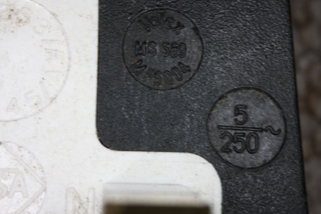

                                          Hi ChrisH, you could and still can get 13 amp plugs fitted with a 3 amp or 5 amp fuse 13A with 3A fuse 13A with 5A fuse the problem was/is not everyone stock them. As far as I'm aware, you can fit a plug yourself for your own use, but you may be restricted in a place of work.
                                          Regards Nick.

                                            I am pretty sure that if you need to cut off the factory fitted moulded plug from a domestic appliance for any reason and fit a replacement plug you can invalidate any warranty …..
                                            But I stand to be corrected
                                            Regards to all
                                            Derek
                                            #485952
                                            Nicholas Farr
                                              @nicholasfarr14254
                                              Hi Dereck Hall 1, it is quite possible that if you cut off a factory fitted plug that is the moulded on type you may well invalidate any warranty, however if you do and fit a rewireable plug, you must ensure that the fuse rating that you fit in the rewireable plug, is no higher that fitted in the original plugs rating, this will be found somewhere on the plug, normally on the pin side, as in the photo below, with the max fuse rating above a line over the voltage with a sine wave sine to the right. In the photo below, it is 5/250 i.e. 5 amps 250 volts max.
