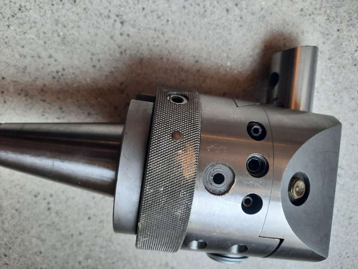

            Ill try attach some pics here now. No brand on the head itself and only a part number on the box. The head itself is quite big compared to a modern one with 18mm holes.
            Never thought to make a sleeve i suppose it would be the handiest thing to do really. Only picked it up yesterday so havent got to try much in it yet. The bars that came with it fit of cource but a 19mm drill bit i have doesnt the holes. IMG-20250104-WA0004

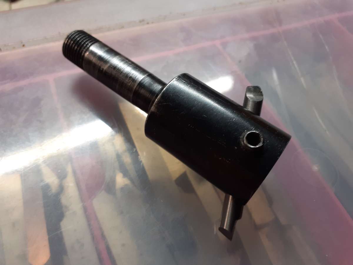

              I have Many diferent boring bars for my boring head. I have silver steel turned down to match the boring head which gives a more solid bar for large bored holes. These have holes drilled for HSS or carbide round bar with grub screws. Others have carbide tips brazed on to act like bought bars and to lengths which suit job in hand.
              Boring bars
              Fly cutter
              20201217_171709

                  Aha! That looks very much the same as mine, apparently “made in France” for Colchester [Tools ??]!
                  I will examine mine and see what that might reveal…… I’ll try for diameters and any Part or Serial numbers, on it and its rather nice wooden box.
                  I’m not sure what the arbor taper is on yours. Mine is R8, to fit my Myford mill (also the standard for Bridgeport among many others).

                          Certainly looks like a French made Gamet boring head.
                          Enco in the USA sold a lot of these in three or four sizes so it may be worth a trawl around the Americentric sites for data.
                          General opinion seems to be that these are a solid, workday, piece of kit.

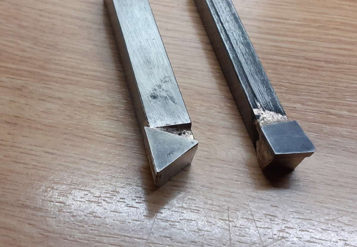

                            While I use inserts extensively for turning, for boring heads I prefer to use HSS toolbits as they can be easily adjusted for clearance, and to reduce any chatter:
                            Kuroda_Boring_Head
                            Unbalanced boring heads will not run fast enough to really benefit from using inserts.

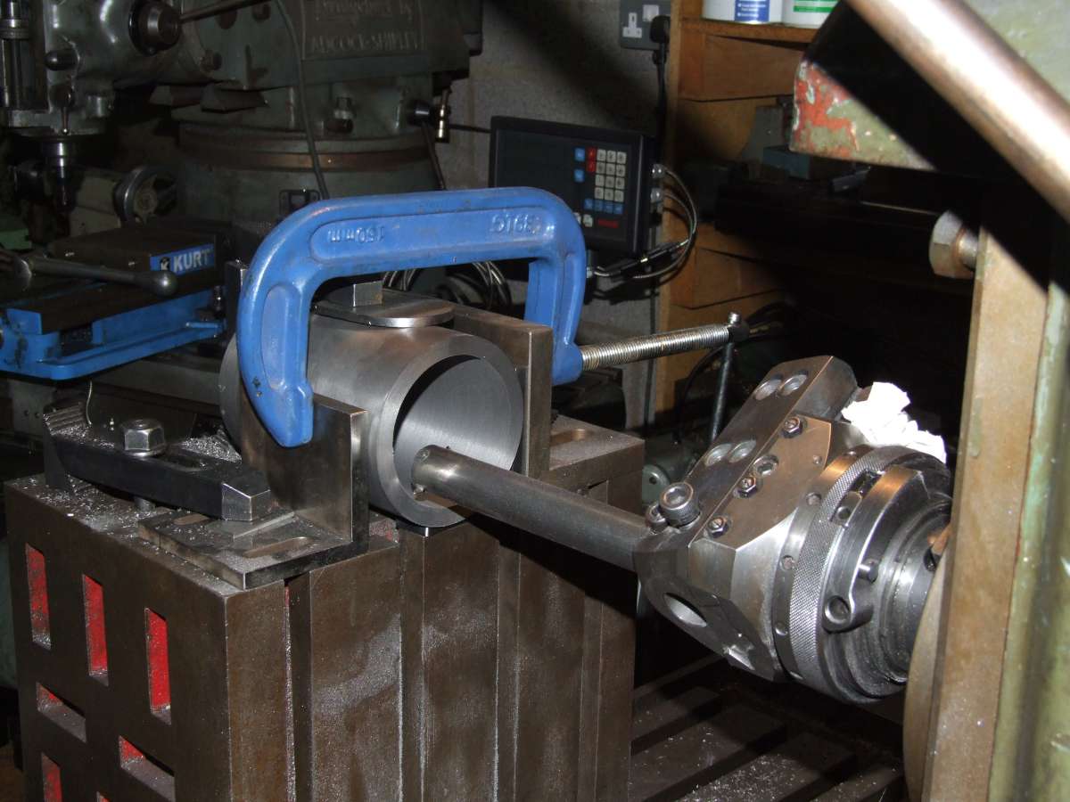

                                If your new to boring on a mill Adam maybe some of this will help. Given the rigidity of Bridgeport type mills, any boring head capable of using 3/4″ boring bars is getting up there for what’s actually usable. Unless you really are needing to bore very large and deep holes, I’d go with what others have said and use adapter sleeves to allow those smaller diameter boring bars to be used. There’s hardened and ground commercial sleeves available to do exactly that. But shop made unhardened steel sleeves would still be fine. Just make sure they have either a hole or slot in them so the boring heads set screw bears directly against the usual alignment flat the better made boring bars will already have.
                                I’d also very much agree with Julie Ann’s point about carbide and trying to spin any larger and unbalanced head at the speed where carbide provides the best surface finish. If you don’t already know and depending on your boring heads exact design. There’s numerous Youtube videos and forum posts either saying they do or trying to give user information to others that all three set screws should be used to lock the boring heads slide after an adjustment. That’s not how there designed to be used. The outer two set screws are only used to set the gib adjustment to a smooth but almost zero clearance fit. The center set screw is then used to fully lock the slide after an adjustment. You’ll also have to double check your heads dial markings. Some are set up to show the diameter change in the hole size any slide adjustment will produce, and some will show radius which will be half of what the actual hole size increase will be.
                                In my opinion a mill is seriously lacking in what it can really do without a good boring head. But there not quite as easy to reliably hit your expected dimensions as it seems. Boring is much like outside turning or boring on a lathe. Ideally you want to divide the remaining material to be taken off in at least 3 equal depths of cut while measuring the exact amount removed on the first two cuts. That allows you to compensate for any deflection in the tool or mill head. With that information, you should then be able to make the proper last adjustment with a high expectation of hitting the size you want. For anything highly precise like a slip or press fit for bearings, a lot is going to depend on what you have available to even reliably measure hole sizes. Some dedicated practice with decent telescoping gauges and a micrometer can usually get you within a couple of 10ths. Those cheaper off shore sets of telescoping gauges usually don’t work smoothly enough for those levels of accuracy without some work de-burring the internal slots and parts and checking for straightness of the telescoping parts. But to adjust the boring head to it’s final size on anything that critical, I generally don’t use the dial at all. Instead I’ll use a .0001″ or metric equivalent dial indicator or dti against the end of the boring heads slide that I’m going to be moving that slide towards. In that case the indicator will only display the amount of slide offset your adjusting to as a radius change, or half of what the finished hole size change will be. And if it were me, I’d definitely practice using your new boring head on scrap material first and trying to hit exact sizes before trying to do the same with real parts that might have a much higher value.

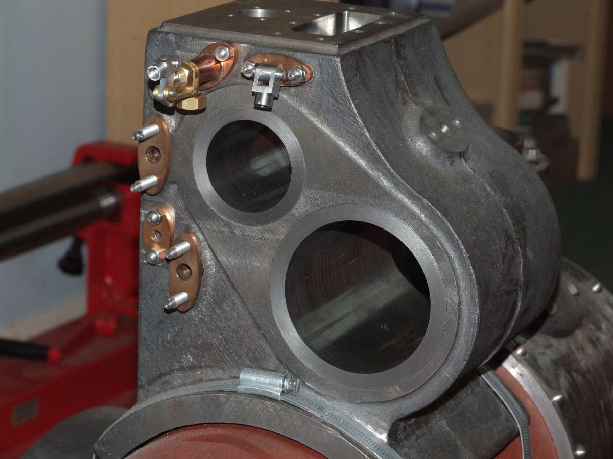

                                    The case for the prosecution:
                                    Singling Valve Outlet
                                    Dreadful chatter in the bores on my cylinder using a 25mm insert boring bar machined down to 22mm to fit the boring head. Nothing I tried in terms of feeds, speeds and different inserts made any difference to the chatter.

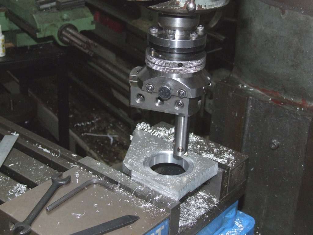

                                    The case for the defence:
                                    2021_08150010
                                    A much better finish on the liners using a similar boring setup but with a length of EN8 steel as a boring bar and a short length of round HSS for the tool.
                                    On a positive note the chatter in the cylinder bores acted as a key for the Loctite used to hold the liners in place. The liner bores measure round and parallel to within a few tenths. The setup for boring the liners used a horizontal mill as a poor girls horizontal borer:
                                    2021_07280014
                                    Grinding HSS toolbits is simple, just a few faces at angles none of which are critical. If there is an issue it’s easy to tweak the toolbit and see what happens. All my HSS turning and boring tools are ground freehand. Fancy kit to hold the toolbit at precise angles is not needed.

                                      My boring-head is in a box branded merely “EMCO”… which doesn’t help much but does look the right box for it.
                                      The head has a small circular label saying:
                                      “GMT. Made in France for Gamet Products, Colchester”.
                                      So not for the American market, at least not this specimen.
                                      As for the boring-bar holes… all 0.500″ diameter.
