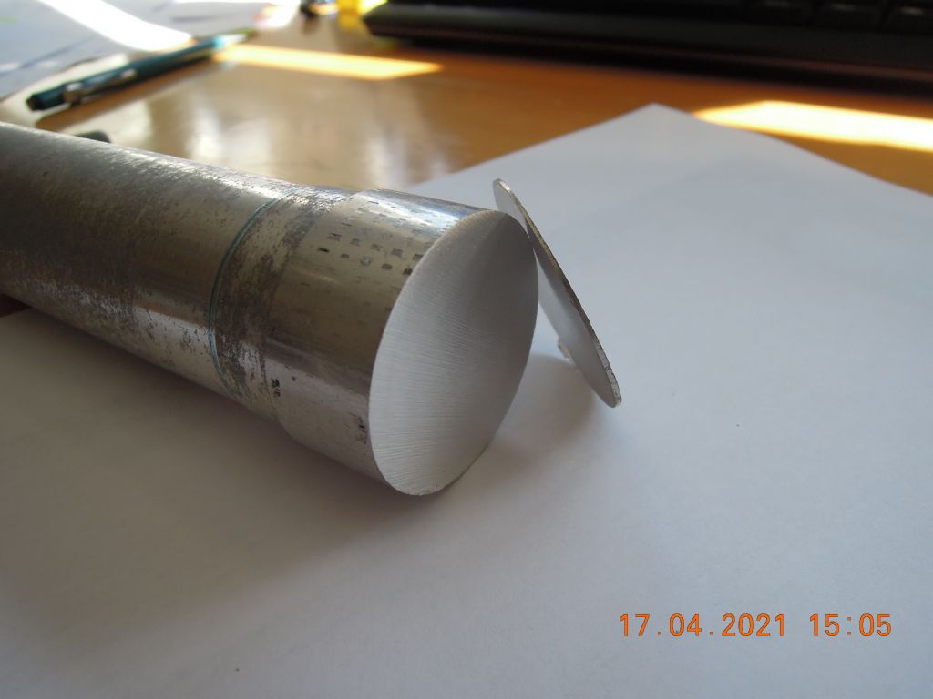

                                                    Update – I took a punt on a Femi 728xl. Excellent delivery and a sensible design. But as so often these days, a good product is let down by a few quality issues. For any one else buying one here's what I found.

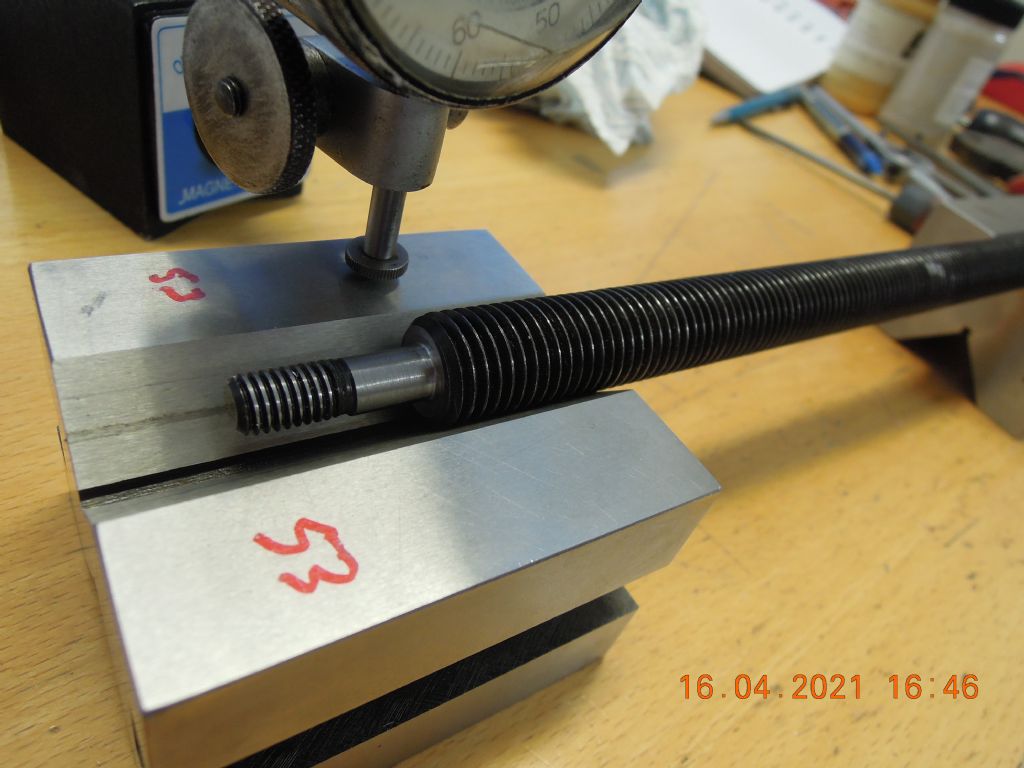

                                                    2) Vice
                                                    When I turned the handle it oscillated between tight and loose with each rotation and the moveable jaw swashed in sympathy with it. This suggested a bend in the shaft. Sure enough, when it was all in pieces this was found to be the case. However it wasn't so much the main shaft that was bent, it was the stud on the end with the M6 thread that was out of line with the main shaft. Some careful re-bending and machining sorted this.
                                                    What was somewhat surprising was that the vice unit had been carefully shimmed up with shimming washers so that is didn't distort when bolted to the non-flat frame. I wasn't expecting such refinements and all the shims fell onto the table when I unbolted the vice. I didn't take long to re-shim.

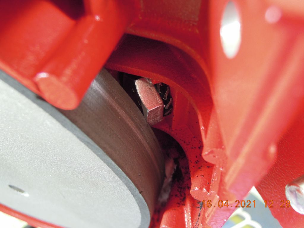

                                                    The support roller for the back edge of the blade is set in a spindle which sits in a cast 'v' groove. The groove is a little too deep which meant that if the blade is ever pushed this far back, the blade teeth will be running on the corners of the pairs of guide bearings for the side of the blade. This will destroy them quickly. I sorted this by putting thinner much thinner washers under the guide bearings to drop them down a little. Its not a perfect repair but will do for now.
                                                    General conclusion…
