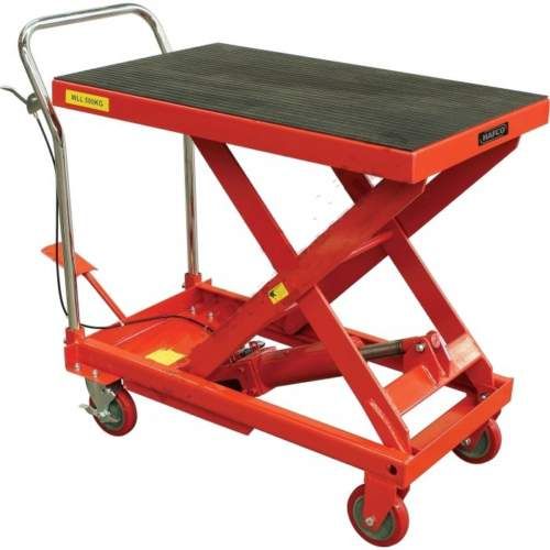

                                  Paul Lousick
                                    @paullousick59116
                                    Hopper, beat me to it. Lots of motorcycle lifts available on ebay.
                                    Paul
