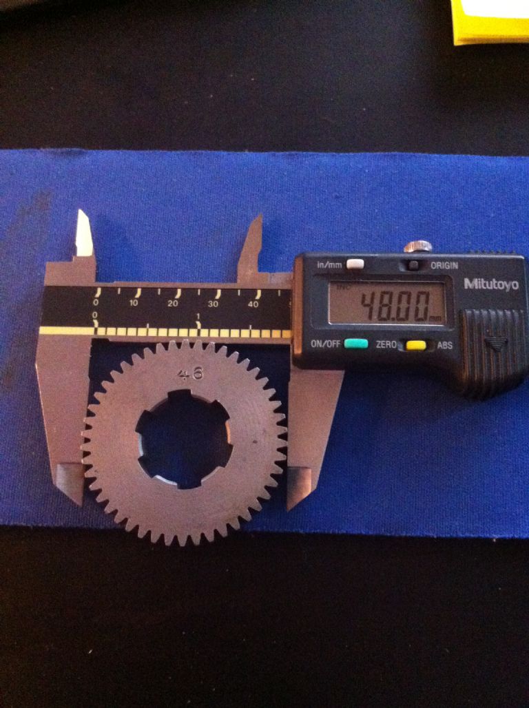

                Steve, the overall (toothtip to toothtip) diameter of a Mod 1 gear is equal in mms to the number of teeth + 2. So a 50T will be 52mm (maybe a fraction less).
                Other module sizes work in proportion, so a Mod 1.5 50T would be 52 x 1.5 = 78mm OD.

                        Hi,
                        Thanks all. Yep it seems most of the gears are very slightly under theoretical size. I don't know why but I assumed they would be DP which resulted in the approach I took to realise they wre 1 MOD.
                        I made a photo album and added a picture. One of them the 46 tooth is spot on Ø48.00mm.46tooth.change.gear.jpg
                        They are all 9mm wide. You can clearly see the spline. Is this type of spline common?

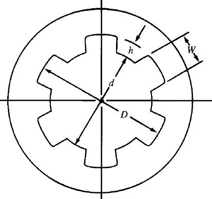

                                                    Based on this drawing of the dimensions of the spline:
                                                    I have measured the following:spline-gear-dimensions:
                                                    D== 23.10mm
                                                    d== 20.00mm
                                                    W== some range on this 5.50 through upto 5.55mm
                                                    h== hard to accurately measure
                                                    From some web research I understand that the parameter dimensions are controlled by the fit for a particular application. I also found a link detailing the relationship between the paraemters and dimension D. I have no idea if this was authoritative. Perhpas a member can educate me?
                                                    For six splines W for all fits == 0.250D
                                                    For permanent fit: h== 0.050D, d==0.900D
                                                    For slide without load fit: h== 0.075D, d==0.850D
                                                    For slide under load fit: h== 0.100D, d==0.800D
                                                    I'd be interested to learn if and what standard these gears splines are machined to. Any help appreciated.

                                                    #122487
                                                    Ian S C
                                                      @iansc
                                                      The way I'd do it; shaft dia (d) with a key way cut (W) x (h) or 1/2(W), going by the drawing of Steve's, I'd use this as an alterative if I could not cut the spline. Ian S C
