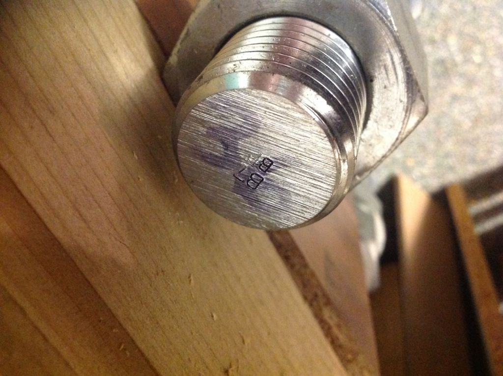

        I recently bought some M36 studding and nuts, which were advertised as "stainless steel".
        Can anyone tell me whether the coding B7 BP on the end of the bar indicates a kind of stainless steel, or at least whether this bar looks to you like stainless steel.
        Thanks for any help.

          If it really is in fact B7 it is a carbon steel, not stainless, and is a construction grade similar to AISI 4140. Not sure about what the BP is, could be a mill ID mark.
          (could mean Bloomin' Peculiar re calling this stuff stainless, maybe)
          Quick check would be to cut off a tiny piece, grind it bare, place outside on a wet day and see if it's still silver colour or if it's orangey brown in the morning. Low tech but pretty accurate.

            Use a magnet to check. Stainless in non-magnetic. (some poorer grades may be slightly attracted).

              If it is carbon steel the BP may simply stand for Bright Plated. Given that there is no evidence of corrosion on the cut end I would think this a reasonable prospect.
              I have never seen this type of coding on stainless steel. However all things are possible.
              If it is stainless steel I would expect it to be marked 304 (or A2) or 316 (or A4) which are the usual grades for threaded studding.
              Re the magnet test, 304 SS tends to become more magnetic as it is worked. That is, it leaves the mill as non-magnetic and becomes more so as it is worked into final shapes. Testing SS using a rare earth magnet yields some startling results. By way of contrast 316 does not appear similarly affected.
              Stainless steels exhibiting magnetic qualities are not necessarily poorer grades it just reflects the differences in their composition and intended use.
                    If you can afford to buy M36 then BP might be a personalisation surprise
                    Seriously though … look here for B7 : **LINK**
                    ASTM A193
                    … and also follow the link to their 'microsite'

                        Whether B7 is a stainless steel or not depends on what your definition of 'stainless' is!
                        There is no such thing as stainless steel in the sense of it being a single material. Rather, stainless steels are a large family of different alloys each formulated to resist some sort of corrosion. Loosely, 'stainless' just means a steel that doesn't rust, ie a steel that resists the corrosive action of oxygen, 'Inox' as they say in Europe.
                        But 'stainless' is much more complicated than that. For example, cutlery is made of an alloy suited to rolling knives, forks and spoons. Not only does the alloy resist oxygen, it also takes a high polish, and resists acid and biological staining. Unfortunately cutlery stainless isn't much cop for anything else because priority is given to corrosion resistance and manufacturing properties – cutlery steel is weak.
                        Other stainless steels are much stronger, tougher, harder or able to hold an edge. In the kitchen a different stainless is used to make sharp knives rather than cutlery. And the stainless used in an aircraft probably won't be the same alloy used to make chemical plant, or in food processing, in a hospital or at sea. Where it matters the designer chooses the alloy best suited to the application. They don't always get it right! At least one posh make of kitchen sink turned out to be highly vulnerable to salt, especially dish-washer salt. It doesn't obviously damage the sink, instead the salt bores tiny holes through it by reacting with one component of the alloy. Even though the stainless used is expensive, it's the wrong type of stainless to use when there's salt about.
                        For many ordinary purposes the exact grade of stainless may not matter much, except that quite a few of them work-harden ferociously and are very difficult to machine. Avoid milling, drilling, tapping sawing or turning them!
                        Looking closely at B7 it's a member of a group of strong, tough, shock resistant steels all of which apart from B7 do claim to be stainless. The alloy family is popular in the oil industry for strong nuts and bolts etc in a hostile environment, ie they are much more highly specified than 'needs to be rust-proof in a shed'. B7 is favoured for use in components exposed to 'Sour Gas', that is natural gas contaminated with Hydrogen Sulphide. This is a good thing – many stainless steel alloys that would be rust-proof in a damp shed are attacked by Hydrogen Sulphide!
                        My guess is that B7, especially if it is 'Bright Plated', is sufficiently 'stainless' for most ordinary purposes. Leave it out in the rain for a week and see what happens.

                                The chromium in the B7 is there as a strengthener but might be adding corrosion resistance as a side benefit. Mostly it is the nickel that reduces the corrosion and cutlery has high nickel and low chromium. As far as I can remember after 40 since my degree when Cr is added for more strength more Ni has to be added to keep the Cr in solution.
                                So you get to '18/8' (% of Ni and Cr) the classic autenitic stainless for bolts and stuff.
                                The non magnetic property comes from the fact that Nickel is magnetic too. However the Fe and Ni tend to align their minimagnets in opposite directions cancelling each other out. But the degree of cancellation depends on the ratio in the sample.

                                  Bill's question was 'Can anyone tell me whether the coding B7 BP on the end of the bar indicates a kind of stainless steel'. The seller's description of the steel as 'stainless' is borderline. I think B7 is a 'kind of' stainless steel and it might well be good enough for his needs, or not. Leaving it out in the rain for a few days might answer Bill's concern.
                                  What I was trying to say – and Bazyle says it better – is that B7 is a member of a group of steels that are stainless, but it's the one with the least claim to that status. Despite that, it's 'stainless' in the sense it resists Hydrogen Sulphide, and it's certainly a good steel in the sense that it's tough.
                                  My general point about 'stainless' as a description is there are many different stainless alloys that might be fit for purpose in one application and rubbish in another. It depends on what the steel is exposed too. Most hobby applications aren't demanding and many items can be made no problem with junk box metal. But sometimes you have to be more careful. Not sure what category of job Bill needs his studding for.
                                  #395301
                                    No argument against your logic, Dave … I was just highlighting that B7 is not claimed to be a Stainless Steel.
                                    … and neither is 4140/4142 when sold as a raw material : **LINK**
                                    https://www.onealsteel.com/alloy-steel-bar-hr-4140-4142.html
                                    It may however, as Bazyle deduces, stain less than many other steels.

                                      My question was prompted chiefly by a desire to know whether the seller was justified in describing the bars etc. as "stainless". It looks like the answer is "in a way".
                                      Anyway, since the bars are not intended for outdoor use (I vaguely intend to make a bookbinding press out of them, or maybe just one of them) the degree of corrosion-resistance they appear to have (they came to me as new old stock and there was no evidence of rust on them) will do me.
