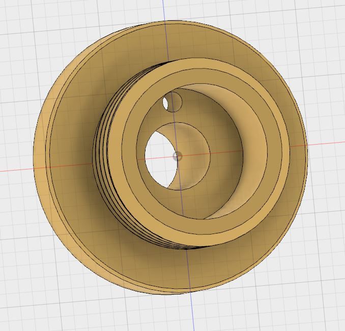

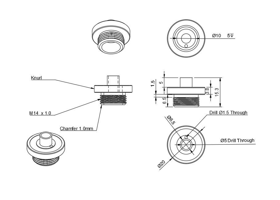

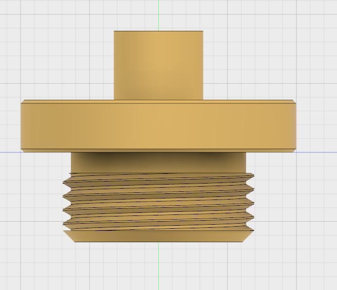

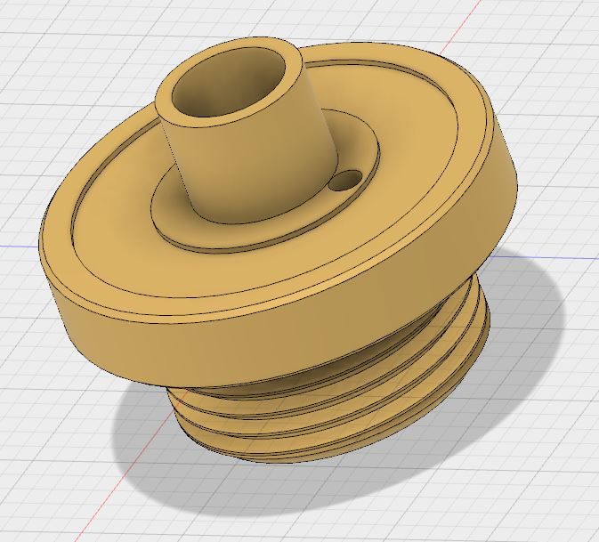

      I had trouble today making a replacement top for a spirit lamp, as per this Fusion 360 drawing and model:
      I plunged into making this and got into trouble at the end because to finish the job I had to hold the work using either the decorative knurl (not shown but on the major diameter), or the delicate thread. Despite wrapping them in electrical tape, I damaged both getting a sufficiently good grip. (Didn't help I used Aluminium rather than brass.)
      I did it in this order (troublesome steps in bold):
      1. Put 20mm rod in 3-jaw chuck with 25mm protruding
      2. Faced off rod
      3. Knurled length 20mm
      4. Reduced diameter to 14mm over 6.5mm to take thread
      5. Chamfered end of rod 1mm to for thread entry
      6. Centre drilled rod
      7. Drilled 5.4mm hole 16mm deep
      8. Widened 5.4mm hole to 10mm diameter for 6.5mm
      9. Cut 1.5mm groove to end the thread
      10. Chamfered bottom of 20mm diameter. 0.5mm (lower part of finger grip)
      11. Cut M14x1.0 thread (25.4 tpi as ersatz 26tpi), and checked fit.
      12. Part off at 16mm
      13. Reversed part in chuck and gripped it by the thread
      14. Reduced diameter at top create the wick nozzle.
      15. Chamfered top of finger grip 0.5mm
      16. Used sideways on parting tool to cut decorative groove
      17. Moved work to mill. Gripped work in vice by knurl and drilled 1.5mm breather hole.
      Now the result is 'good enough' but I had to clean up a damaged thread before it would fit the spirit lamp again. Also, in the right light, the knurl has been visibly squeezed by the vice. I'm disappointed that the part is spoilt cosmetically: it's a million miles from exhibition standard and I don't know how to avoid repeating the problem.
      The trouble started at step 13 where I gripped the finished thread in the chuck, and again at 17 where I put the knurl in the milling vice.
      Is there a smart way to plan a sequence of work to avoid mangling something done earlier?
      Also, if it's unavoidable, what's the best way to hold delicate items firmly so that they aren't damaged by later work?
      Any other comments welcome!
