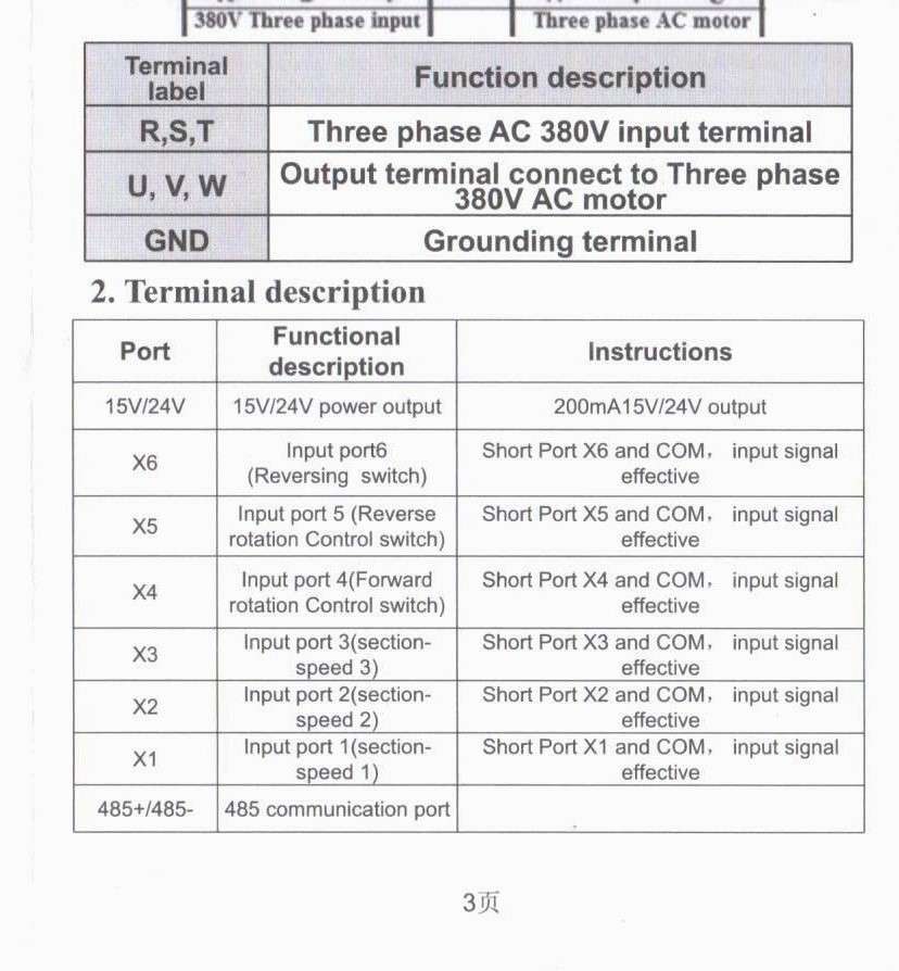

                                              I have an AT1 inverter. The manual is light on detail.
                                              I am trying to wire start and stop buttons along with an emergency stop button. The manual lists 6 input terminals (X1 to X6 & com)
                                              AT1.1
                                              Does anyone know the difference between X5 and X6, are these wired to start/stop switches, and where to wire the pot for speed control?
                                              I am thinking X4 momentary for forwards X6 for reverse but dont know if these inputs are latching, I will have to experiment with that…. unless someone knows different for this model.
                                              Speed control, There are three terminals Com, VL1 & Com, I think these may be for speed control but dont know.

                                                    You wont get any technical support from Amazon. They probably don’t even know who the manufacturer is. They should refund you if the item is ‘not fit for purpose’.
                                                    The trouble with these devices is due to missing or inappropriate documentation, you have no idea how they have been configured. In addition, some are supplied with reduced or disabled functionality which may mean you are limited as to what parameters you can change or set.
                                                    All you have to go on is sketchy functional descriptions in the digital input table. You should really check the parameters loaded in the multi function input registers to ensure they are enabling the control you wish.
                                                    Looking at the description details you have provided, I suggest (and it is only a possibility) that the MFIs are set up as follows. At best treat this information as an poorly informed guess and proceed at your own risk.
                                                    X4 – for latching switch (or rotary) which when latched starts the motor in one direction-when unlatched motor power is off
                                                    X5 – for latching switch (or rotary) which when latched starts the motor in the other direction-when unlatched motor power is off
                                                    X6 – for latching switch (or rotary) which when latched overrides the direction, ie reverses direction set by either X4 or X5 and when unlatched, reverts rotation to the previous state set by X4 or X5.
                                                    For the analogue input, there will be separate connections on the low voltage input. Connect one end of the pot to terminal  10V (or whatever the low voltage side is), the wiper to VLI and the other pot connection to COM. The circuit diagram provided in the manual will identify the connections.
                                                    Suggest you set everything up on the bench with the controls of your choice and test everything first.
                                                    EDIT and also bear in mind that low voltage rail may have a floating common and will be at mains potential or even higher with respect to the true or external ground.

                                                      I have found this Youtube video https://www.youtube.com/watch?v=XLhDivVlp2Q
                                                      And Vevor sell the same unit with a much better manual which I have downloaded.  Yipee!!
                                                      Wired the thing up this morning and have all the remote functions I need to drive the milling machine main motor.
