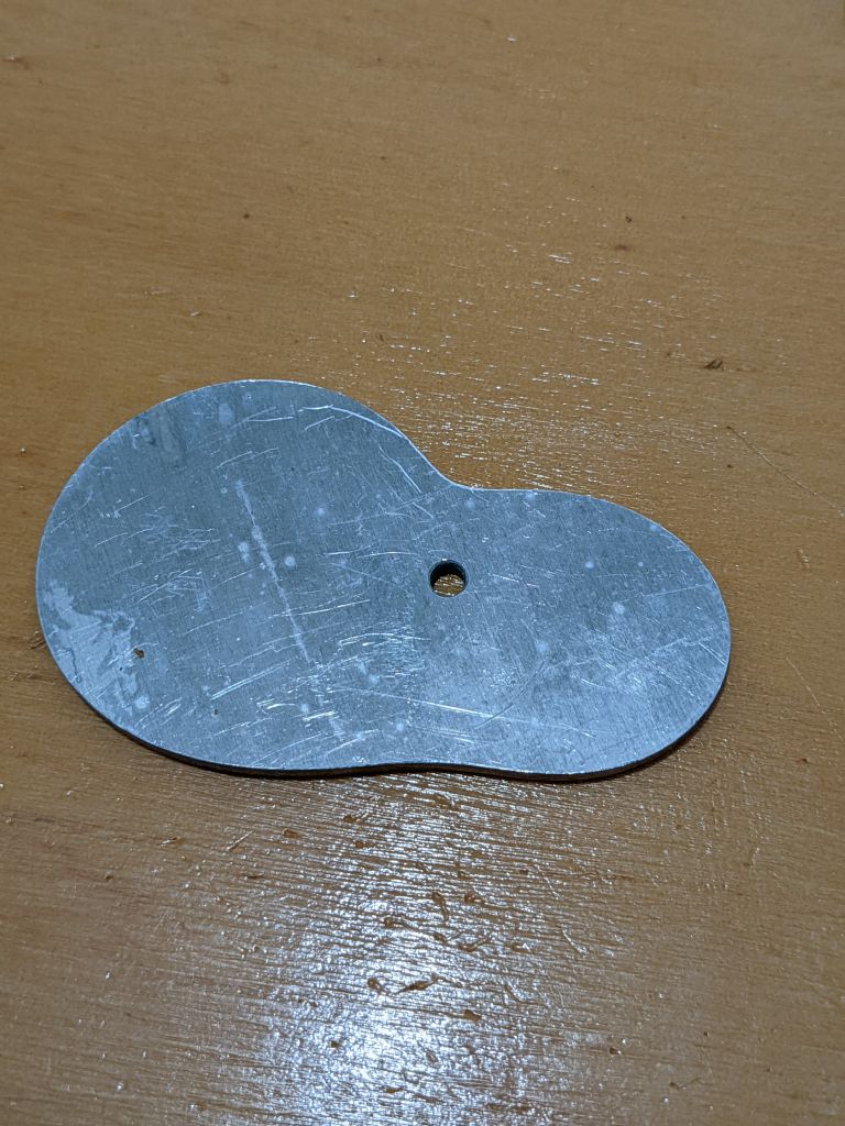

                If it is of interest I was in touch with Adrian and others about making the equation of time cam by CNC, and evolved a method to generate the g-code. Here's an example made in aluminium to test the code, to arbitrary dimensions (not his design).
                I'm happy to give more details if anyone wants.
                #588017
                Marcus Bowman
                  @marcusbowman28936
                  John,
                  That would certainly be of interest.
                  Marcus
                  #588067
                  John Haine
                    @johnhaine32865
                    Marcus, I sent you a PM.
