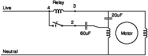

        #359924
          Wonder if the two wires previously dismissed as a thermistor are in fact the start winding, while black and yellow are connected together at one end of the run winding. It does explain Dennis' resistance readings.
          Clive's description of how the relay works is convincing but I've not come up with a circuit that uses it and two start capacitors as well. Thought I had a solution but it's wrong. Back to the drawing board…

            #359935
              This looks as if it might work (provided the 12ohm pair are a winding, not a thermistor!):
              Note there are two connections on top of the run winding that correspond to yellow and black. If my theory is right, the 15 ohm winding is start and the 12 ohm is run.
              Can a motor guru confirm this looks reasonable please.

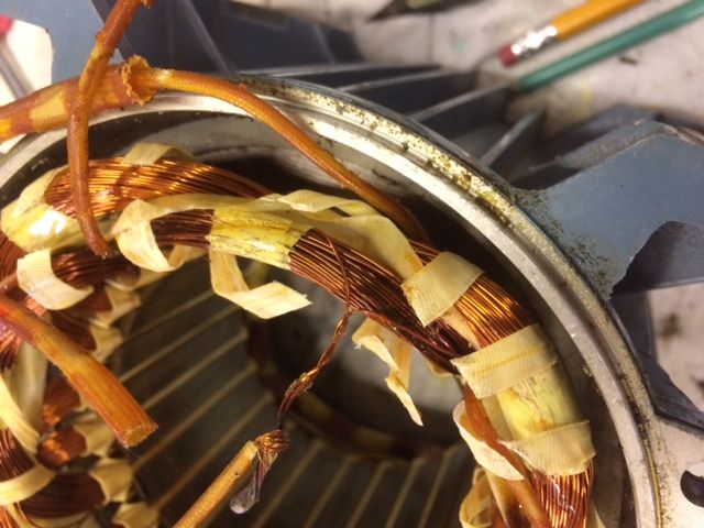

                #360575
                Dennis Mulhair
                  @dennismulhair15799
                  I opened up the motor and there are two groups of windings. Please see the enclosed photos:motor1.jpg
                  #360582
                  Dennis Mulhair
                    @dennismulhair15799
                    the connection you can see in the photo is the connection to the yellow wire from two windings. I seperated these and there was 15 ohms between one and the orange wire but a short circuit between the othere wire and the black wire, so i believe the motor is Kaput!

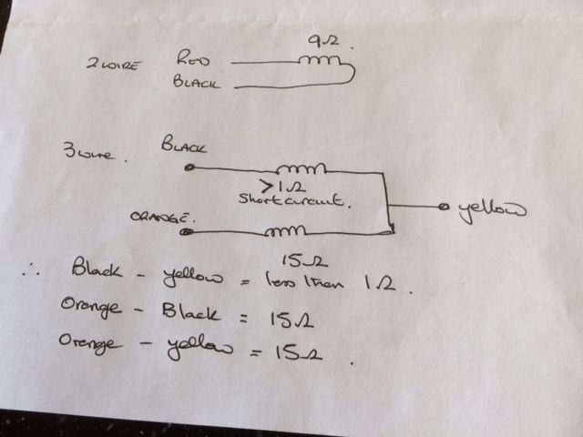

                      Dennis Mulhair
                        @dennismulhair15799
                        Enclosed are my findings. There seems to be no protection device connected to black/red. Could this be the start winding?

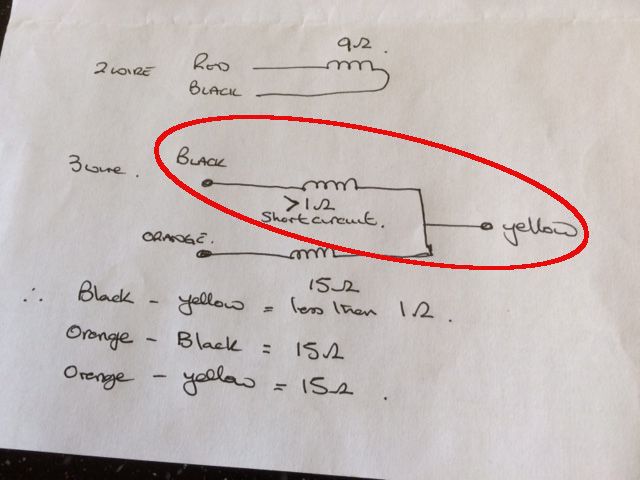

                        #360589
                          Hi Dennis,
                          I think you may be right – you have a shorted winding. But that implies the motor has a tapped coil which I don't understand.
                          As David asks can you show where the Black wires go. David: this diagram is lifted from Dennis' album. I've circled the peculiar measurement. I was hoping Dennis would find Black and Yellow connected together, and they're not.
                          I feared the motor might be faulty when Dennis posted the original photo. Someone went to the trouble of disconnecting the relay and capacitors, and that could be explained by fault finding in the past.
                          My understanding of single phase motors doesn't cover split start windings, so the whole Yellow/Black/Orange thing has me stumped, if that's what they are.
