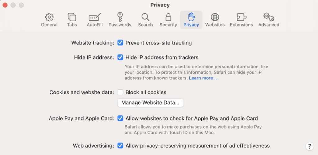

      • In two cases, they have updated/have the latest version of Safari 15.3, in which the security settings are automatically set as below.
      • Depending on where a customer is based in the U.K., it seems that Apple – Safari 15.3 may use ‘their own VPN’ in remote areas of U.K. to route the link. The result is wrong carriage being shown to the customer if the Apple VPN is routing via a foreign country. ‘un-ticking’ the ‘Hide IP address from trackers seems to cure the problem.

      So if you are an Apple Mac user, and if you are willing to assist, could I please request you to see if you are able to visit our site on your old or new version of Safari to see if you come across any of the above issues?, and if so, does clearing the HISTORY, or unticking the said box temporarily (if you are willing to do so) on the latest version of Safari cure the problem, or using Google or Firefox cures the problem?. If not, please details version of Safari being used, with box ticked/unticked.

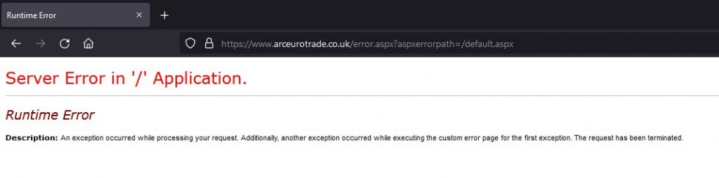

      Plusnet users – Two customers who use Plusnet were simply unable to get onto our site. Trying to get on resulted in an application runtime error:
      I am unsure if this is due to Plusnet blocking our site for some reason or something else.
      So if you are a Plusnet user, and if you are willing to assist, could I please request you to see if you are able to visit our site? If not, could you please advise if you are a Windows or Apple user, along with details of which browser you are using. If you do have a problem, please see if removing cookie history cures the problem too… in most cases it cures the problem, but if you still have an issue, and if you are using Plusnet, it would be good to know.

            Posted by Ketan Swali on 05/03/2022 21:11:41:
            Ketan,
            This isn't a network problem – this is a problem with the computer the website itself runs on. Often such problems are temporary and go away without intervention, hence why only a couple of customers saw it. You might want to check with your hosting company.

              Ketan, I'm on Plusnet & W10. All OK on Opera, Firefox, Avast, Chrome, Edge & Pale Moon browsers.
              I'm also using a BT home hub, which has a fixed DNS of;
              Primary DNS:213.120.234.42
              Secondary DNS:213.120.234.38
              I think Plusnet's default DNS server address may be different.
              I've had issues in the past, where, following a website's udpate, there was one or more DNS servers which failed to resolve the address, until at some point they were later updated..
              This meant that some people on a particular ISP could access a website, but others could not without changing their default DNS server address.
              Bill

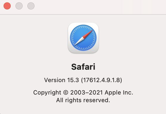

                    Hi Ketan, Early 2013 MacBook pro and Safari Version 15.3 (17612.4.9.1.8) all seems Ok ran though an oder right up to payment charged delivery address etc — all worked as it should as far as I can see — cleared the order at the end.
                    Regards John
                    Edit use BT internet at the moment
                    Edited By JohnF on 06/03/2022 23:16:37
