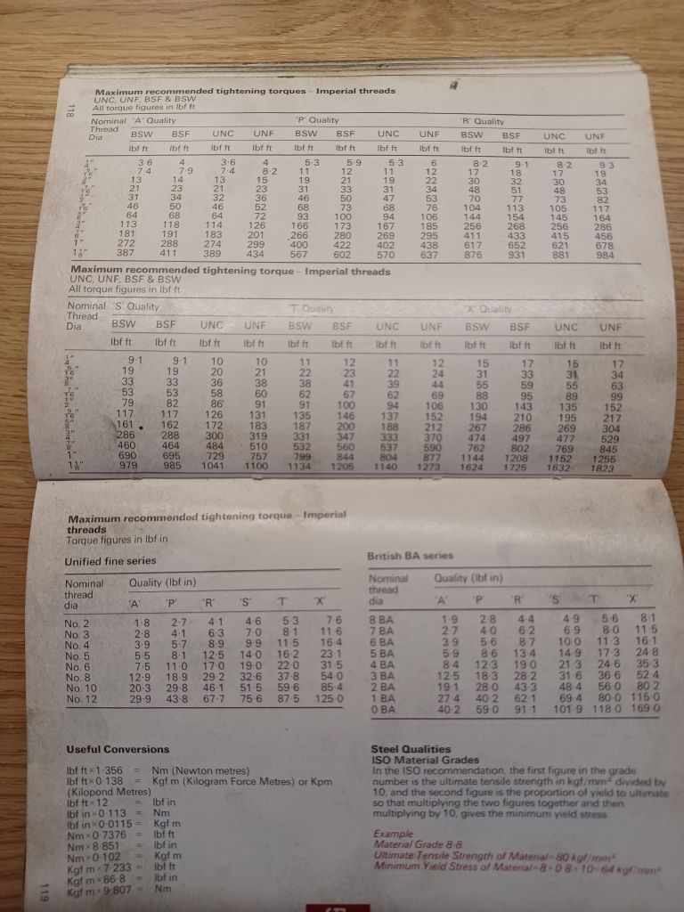

              Further to Howards last comment I put 5/16 UNF into the bolt stress calculator spreadsheet from Security Locknut at the link given in my earlier post.
              For a 2" long grade 8 bolt it reckons 27 flt lb on a dry joint, 20 ft lb lubricated, is enough to reach maximum safe stress on the bolt of 120,000 psi. Takes 52 degrees rotation angle from full contact, finger tight I guess, to full torque.
              Bolt stretches by 6 thou.
              Gives a clamp load of 5,200 lb per square inch. Equivalent to about 2 tons on my thumb nail. Ouch.
              Bit more playing around suggests that tightening to nominal torque / maximum safe stretch is 25° per inch from finger tight.
              Frankly its all a bit scary how easy it is to generate, ahem, very large stresses in a bolt with correspondingly high clamp loads.

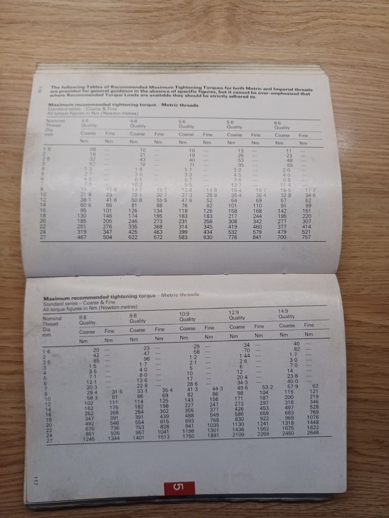

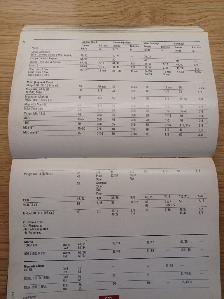

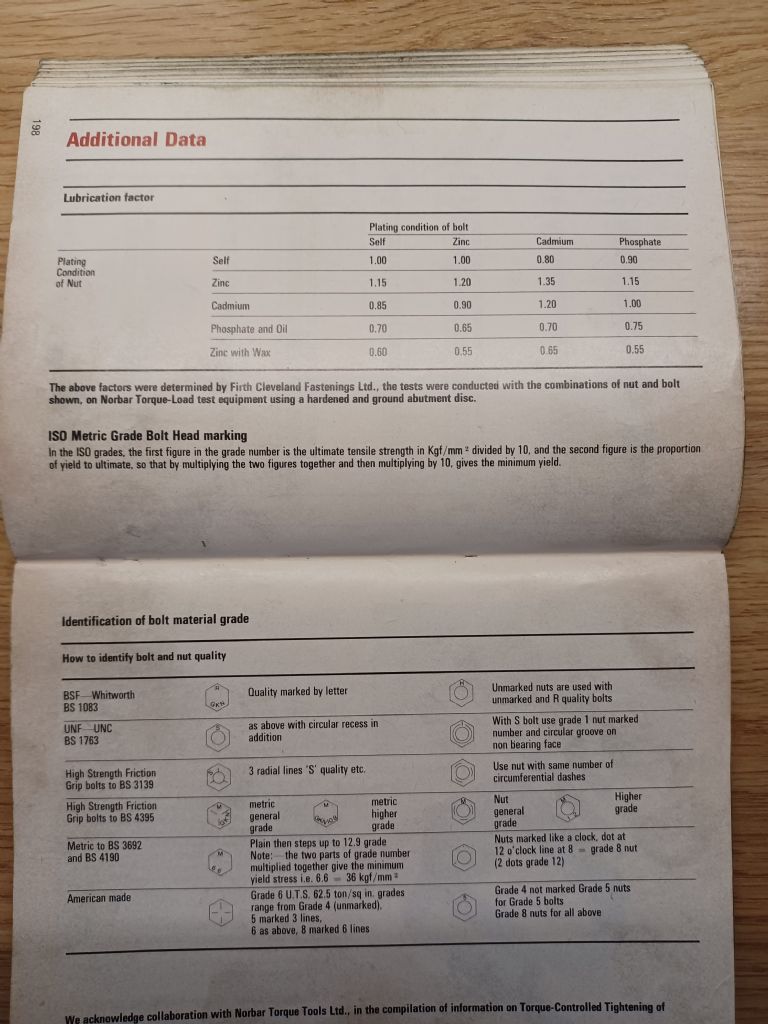

                                I have a little useful book.
                                It has torque settings of many older vehicles cast and vans as the book is a little out of date but some very useful information.
                                David
                                Edited By David George 1 on 26/11/2022 15:29:51

                                                  Yield tightening is when a fastener is tighten to just beyond the elastic limit,(begins to yield ) and takes a permanent extension. It is the most efficient use of the material.
                                                  The 32 spindle Unbrako machine that we used monitored torque and rotation, so that once the rate of torque increase vs angular rotation decreased, (i.e.no longer linear, the machine stopped ) from the intensive work that we had done, on every spindle, we knew that each bolt had increased in length by about 0.002"
                                                  This meant that each fastener now had a tensile load applied of 9 tons.
                                                  If you overtighten a fastener, you feel that the rotation is taking place, but then resistance (torque ) is no longer increasing at the same rate. You have loaded it beyond the elastic limit and put it into yield.
                                                  If you persist, it will fail. (As a youngster, I failed several 1/4 BSW bolts in this way.)
                                                  Monitoring the stretch in a fastener, as long as the material characteristics are known, provides an indication of the tensile load within that fastener.
                                                  The clamp load is determined by the coefficient of friction between the two members of the fastening (Delendent on the materials and the surface finish, and the depth of then thread)
                                                  A 1/2 x 40 ,tpi thread in brass will fail at a lower torque than a 1/2 UNF (20 tpi ) in even mild steel.
