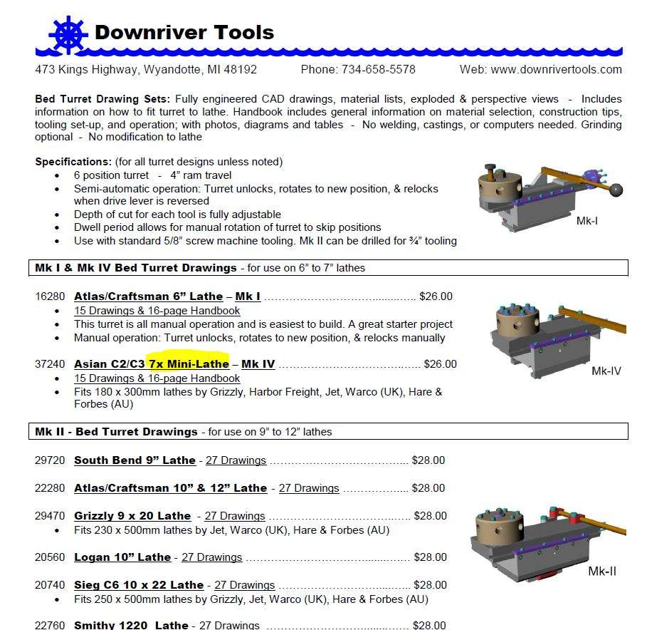

      For a fun if mostly useless tool project I was thinking of making up a turret for the classic 7×14 minlathe.
      Rigid, slides on the bed, auto advancing type rather than the popular tailstock mounted flying saucer.
      Before going off to reinvent the wheel could anyone point me in the direction of any pre exsiting plans? The ratchet style advancing mechanism in particular sounds fiddly and would burn through a few prototypes on the 3d printer before working I think
      Downriver Tool used to sell some for various lathes but unfortunately the site is down and having tried to contact the owner I think he might be gone for good.

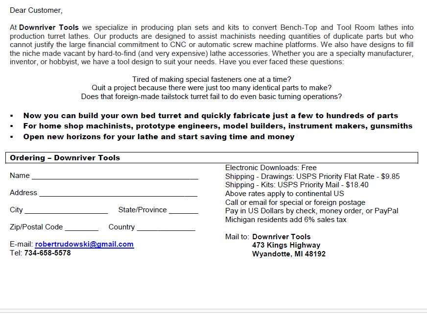

          Downriver tools just hosted the capstan stuffand they have shut down, try the contact details below for Robert.
          downriver 2
          downriver

              #777789
                This is the Downrivers tools one for the little Sheline in action
