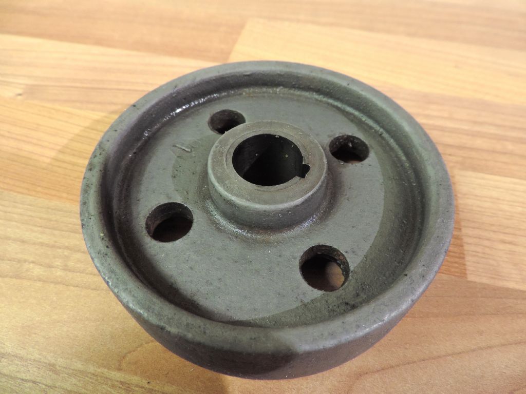

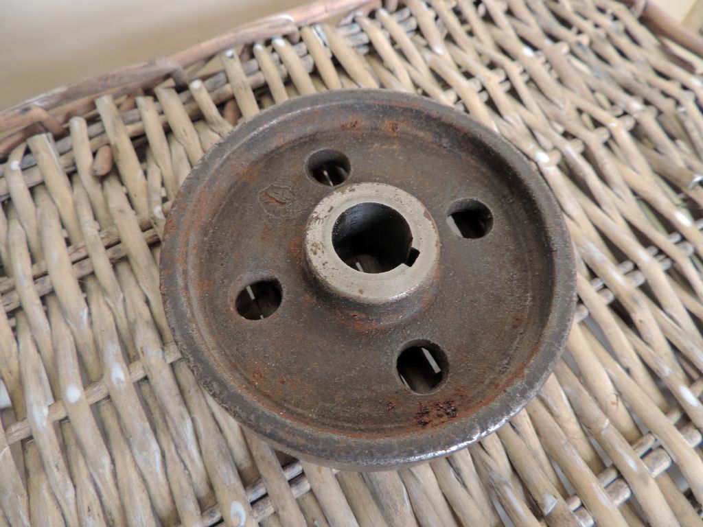

            Derusted an old iron wheel I used as a pulley for my Suffolk engine with the last of the Evaporust. It wasn't too rusty, to be honest, but I think it just about exhausted the solution.
            Left it very dirty – I suppose the rust dissolved leaving graphite dust behind, it just wiped off. Nice grey finish, like a new casting!
