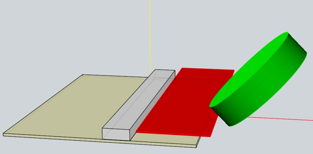

        Hello
        I need to make about 32 identical, small pieces of rectangular mild steel plate with dimensions: c.16 x 13 x 1mm.
        The tricky bit is that I need to put a chamfer on one edge of the steel that is EXACTLY 45°.
        Background
        It is just for a novel product idea that I am working on.
        I am thinking that in principle I just just cut a long strip of steel that is 13.1mm wide, and put a 45° chamfer on it and then cut it up into 16mm lengths.
        My first problem would be cutting a long strip of steel by hand (using a hacksaw) reasonably accurately, before I file it flat.
        But even more difficult would be putting an ACCURATE 45° chamfer onto one edge. With enough time and very careful filing and sanding I suppose this is would be possible, but not easy!

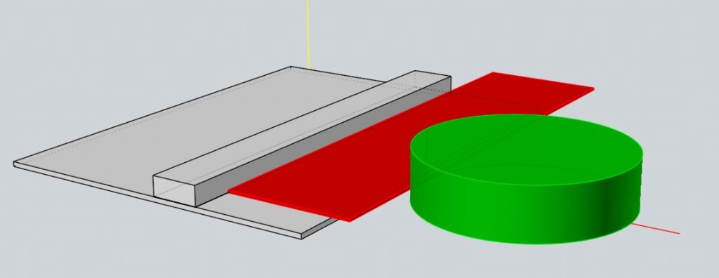

                Put a grinding wheel in the proxxon drill. Set the (a) fence at 90 degrees to where you have it now and the correct distance from the wheel.
                With the grinding wheel flat you could do the back edge, Tilt the wheel to 45 degrees reset the distance to the fence and grind the chamfer. You should have enough power for 1mm steel sheet.

                  Peter Cook 6 – I quite like your thinking but
                  1) My Proxxon Micromot drill can handle up to 3.2mm shafts. The problem is that I can't find a decent grinding wheel that will fit it!
                  2) I can't quite work out how to attach the guiding blocks that you have drawn onto the base of the stand.

                                                  In answer to Q1 I was thinking of the small 20mm diameter grinding wheels that fit on a mandrel and are used in Dremmel tools. At the cheap end 8 wheels plus a suitable 3.17mm mandrel cost £3.45 from a well known auction site. Better ones are no doubt available elsewhere.
                                                  For Q2, for the volume you are planning to make I was thinking of making the table from a small piece of Plywood, MDF or other suitable smooth material that was big enough to cover the base of the proxxon. Glue or screw a strip of thin timber or plastic (say 10mm wide & 5mm thick) to that base. Then place it on the proxxon base and clamp it down (depends on what clamping arrangement the Proxxon has) at the correct distance from the grinding wheel.

                                                    Cutting by hand is MOST unlikely to result an edge at "exactly 45 degrees"My suggestion would be to cut /file the strip to width (making the minimum allowance for the 45 degree chamfer, ) with the ends square to the straight face.
                                                    The illustration of the machine ( 23/3/2021 12:36 ) shows a T slot along one side of the Table. That is the ideal means of clamping a fence in position.. The fence may need to be wide enough for the workpiece to overhang the edge so that the grinding wheel can pass below the level of the top of the Table.
                                                    The fence can also be used as the basis for the clamps used to hold the workpiece…
                                                    Running a small grinding wheel along the outer edge, with the "pistol drill" set over at 45 degrees would seem to be the method.
                                                    This would allow a long strip to be ground, so that it could then be sheared to provide several lengths, with the required chamfer.. The long strip can then be sheared to produce the lengths required.
                                                    Shearing across the sheet may well produce a burr which will need tom be removed by gentle use of a swiss file or a diamond file.
                                                    The grinding wheel will wear, so the vertical position of the "pistol drill" will need to be slightly (The wheel will only be operating over metal of just less than 1.5 mm width&nbsp adjusted regularly to present an unworn part of the wheel to the workpiece. Hopefully, one grinding wheel may last long enough to do all 32. If unsure, lay in a store of wheels.
