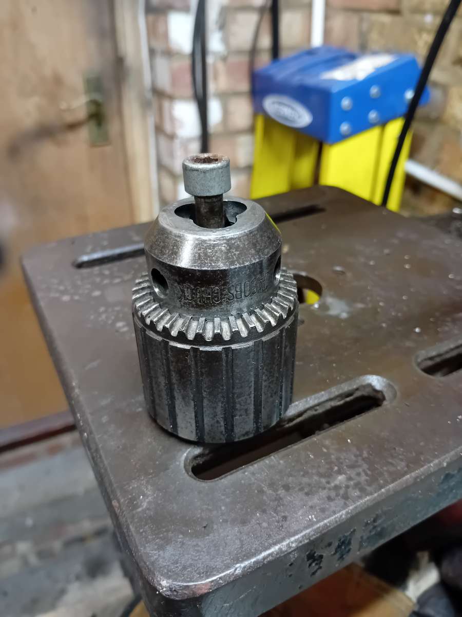

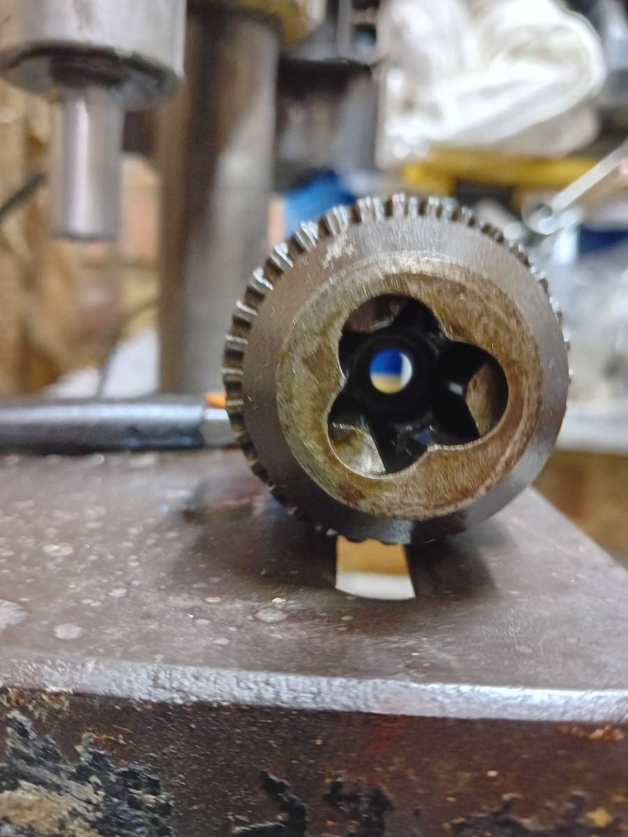

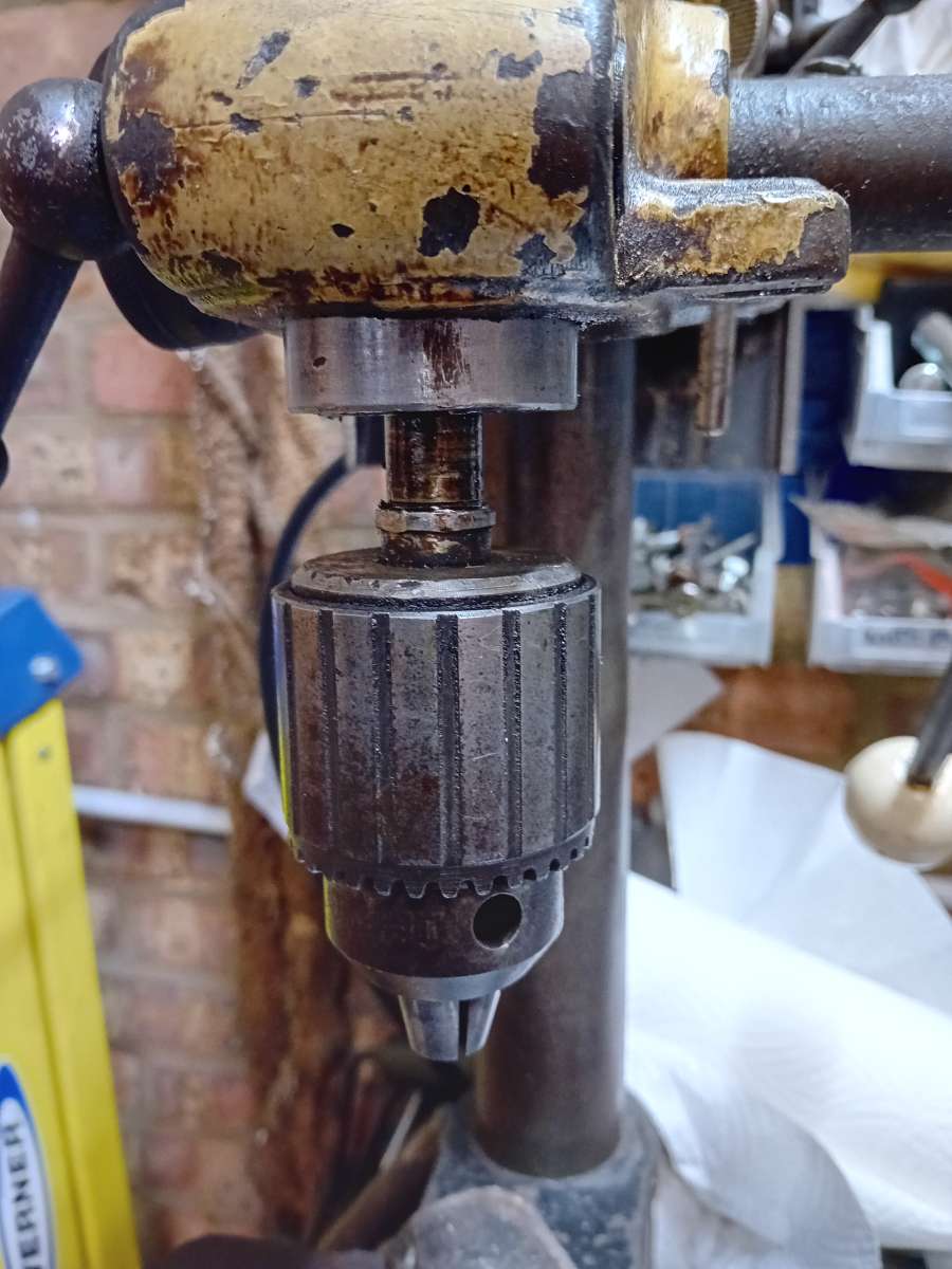

      Dear all,
      I have no idea how to remove the chuck from my recently acquired Fobco Star 9see pics below).
      I have seen an old post in this parish where there was a knurled ring that unscrewed and pushed the chuck off. My drill does not seem to have this. Any ideas?
      Many thanks in advance,
      Dominic.

        Extend the quill and see if there is a slot in it – if so then it will be 2MT and need a tapered drift to push the 2MT shank out of the quill shaft. If not then a Jacobs Taper in the chuck, the chuck may have this fact marked on it. Gentle heating and a forked drift should get it off, patience is needed. Good Luck. Noel.

          There isn’t a slot, even with the quill extended, so I suppose it’s a case of getting a good forked wedge and tapping with some heat.
          I can’t see any markings on the chuck to describe the taper. It says it’s British made, in Sheffield, shows the capacity and says it’s a Jacobs number 34.

            Dominic, whilst I would expect it to be a JT I have seen ones with an internal thread, I bought one in the early 70s to fit a Myford, but it told me the thread – you say yours has no info. Noel.

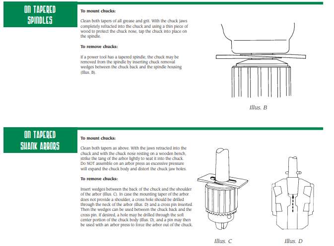

              As far as I can see, all Jacobs 34 are all tapered fit, in the current range anyway.
              http://www.jacobschuck.com/plain-bearing-keyed/17.html
              Really, I believe you should uses opposed tapered wedges, specifically for the purpose, rather than just hitting on one side with the likes of a ball joint splitter.
              http://www.jacobschuck.com/uploads/ueditor/file/20200604/1591240204146153.pdf

                No. 34 indicates a chuck with a J6 taper IIRC. If it were screwed it would be 34B.
                A long time ago I removed my taper mount Fobco chuck very quickly by trying to use the machine as a vertical mill!

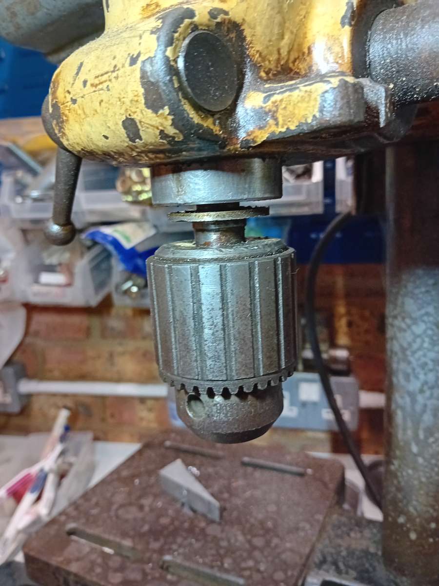

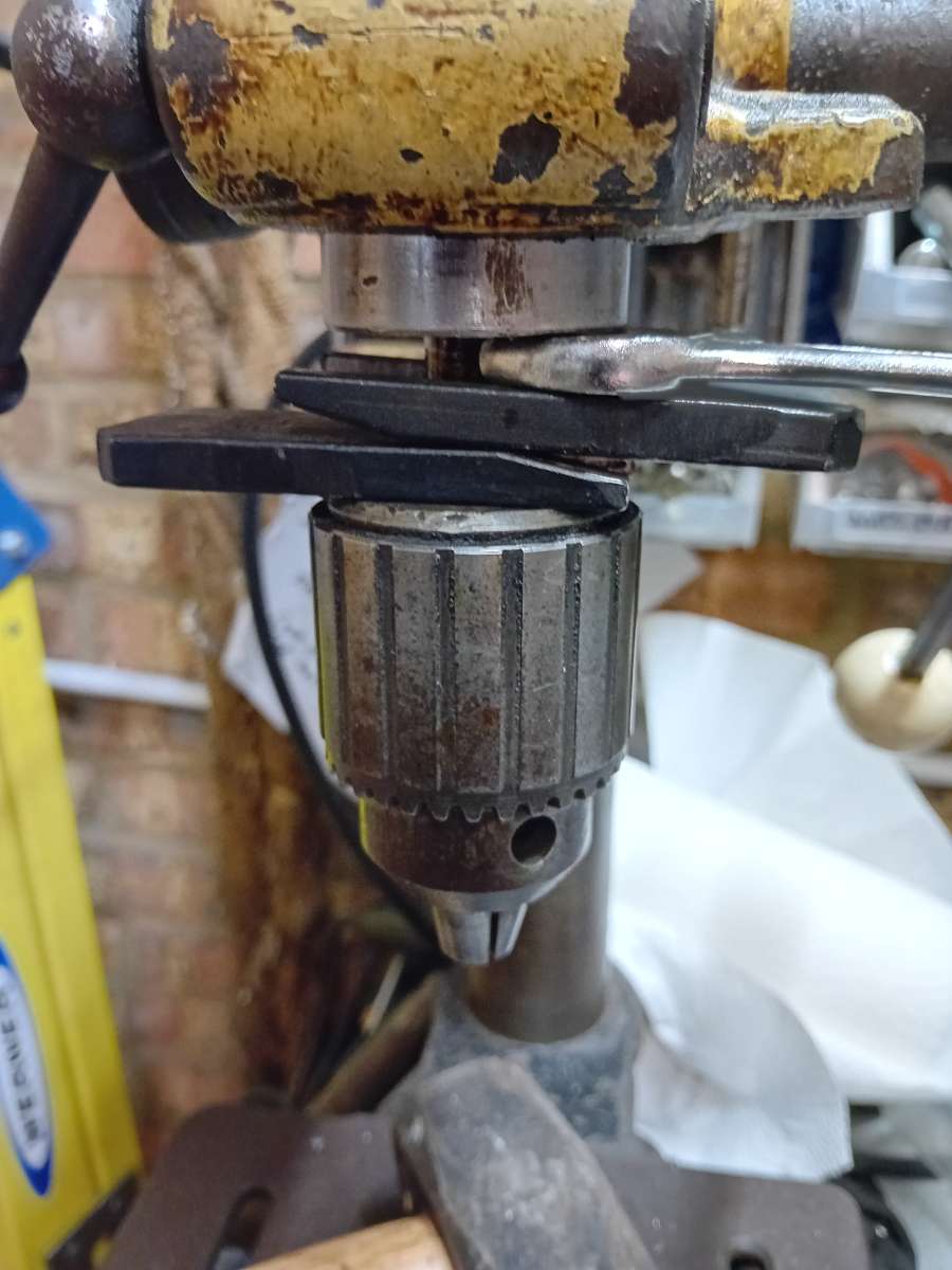

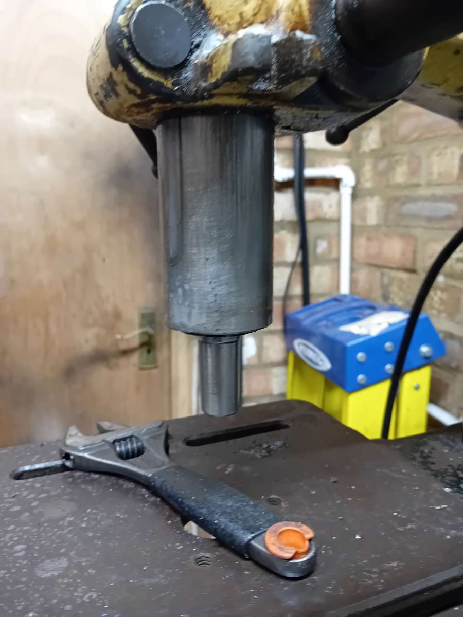

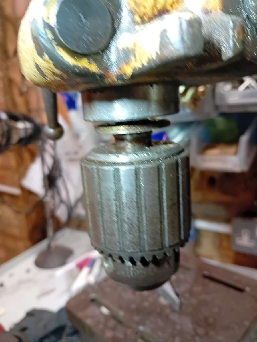

                    I thought I’d update on my progress. I bought some wedges, but using these just seemed to pull the spindle further downwards in the quill. I eventually realised that you are supposed to use the wedges against the slightly wider diameter ring just above the Jacobs taper on the end of the spindle, not against the body of the drill as I was. (see pictures below). In the end, I removed the body of the drill off the pillar, turned it upside down and drilled and tapped an M8 thread in the back of the chuck body, which allowed me to easily remove the chuck. Now I can take the chuck off easily whenever I like. Unfortunately, after a clean and rebuild the chuck is still not holding drills true (one of the jaws looks to be worn on the side it grips the drill. i wonder if filing the other two down to suit would improve this?
                    EDIT: I noticed that when the spindle had been pulled down further by the action of the wedges, this introduced some play into the spindle (disaster!). However, the spindle was easily moved back up by exerting some downwards pressure on the re-installed chuck against the table.
                    An better way of drilling the hole would have been to mount the drill bit in a machine vice rather than taking the body off and using a hand drill. The machine vice is in the post!
