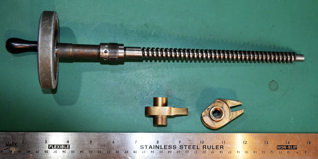

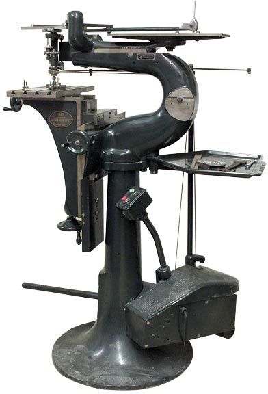

      I am in the process of restoring a Taylor-Hobson CXL Engraver from 1955, like this one:

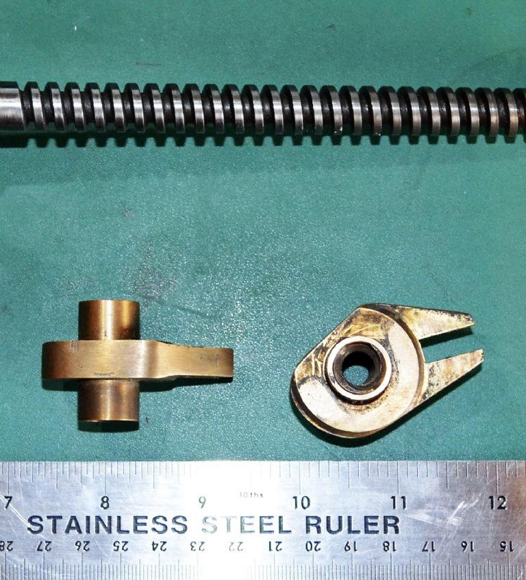

      The leadscrew nuts (there are obviously 3 of them) are worn. On inspection the leadscrews themselves look to be in great condition.
      My question is how do I go about cutting an internal thread on replacement brass nuts? The thread looks to me to be a single start 1/2" x 5tpi Acme.

          An ACME thread that small would normally be tapped rather than screwcut due to the limited space inside for the tool and carrier bar. If I had to do it I'd be getting creative using a live bar supported by the tailstock with the nut blank mounted up on the cross slide. Minimise the active length of the length of the small diameter portion of the bar which actually carries the tool and passes through the job. Use a support / driver bush in the headstock drilled to take the extra length of the smaller diameter with a lock screw to hold it on a flat for drive. Larger diameter going back to the tailstock. Need to ensure that the bar always resets to the same depth in the driver. Obviously the Acme tool is made thin so final cut to size is by moving saddle a fraction.
          Monumental faff! ACME taps are expensive though so probably not worth it for one time use.
          The delrin replication technique is worth looking into as loads are light and the screw good.
          Clive.

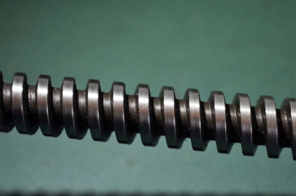

                          Are you sure the original isnt square threads?
                          #249246
                          Nishka
                            @nishka
                            I'm pretty sure it is Acme and not square, what do others think?
                            If it is Acme then it is not a 'standard' thread, being 1/2"-5tpi.

                                Thanks for the link, those are the parts I need but as you say a tad expensive. They may be my last resort though. I can get an awful lot of brass for £200 and spend some time cutting them on my Myford.
                                If I go this route what is the best method of cutting a 5tpi internal thread and should the nut be brass or bronze? It looks like brass on the originals, at least to my very untrained eye!
                                #249257
                                Nishka
                                  @nishka
                                  An alternative would be to fabricate both the leadscrews and the nuts and changethe pitch to 1/2-10tpi. If I also fitted a graduated handwheel I could have measurable movement!

                                          Posted by Nishka on 03/08/2016 16:12:10:
                                          Edited By Nishka on 03/08/2016 16:12:43
                                          It looks much more like a square thread to me !
                                          Which, if I recall correctly, is standard for Taylor Hobson.

                                              Thats what i thought about the square thread, very difficult to tell from photos due to the turns giving the illusion of a slope to the threads .
                                              #249281
                                                Posted by mark smith 20 on 03/08/2016 18:20:52:
                                                A quick impression, in plaster, wax or plasticine, would soon confirm.

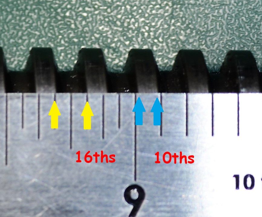

                                                      Thaks for all the answers and suggestions guys, a lot to think about. As to the thread being Acme or square – my understanding is (and I amy well be completely wrong on this) that in a square thread the Root and Crest widths would be equal at 1/2 the pitch. Given that the pitch is 0.20" then this figure would be 0.10".
                                                      On the other hand, an Acme threads Root and Crest is equal to 0.3707 x pitch, giving a Crest width of 0.0754" and a distance between crests of 0.1246".
                                                      I realise that the method od measurement shown below is far from ideal or accurate but I believe to shows enough information to determin that the thread is an Acme one.
                                                      The distance betwiin the two yellow arrows is close to 1/8" and the distance between the two blue arrows is significantly less than 1/10". To me this looks like being closer to 0.1246" and 0.0754" than to equal distances of 0.10".
