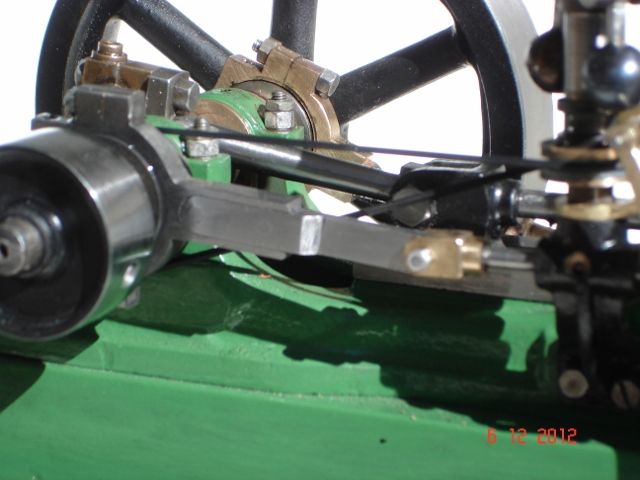

        I'll soon be ready to machine a pair of eccentrics for my ongoing build. The two gunmetal castings are missing from the set of second hand castings I bought. I could order a pair from Reeves or alternatively machine the eccentrics (which wrap around a 1" dia. sheave) from some 1/4" thick brass plate I just happen to have.
        I am reasonably certain that the brass should be OK but what will the judges think?
        Rik

                I've used brass on several of the small 24mm bore engines that I have made running on steel eccentrics and they are fine for the light use I give them
                #395936
                Ian S C
                  @iansc
                  When I rebuilt a rather battered Stuart Turner S9 I made the new eccentric strap from cast iron.
                  Ian S C

                    Last little mill engine I built used brass for the eccentric strap, on a steel eccentric. No problems.

                        Brass it is then chaps. I like the idea of cast iron and steel but I'll go with brass on the basis that it is one thing less to rust on the engine. Thanks for your comments.
