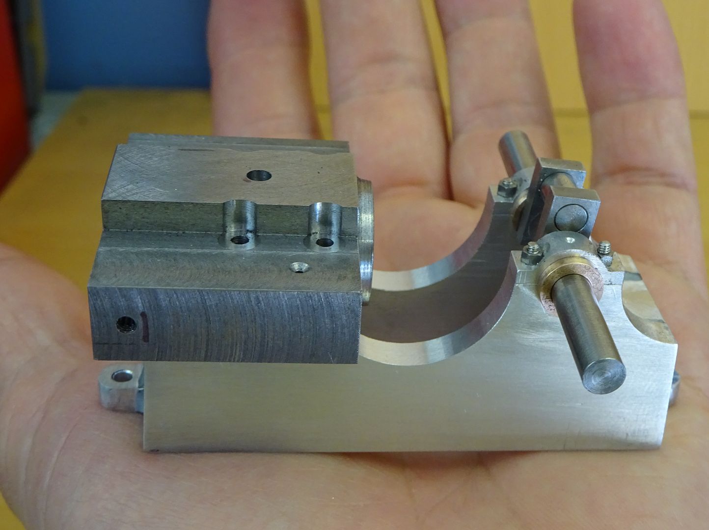

            They are very nicely made and if anything a little tall on certain sizes. I was using some M1.6 ones today which look good having a 2.5mm A/F Also got a nice little nut driver from GHW for them wich is 3.5mm OD so fits into tight spaces, Just what I needed for the Jowitt Jnr's bearing caps.
            I would be interested to know how the metric AF sizes were worked out as there seems no logic to it. Most threads have the hex at so many times D but metric seem to vary. M6 with 13mm hex is 2.17xD but something like M10 at 17mm hex only 1.7D?

              Machinery's Handbook says that a M6 nut is 10mm AF max, which is what my commercial nuts measure? Sure you're not one line out; M8 is 13mm AF.
                    Andrew
                    Interesting page here might help explain some of the discrepancies.

                        Thanks Andrew, got my M8 and M6 mixed up.
                        Peter, if you use one of the online translators there is a lot more size info on the GHW site than Polly's, works out a bit cheaper too.
