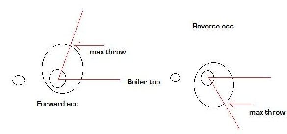

                          When I came to W.J. Hughes page 195 this was going to be so easy. But having made up a nice metal template to the 821/2 deg. Not being at all familiar with this subject I was then at a loss as to wether to line this up to the centre line on the centre eccentric pieces or to the forward shells having removed the rears to expose the adjusting srews.
                          I assumed that the template was to be placed on the boiler top but there was no mention as to wether it should be placed forward or to the rear of the crank shaft.

                          #81166
                            If you look at the “arrangement of valve gear” top right of sheet six and draw an imaginary line through the centre of the crank shaft at the same angle shown on the template that will pass throght the point of maximim throw on the eccentric eg the max throw of the eccentric should be at about 1 o’clock when the crank is fully forward and the max of the reverse eccentric at about 5 o’clock.
                            the angle between boiler and the max throw will match your 82.5deg (90-7.5) template
                            J
                            Edited By JasonB on 03/01/2012 20:02:57
                            #81169
                              This should help
                              J

                                Stephen Spice
                                  @stephenspice48575
                                  That was quick JasonB. Many thanks for your advice and I think I might have got somewhere near it so I will pump her up on compressed air later on and keep your drawing to back me up.
