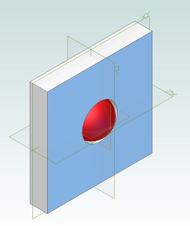

              I had a play with this, got a slightly surprising result. In the image, there is only a single Align constraint between surface of sphere and cylindrical surface of hole.
              I wasn't surprised that the centre of sphere is lined up with hole axis, BUT I didn't expect it to be fixed at mid-thickness in the plate. I can 'tumble' the sphere about its centre, but can't drag it away from location.
              Edited By David Jupp on 20/01/2019 13:53:14

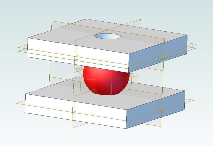

                  Thanks very much for the feed back chaps, but unfortunately I didnt explain the problem too well.
                  I have a fixed size ball bearing (6mm dia) that I want to trap between two plates that both have a through hole of 3.5 mm dia.
                  I was hoping to use the "Quick" command to nestle the ball bearing between the plates, ie let the software work out the geometry, but I've tried using the ball surface and the edges/sides of the through hole as constraints, but when I apply the command it doesnt want to move despite all the ball and hole planes and axies being lined up)
                  The geometry is simple enough but I was hoping Alibre would handle it rather than me have to do the trig manually and set up a plane of intersection.
                  Hope I've made things a bit clearer.
                  #392480
                    I could not get it to do that but you can use the software to work out the gap during the sketching stage and space the two plates that distance apart in your case 4.873397mm and then position the ball half that from one face of the plate.

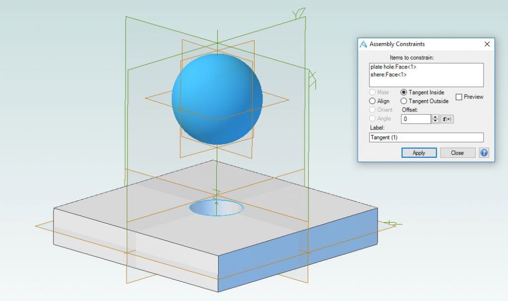

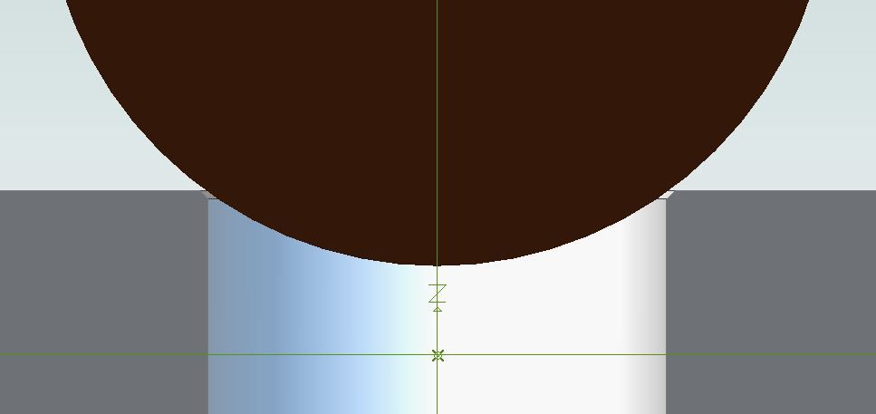

                      I've managed to do it but it's a long winded way and my method above will be a lot quicker. If you want to let the assembly tools do it for you then this is how I did it:
                      1. Add a small chamfer to the edge of the hole 0.1mm will do
                      2. In assembly align the axis through the middle of the hole with the axis through the ball
                      3. Using standard Constraint tool select the face of the chamfer and the face of the ball and then the dot "tangent inside"

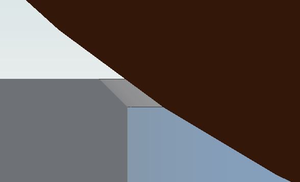

                      When you click apply it looks like it has done the job but if you section the parts and zoom in you can see there is a gap

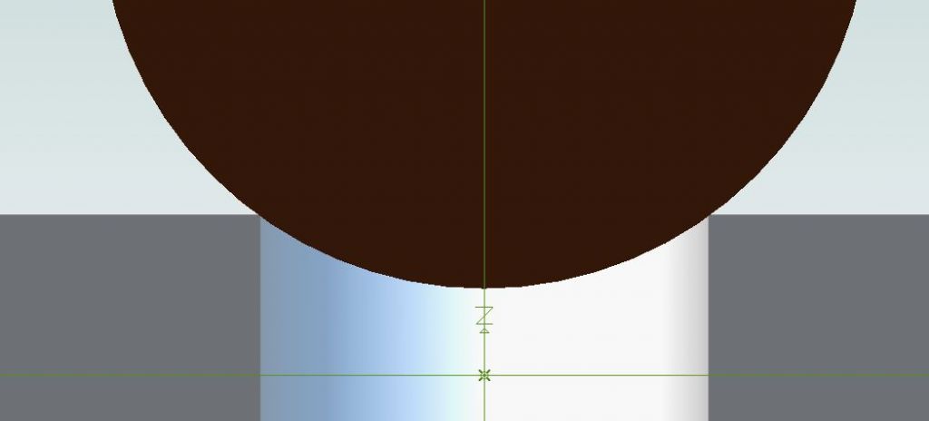

                      If you zoom in further you can see the ball is actually sitting where lines projected from the side of the hole and face of the plate would meet and that is where you say you want the ball.

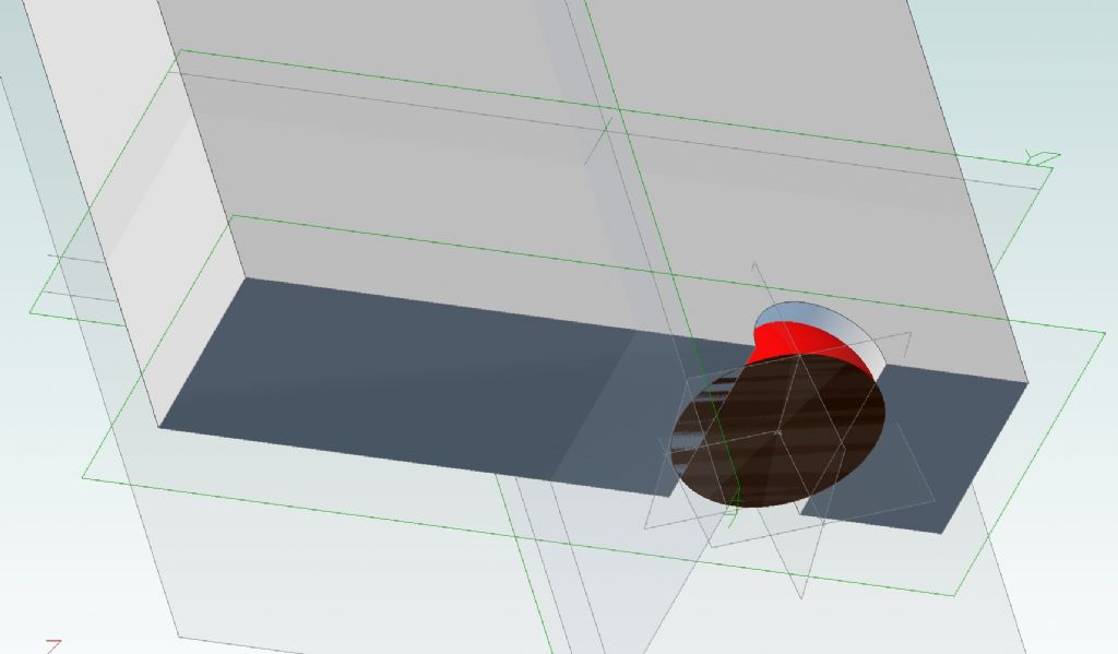

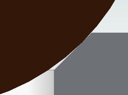

                      4. Anchor the two parts, save and close the assembly as it stands
                      5. Open up the plate part and delete the chamfer, save and close
                      6. Open up the assembly again and now things are where you wanted them.

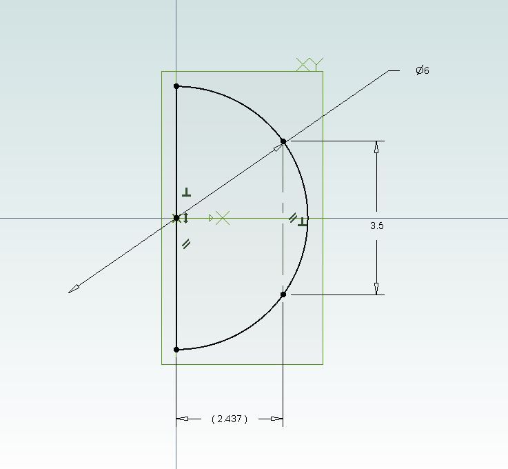

                                        Just calculate the distance from the plate to the centre of the sphere. Got to be easier than faffing around with model geometries.
                                        Andrew
                                        #392554
                                          That does seem to be the simplest way, I just drew a line, set it as 3.5mm long and measured the offset on the sketch as per my first post today.
                                          Only down side of using a dimension if that if you later alter the size of the hole or sphere it will not automatically adjust the positions of the parts
