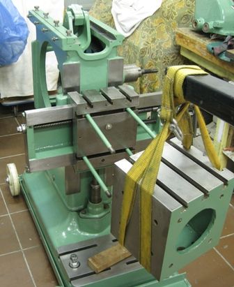

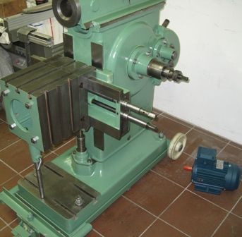

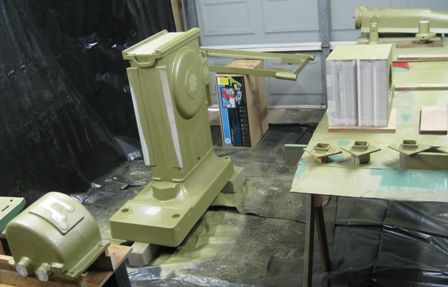

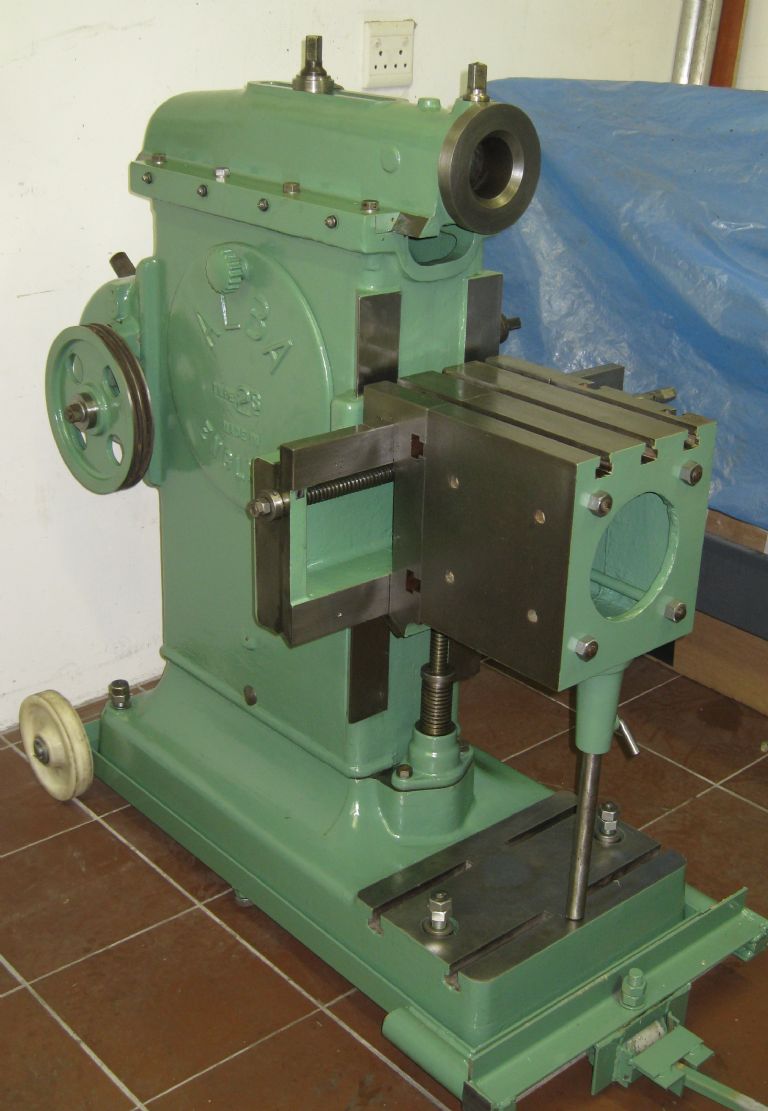

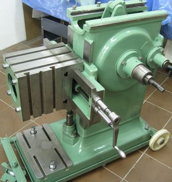

              My Shiny 'new' ALBA 2S starts to appear..
              Everything has been painted ( except the Connecting Link and Self Act link – they snuck off while I was painting and missed the event…-Anyway, they won't be used since I am fitting steppers..)
              Assembly is well under way, as seen in the pics. Parts all fit nicely and everything turns smoothly – still a while before powered cuts can be made though! Lots of little oil cups to be made, oil wicks to be found, the new motor fitted, the vice needs new jaw plates, and lots more!
              Everything primed:
              And All Painted:
              Assembly in process:
              A little different from when it arrived…
              Joe
