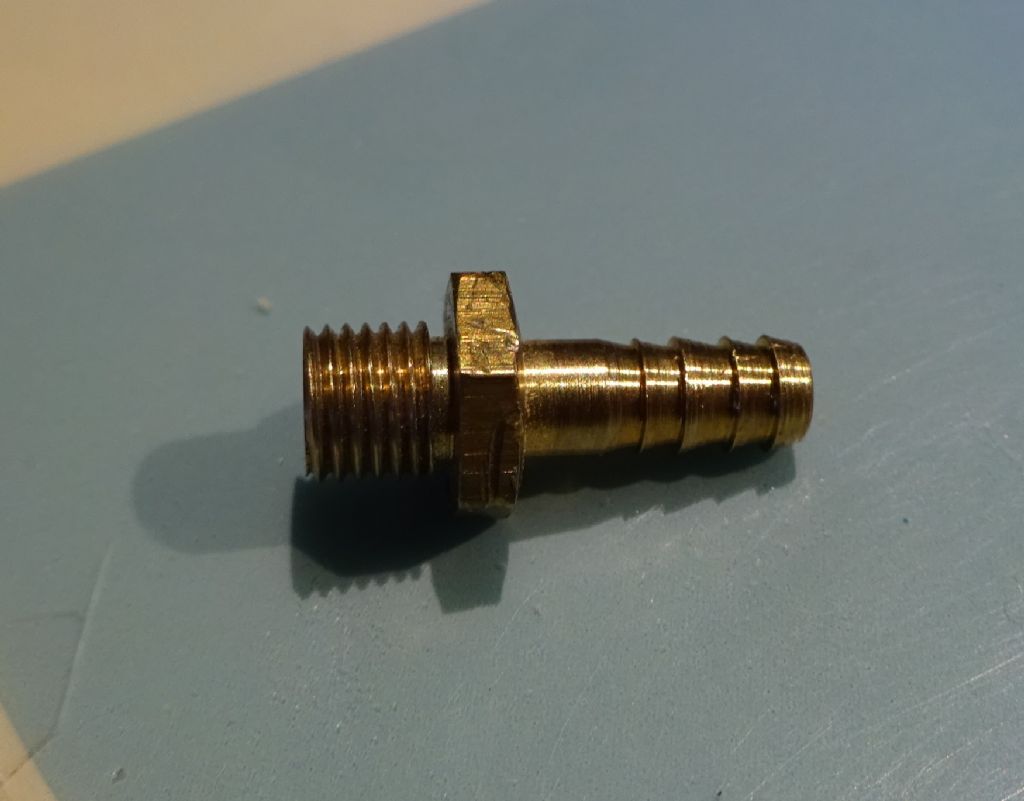

      As I said you will have to make an adaptor one end to fit the thread and this is where Dave's link to a thread cutting die comes in, the other end either threaded to suite your compressor hose or with a few barbs so you can push a hose on.
        Thats fine,thanks.so i need to get some 7/32 rod? I can do the rest no prob ,thank you.
        #354769
          If you have a lathe then something like this from 5/16" or 8mm hex would be ideal.
          #354777
          Terry Chapman 2
            @terrychapman2
            dont have a lathe but im going to silver solder the two parts together. thanks again.

              Posted by JasonB on 19/05/2018 11:16:54:
              You can use the filling hole or the blowdown bush which is front bottom of the throatplate, either way you will need to make a small adaptor from the particular thread to your air hose.
              I made the adapter and the engine turns over like a watch. I’ve found someone who will pressure test it and says I have to remove safety valve, clack valves and plug them. I assume the valve chest and water pump will have to be removed and plugged?
