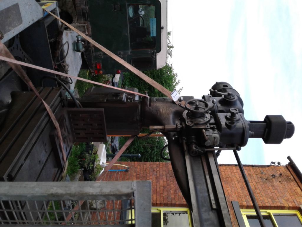

        so something like this?
        i've seen those type of microswitches on machines, presumably they're designed to trip if the workpiece spins on the table.

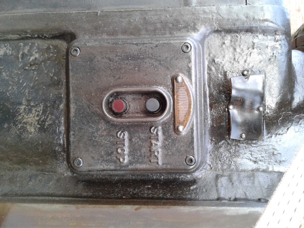

        I'm on a three phase supply i'll look at the breaker in the distro board to get an idea of the current rating. I've just backed to drill into the workshop on the trailer for now as i want to lift it off when there's two of us here but i shall be hopefully doing that tomorrow so i'll get the info off the drill then, there's just a singhle period DOL starter which i presume works the spindle and possibly also the coolant pump, i'm not sure if the coolant pump is working but i can't see a separate switch for it.20210601_202229.jpg

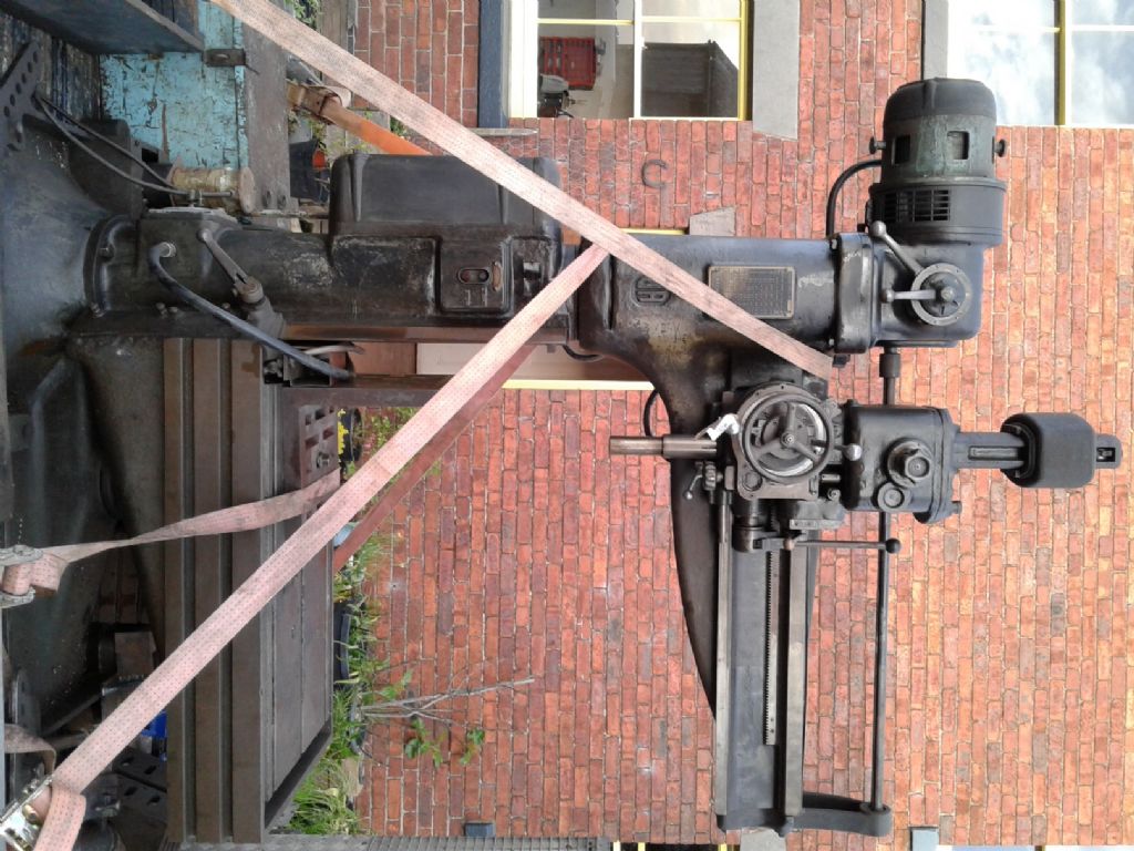

        it was the right way up when i took it, but you get the idea, this are pictures showing the complete machine.
