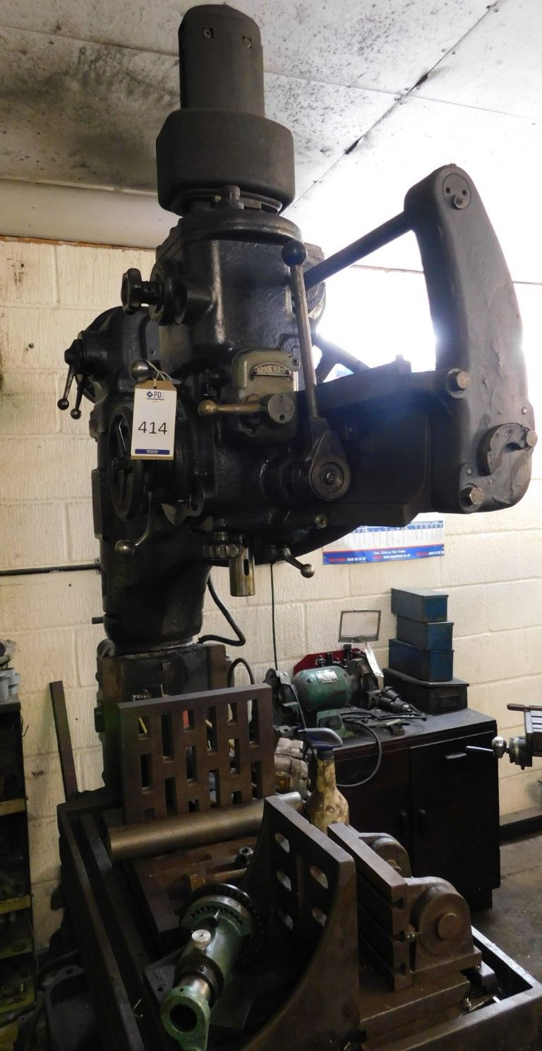

        I've bought an Archdale radial drill at an online factory auction. This**LINK** is the drill in question.
        hopefully if that has worked you'll be able to see that it's a smaller type drill with the MT3 spindle and rise and fall table. I once saw someone trying to move a similar drill at another sale i was collecting from and they dropped it, which didn't end well. there is a forklift on site but the guy i spoke to at the auctioneer's office had never been to the site and couldn't tell me if you could get to the drill to move it with the forks. can anyone offer advice on the best way to go about moving the drill, can it easily be broken down into easier to handle components?, i'll have a four or five hour window to move and load it but i'm likely to be on my own and no one on site will help with loading.
        My initial thoughts were to are to try and jack it up and get it onto a large pallet that i would reinforce by screwing a piece of 3/4 ply on the top, then pass a ratchet strap through the middle of the pallet and over the drill's table and ratchet to drill to the pallet to make it more stable. I could possibly lift the drill with a chain winch to get it onto the pallet but this is dependent on their being a suitable overhead beam and also a suitable lifting point on the drill.
        I remember we helped out the guy who dropped the similar Archdale at the other auction, myself and the guy helping me load my stuff fired up the overhead crane and got the drill back upright and on a pallet for him, i can't quite remember how we did it though but i do remember that the reason he dropped it was something to do with picking it up in the wrong place. IIRC the arm swung round and messed up the way the weight was distributed, and then it all went horribly wrong.

            Golly, looks a right beast:
            Awkward shape, with the motor almost touching the ceiling, and appears horribly top heavy. Without knowing how much it weighs and seeing how it's placed in the building I've nothing sensible to say other than it must be possible! If it went in, it must come out.

              Thanks Dave, it looks bigger in the photo than it actually is, i think, the auction photos aren't great, you can't really tell if it's rusty or painted in a dark colour, or a bit of both, but there is a fair bit of additional tooling with it including the various angle plates on the table, what looks like some sort of dividing head and the cabinet behind it with it's contents.
              I noticed the low ceiling as well, which is not good, suggests it might be in an annex but like you say, it went in, so it should come out.
              i'll try and take some better photos of it, it looks like an interesting machine and i'm looking forward to getting it but i have a certain amount of trepidation regarding moving it.

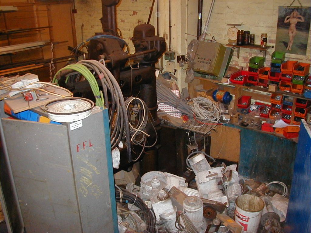

                    Not much help I know but I also I have an Archdale radial arm drill circa 1921 which I bought from a factory closure sale in Birmingham. Eveyone had a tale of disaster of moving these machines so I would imagine any established machinery mover is well versed.
                    It was in a store room partially buried. I bought the complete room and and demolished a wall to get it out selling most of the other contents of the room. I recruited 2 scrap men with a useful Hiab lorry to get it home and as we were gently pushing the drill through the factory delicatley balanced a pallet truck we were constantly heckled by people wanting to buy it, lots had looked at it but were more cautious than me about buying it and getting it out of the room.
                    Mine is really top heavy but we managed to get it home intact and install in in a shed and its proved very useful especially as you can clamp work onto on the side of the table. Great machine, pleasure to use with all the controls to hand—hope it goes well.

                              Hi Andrew I have moved these in the past and the main thing with these is getting the weight down and locking every thing up before moving. It may need moving down before the power is removed as some need power to lower the arm. These have to be bolted to the floor and I have jacked them up enough to get a large disc cutter to cut the bolts close to the floor. Watch out for sparks setting fire to oily items etc. There may be a diagram on the machine giving a lifting diagram but generally it is best to remove the box bed etc from base lower the head and move the head nearer to the column. If there is any possibility that the forum lock dosn't work put a substantial clamp on to the bed and use that to strap the arm to prevent rotating. Slowly Jack up and skate it to lifting point with crane or Hyab there may be an eybolt in top of collum and two points on side of base on other end. Fork truck would be my last resort but in necessary make sure there is rubber sheet between fork and bottom of drill. Have a look on lathes.co.uk web site there is a picture of one on there and also have someone check to see if there is a coolant tank as that will need emptying and you may be liable to remove coolant off site.

                                Hi, just to clarify, I think Andrew's machine looks similar to this one Radial Drill as he says it is the table that moves up and down, not the arm.

                                    Nick is correct, i think the drill in his link is the same as the one i've bought,.the arm is at fixed height and the table is fastened to the column and moves up and down, this is relatively small for a radial drill, it's 'only' MT3 with a 1 1/4" capacity, it's still weighs 1.2 tonnes though. i was thinking to drop the table as low as it will go to lower the centre of gravity and then wind the head in as close to the column as it will go, as David suggests,

                                      Hi Andrew, it might also be a good idea to strap the end of the arm to the table to prevent the arm swinging, in case the locking on the column isn't good or it it accidently gets unlocked. I was involved in moving a nearly 3 ton Richmond one into position from off a low loader about 40 years ago, but we did have a traveling 5 Ton overhead hoist, but I can't remember exactly how we rigged the lifting strops to it.

                                        Hi Andrew,
                                        Its a bit hazy after 17yrs but I think we had wound the table down while in the room locked everything and wound tthe head as far to the column as possible then jacked and packed it to get it onto a pallet finding the balance point as it was some distance to push it through the factory to the loading point. Think we ratchet strapped the head to the table and the head to the column to reduce the chance of it all swinging out while it was in the room.
                                        We lifted it with a strap on the column, that seemed easy as it balanced reasonably well. Ours had originally been driven with line shafting and a motor was fitted low down at the back which helped the balance.
                                        The scrap men were well versed at moving and securing machinery and were patient throughout the epic journey which was around 40 miles, only mishap was taking a chunk out of our gatepost with his lorry as he drove in!

                                              Fetched it today, took nearly three hours to get there but it was loaded with very little drama. we helped some guys move a surface grinder that was in front of the drill when we got there, and they loaded it onto my trailer with their hiab for me, i offered to pay for the lift but they said no, you've helped us so we'll help you, the drill was already standing on wooden blocks for some reason so we moved it to the door of the building with the onsite fork truck, and put a strap round both the drill and the mast of the forklift to prevent it falling off the forks.
                                              with the table dropped right down, the head wound in and the arm locked, it rode fine in the trailer, i'm really pleased with it it's better than i expected and there was a load of stuff included with it. I'll stick some photos up. hopefully i should get it unloaded and in the workshop tomorrow,
