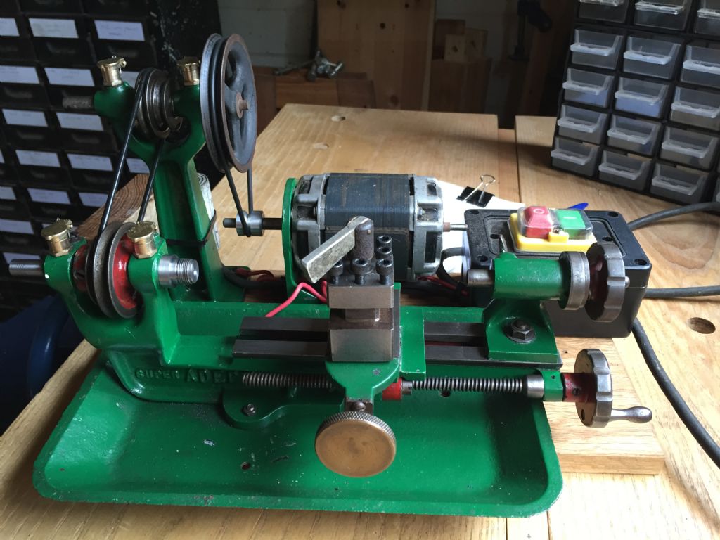

        We used to have a Super Adept, although it moved onto a new owner a few years ago. It had no topslide, but that may have been a blessing in disguise given the "Gibraltar" style toolpost that it came with. I installed the oilers, added an NVR switch, and made a new spindle with an M14 nose to take a modern chuck. I also had to make a new motor pulley as the original was massively eccentric.

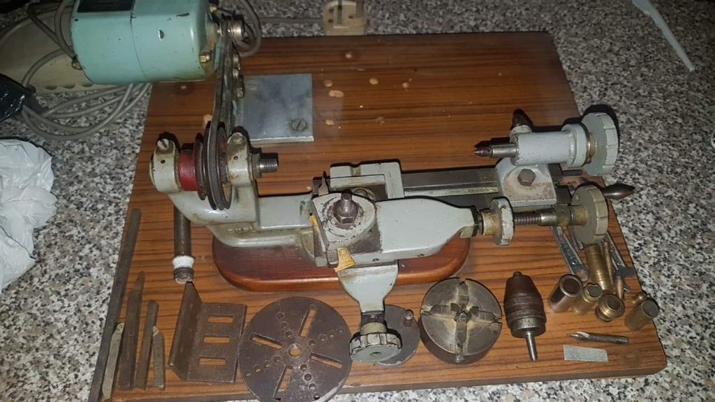

                                        Hello,
                                        Another resurrection of this thread. Neil put my name down on the register. Super Adept lathe as received
                                        I received this from my girlfriend's dad, who had it stored above the kitchen cupboards for goodness knows how long. The photo is as it's arrived. I want to add some additional tooling and if someone could let me have a drawing/measurements for a faceplate, I'm going to turn a new one as the one with the lathe is wobbly as drunk on a Friday night.
                                        I've decided to try and make this as useful as I can, and it will be given to my little boy (5 in October) as a present for him to learn some basics of turning metal. The four jaw seems in good order, the drill chuck taper seems to be beat up although the jaws all move and seem to centre well. As received it's a bit sloppy and the gibs I think need adjusting correctly, as do the headstock bearings as I can feel a clunk when the spindle is moved up and down. But not so much when moved side to side.
                                        I would also like to make a layshaft for it to help increase torque for cutting, it has come with some useful bits of HSS. I do find myself wondering though what tools would be useful additions to this lathe. (Right time to go back a couple of pages and finish reading the replies).
