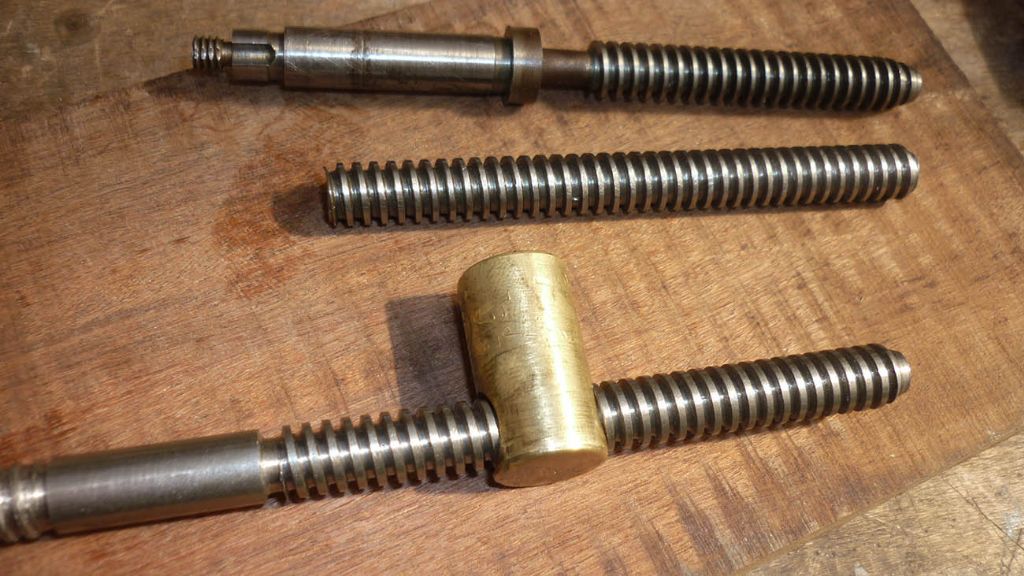

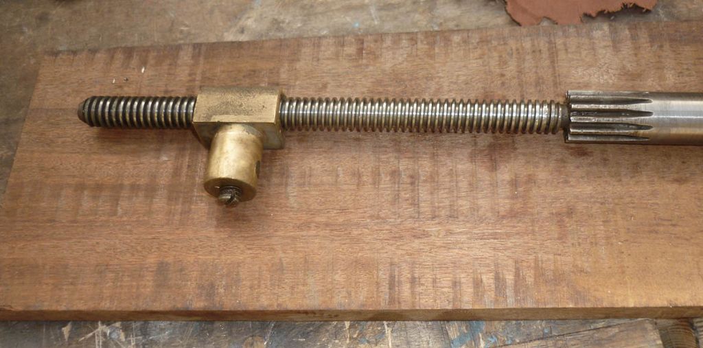

                  I got the 8tpi figure somwhere else on another myford thread in a forum (excuse the pun lol)
                  I didnt think it sounded right.
                  Anyway, ive done a bit more research and yes, its supposed to be a square thread, and I believe this is what Myford use.
                  I also found a blog where someone machined their own feedscrews and nuts. You need a moving steady and the right screwcutting gears and ground cutting tooling etc.
                  Quite a lot of work and hard to do a nice job, he had to do many slow passes on the lathe.
                  He made his shaft 9mm but 3.8" is closer to 9.5mm
                  Does shaft diameter affect TPI?
                  If not, I think ive found the answer.
                  I can find many retailers who stock square threaded shaft in 10mm diameter, 2mm pitch.
                  Should be able to find the correct tap to make my own nuts also.
                  If you look at the aftermarket feedscrews that myford solutions sell, they look simply like they are made from cut down prethreaded rod, with the end machined down and threaded to accept the handle.
                  They differ in that they dont have the unthreaded "lip" at the end of the shaft, I thought this may have been required, so not sure why they machined them like this, unless they had to do away with it by using prethreaded metric rod.
                  See photos:
                  Myford feedscrew
                  Myford Solutions aftermarket feedscrew
                  Their feedscrews also are bronze, not the crappy zamac alloy that myford uses, but I will machine my own if this will work with 10mm rod if it does not affect the dial calibration.

                    I think you will find Myford uses Acme thread (or maybe trapezoidal for metric?) and not square. But square will certainly work for you if that is what you can buy in threaded rod.
                    Tracy Tools and others can supply square and Acme thread taps. Many on eBay too. Can be a bit hard to tap large chunky threads like that from scratch so it is common to rough it out by screwcutting in the lathe, even with a steep-sided V tool and finish with the tap. Or buy a set of progressive taps.
                    I make all my leadscrew nuts from brass, not bronze. Less wear on the leadscrew that way. And easier to machine.

                      Posted by Hopper on 27/11/2019 07:01:25:
                      Im quite lost to what thread Myford uses, but most sources ive seen say that myford used square thread on all their lathes.
                      Anyway, from what i understand, acme was the term used for trapezoidal thread in the days of imperial?
                      As far as bronze goes, I think alot of people call brass bronze and vice versa. Bronze is supposed to look more copper in colour isint it?
                      The nuts in the photo certainly look brass in colour than the coppery bronze colour.
                      Anyway, would a 0.5mm increase in diameter over the original myford imperial feedscrew change the TPI and affect the dial readings? Or does it stay constant irrespective of the diameter if the thread pitch is the same?

                                                I made some here for my southbend when i got it. This was the result of only my third attempt ever at screw cutting. I just used leaded steel and used the original nuts . They were a large improvement in back lash etc on the original screws . Still working fine after a few years. I grafted the threaded section into the original parts using loctite and a pin.
                                                Edited By mark smith 20 on 27/11/2019 11:11:36
