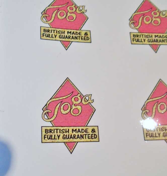

                                      Here are a couple in the pipeline:
                                      Martin
                                      #626843
                                      Hopper
                                        @hopper
                                        Nice work. They look good.
