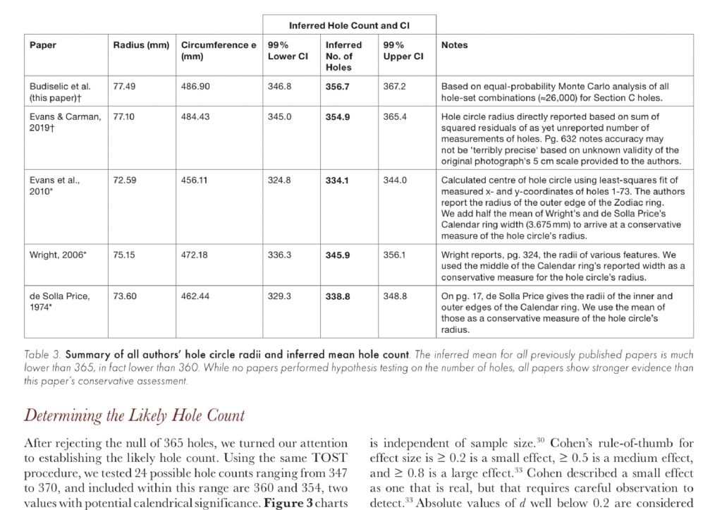

                            A. We obviously don’t know for certain, but; it seems reasonable to assume that the holes are on a setting-ring which serves some calendric purpose. To fit that purpose, I would suggest that the Greeks only needed to be able to drill ‘n’ holes on a circle, without them breaking-into one another and forming slots. … This seems realistically achievable with hand-tools.
                            B. If, however, we are attempting to ‘reverse-engineer’ a complex and incomplete mechanism; we really need to know [or be very confident in our estimate of] the ‘count’ of any gears and setting-rings in the remains.
                            The available fragment appears to be approximately one fifth of the full ring.
                            The BHI paper makes a good case for wanting it to have 354 holes …
                            … but I am questioning the confidence level of that number.
                            My own working [from published images rather than the originals] made a reasonable case for the number being 352, but that would not fit the research team’s model.
                            I have invited forum members to repeat my exercise, and compare our results; but no-one has yet done so.
                            Accepting that my ‘personal equation’ may have skewed my estimate [*], I would be grateful if someone could check.
                            I do believe, however, that I have demonstrated how difficult [near impossible] it is to extrapolate from that fragment to the full circle.

                              For convenient reference, I have copied this table of ‘other estimates’ from the BHI document:
                              Obviously … the text continues, and the whole document is worth reading.
