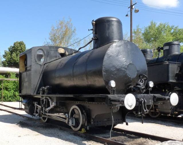

                Sound similar to a loco I spotted in the Budapest Railway Museum some time ago. This is a fireless 0-4-0 tank loco 91,001 (UIC B-f2t). Technically it probably isn’t a tank engine as it has no tank or firebox, just a large steam receiver. Designed for working in hazardous environments, the receiver was just filled from the factory steam main as required. Built by Lokomotivfabrik Krauss & Co. of Linz am Donau, Austria in 1915.
                The manufacturer might be a place to start.

                  Journeyman – the loco you offer is not the same in the relevant bits – your cylinders are at the end (front or back) whereas my problem device has cylinders in the middle, driving axles front and back. Sorry.
                  I did come across one of these Linz engines at work in the 1970s, somewhere in (probably) Austria. My interest was arroused because I had never read about such things in the tecnical steam history stuff.

                        Journeyman's loco is indeed a "fireless cooker".
                        Probably the last three examples of this type of machine were supplied to ICI by Sentinel in 1958 /early 1959, just as I started my apprenticeship.
                        If the piston in the Nurnberg loco is double acting and central in the cylinder, the steam driving the piston towards the rear, will be pulling the front crankpin upwards and backwards, while the rear piston rod and con rod will be pushing the rear crankpin backwards and downwards, whilst exhausting. So both piston rod/connecting rod assemblies will be causing rotation in the same direction.
                        To be efficient, there would need to be very little restriction (back pressure ) of the exhaust steam. But that goes for any double acting steam engine.

                            Posted by Howard Lewis on 28/06/2019 21:25:54:
                            Heysham nuclear power station had one. proudly labeled as the worlds only nuclear fired train (when I was there in 1984). I think its stated purpose was for shunting fuel rod wagons, but I don't think it saw much action.
                            Hah! Just found it:- https://ribblesteam.org.uk/exhibits/steam/andrew-barclay-1950-1928-heysham-no-2/
                            A Barclay fireless locomotive first delivered in 1928.

                                              – If steam only, as it is drawn off, the reservoir's pressure and temperature would drop very rapidly.
                                              – Water will retain its heat for a lot longer, refilling the steam space by evaporation as the locomotive moves, and with a far lower pressure and temperature fall.
                                              A parallel is the aerosol spray can, whose propellant is a highly-volatile fluid kept in that state only by its own vapour pressure, but maintaining that pressure to the end.

                                                According to Wikipedia they were charged with superheated water under pressure. As the steam is used and pressure drops, the superheated water boils, replacing the used steam.

                                                  The energy is stored as heat, with the reservoir full of water acting as the thermal mass. In the case of Unique at Kemsley Mill, the reservoir was at 220 psi, but on later locomotives it could be as high as 300 psi. Steam was fed to the regulator at 80 psi thanks to a pressure reducing valve, so the locomotive produced full power until the reservoir pressure fell to 80psi, about four hours after charging.
                                                  They were surprisingly common, in the UK alone, Barclay's built 114 (the last in 1961), Hawthorn 17 and Bagnall 15, although they were also manufactured in large numbers by German builders.
