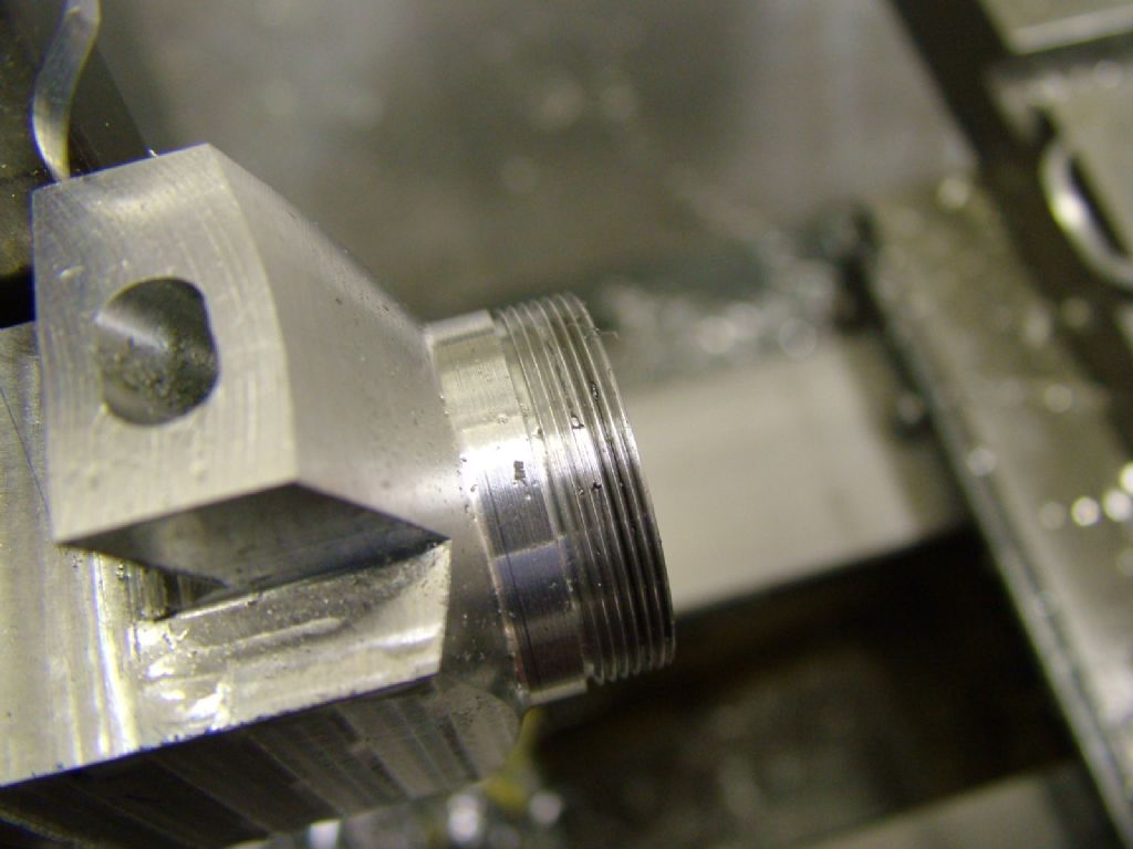

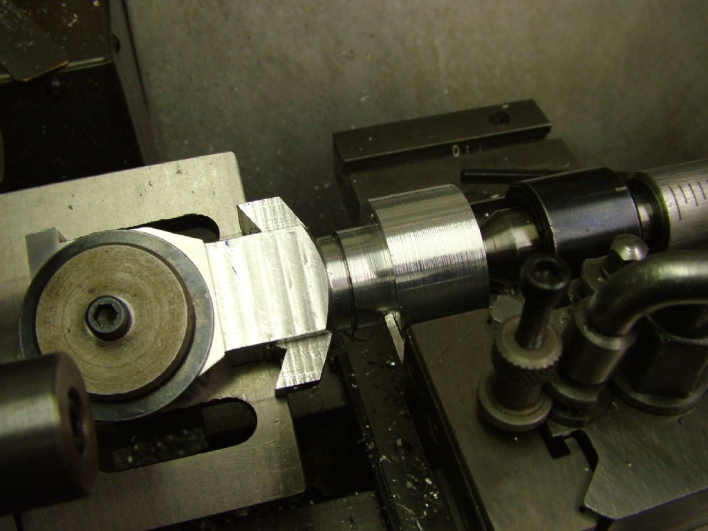

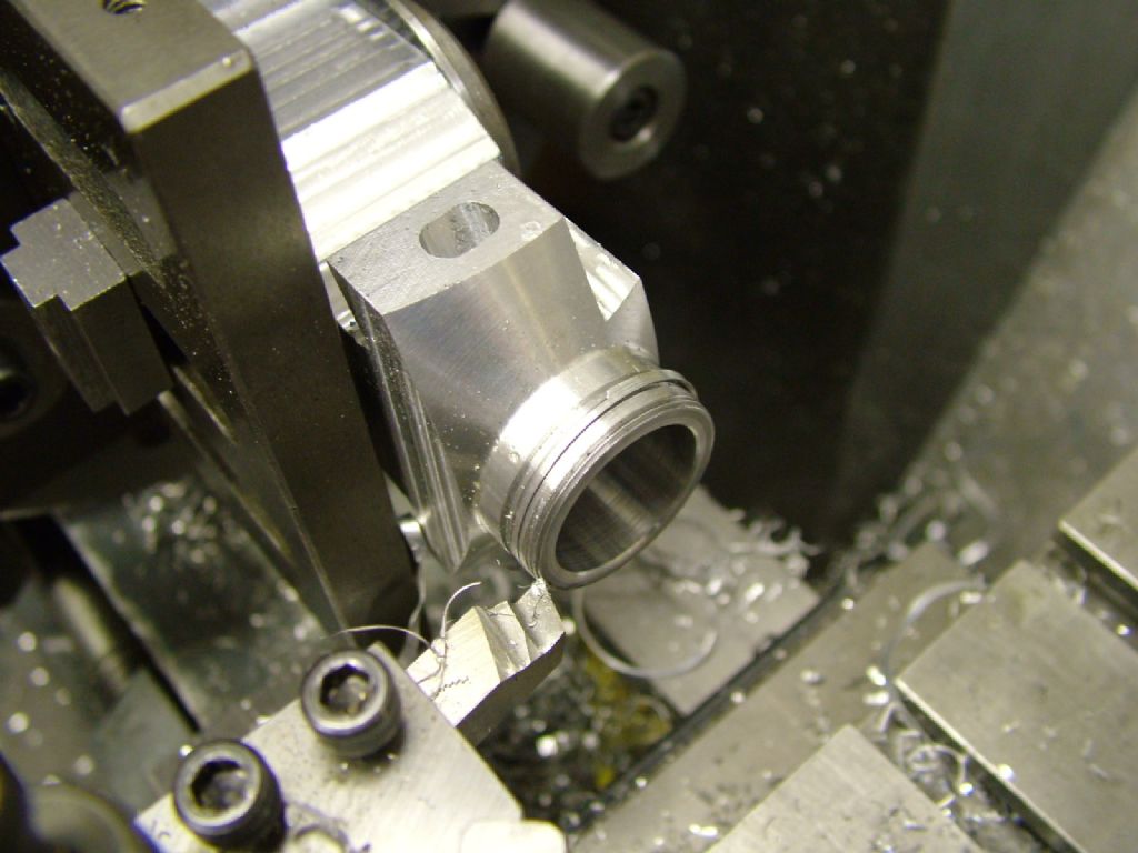

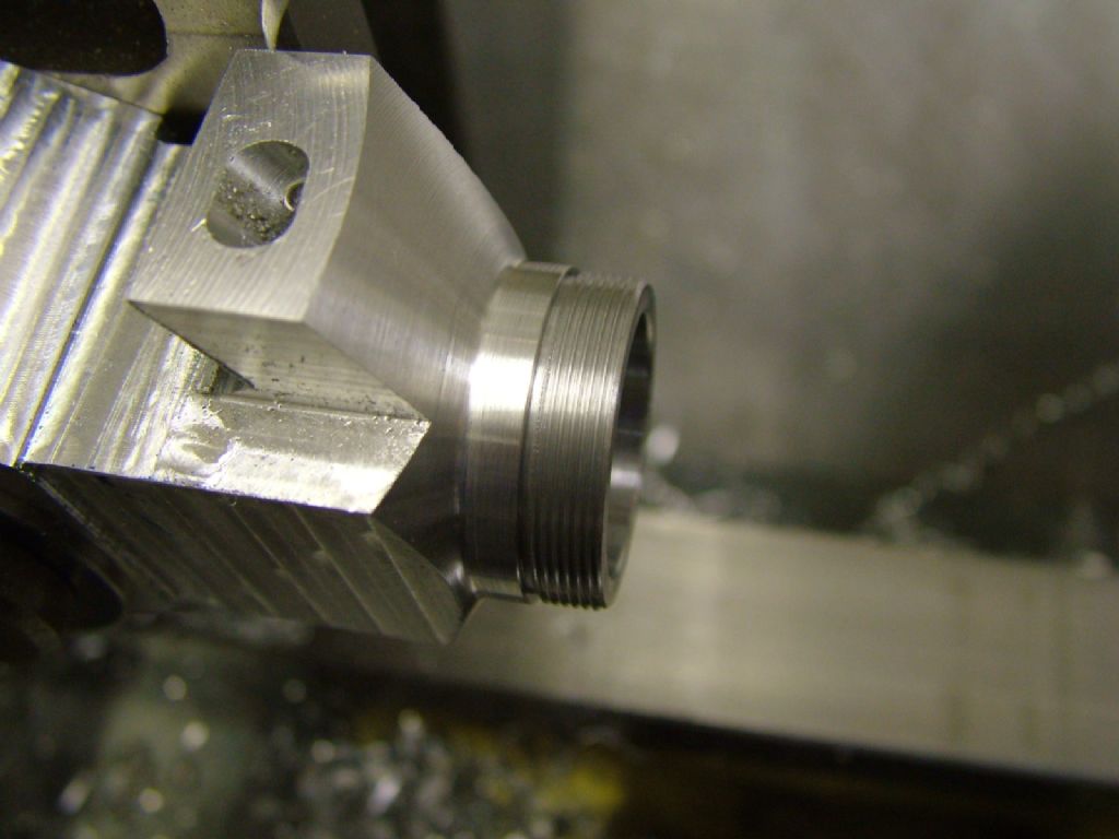

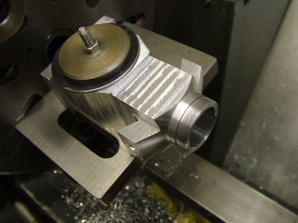

                  I had to go out earlier tonight but was trying to find these few pictures beforehand.
                  These show the pick up that occurred on the Atomatic build
                  The initial screwcutting.
                  Trying the previously screw cut head to check the thread – this galled without warning. Just about to machine it off
                  Final break through
                  The galled spot – small but compacted this resisted all attempts to unscrew the head
                  After re cutting the thread. There were a lot of screw thread fits on this particular IC engine so a lot of nervous moments when trying fits and the use of plenty of anti galling grease from this point on!
                  Hope this helps you James to visualise what galling means.
