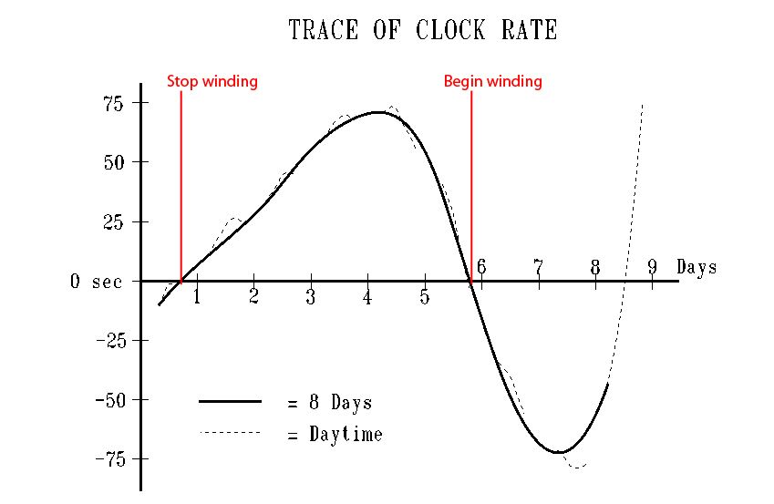

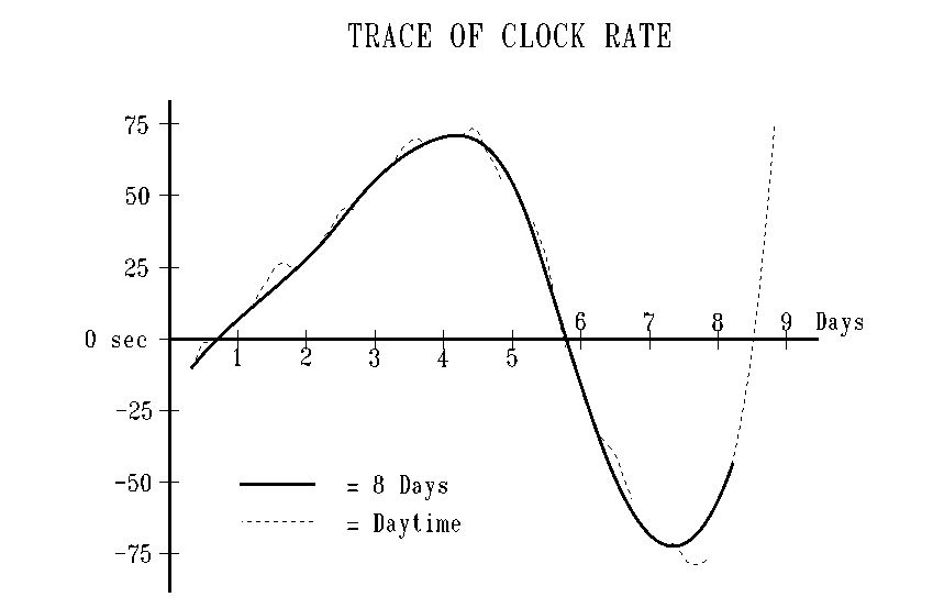

        As reported before, my version of John Stevens’ skeleton clock has several issues of time-keeping. My very simple attempts at torque measurement revealed the cause of poor time-keeping. Although crude, they provided enough information to show a distinct fusee inaccuracy, a situation which I’m no longer in a position to rectify.
        A few months ago however, I commenced a series of tests and adjustments, and graphed the results. My final plot below illustrates two factors.
        The heavy line displays daily errors. I took these at 5 am each morning based upon the assumption that they were perhaps the least affected by (Melbourne’s) ambient temperature variations. I was not serious enough to collect night-time readings. The caterpillars crawling up and down the slopes are the results of hourly daytime variations.
        Given that the fusee does not accurately compensate for the varying output torque of the main spring, my intention was to set the timing screws on the balance wheel to the best compromise. After several weeks of timing tests and adjustments, I believe that I have set the mass of the balance wheel to the best compromise. Here are my observations:
        • Over 8 days the variation ranged between +74 s and -79 s.
        • When the main spring is fully wound, the stop-work mechanism fails to function.
        • As the main spring runs down, the arc (swing) of the balance wheel begins to decline.
        Until about day 6 or 7, the balance wheel arc (swing) appears to remain fairly constant.
        My conclusions.
        • I suspect that as the fusee torque varies up and down, there is a corresponding change in the friction at the locking and impulse faces of the pallets.
        • I also suspect that there is a change in the mark/space ratio during the locking and impulse phases of the escapement.
        • The fusee profile fails to accurately compensate for the output of the main spring.
        • Selective use of the `flat’ portion of the main spring is not possible.
        • The escapement is extremely sensitive to variations in the fusee torque.
        • Balance wheel temperature compensation needs to be properly evaluated.

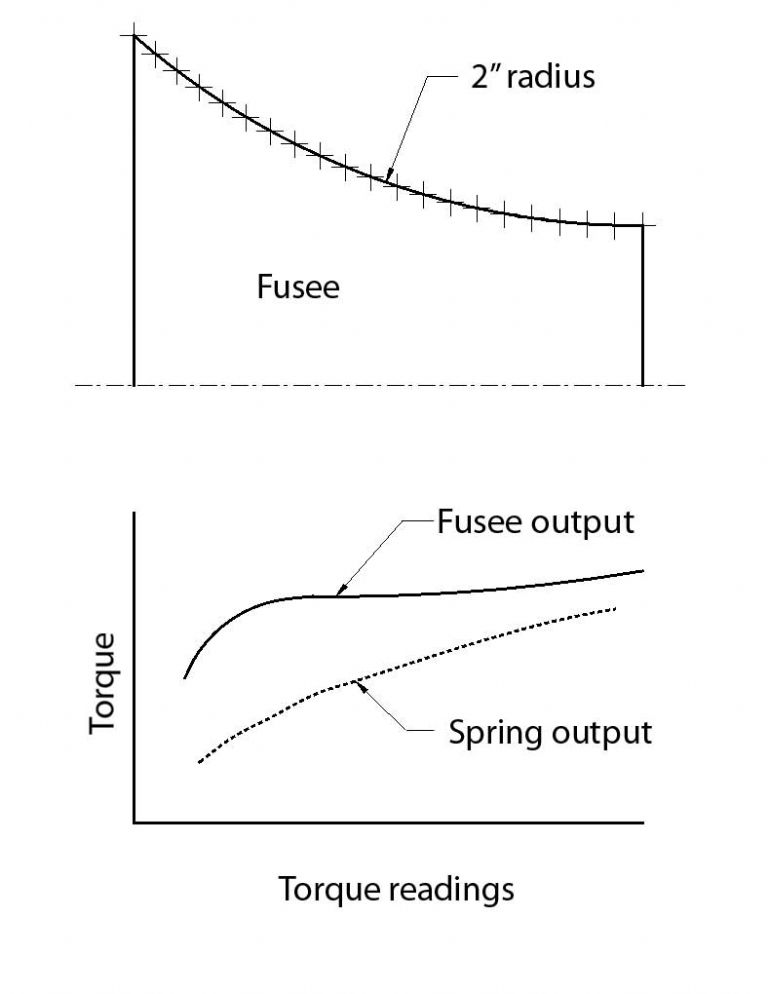

            Here are a couple of pictures from my albums to start with – fig. 8 - torque readings.jpg
            The main-spring output was determined by calculation using the (approximate) radii measured off the fusee. A sort of inverse determination.

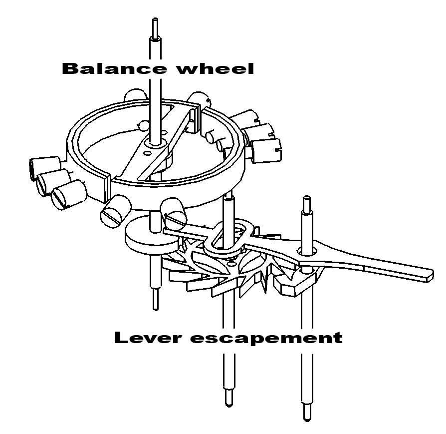

            In answer to your question –
            “Is the profile you used a published one or is it made up or derived in some way?”
            Yes. It was a 2” radius profile, taken directly from the drawing thus –
            For various reasons John, I’m no longer in a position to alter the fusee profile.
            In terms of setting up the fusee and main spring, I fear that their combination fails to provide useful `access’ to the so-called spring flat-spot.
            In other words, up to the point when the stop-work lever `kicks in’, the main spring is almost completely wound. Adding any more clicks to the barrel ratchet fully winds the spring, and the stop-work mechanism doesn’t engage. Removing barrel clicks and the clock stops before all of the fusee line has been used up. At the start of day 8, the arc (swing) of the balance wheel decreases, and the clock speeds up. See the dotted line between day 8 and day 9 on my graph.

            Applying extra driving force causes the balance wheel to spin through an increasing arc until the impulse pin travels around far enough to strike the outer edge of the escapement lever. I would need to understand what freewheeling means in this context.
            Finally, from what I can see of the escapement wheel (under low power magnification), it appears to lock with no detectable twitching. As for adequate depth, I estimate about 0.01” (0.25 mm) for both entry and exit pallets. The geometry of the escapement as a whole, conforms well with the drawings, as far as I can tell.

                      Although it defeats the `eight-day’ objective, I have pondered whether to wind the clock more frequently, choosing start and stop positions appropriate to the `best’ overall results.
                      Without changing the rate, my choices (as has been suggested) would be as per the graph here:-
                      In other words, using the first two thirds of the wind from just under fully wound to about two thirds (roughly five days).
                      My other simpler option would be to wind the clock when it needs to be wound, and reset the fingers.
