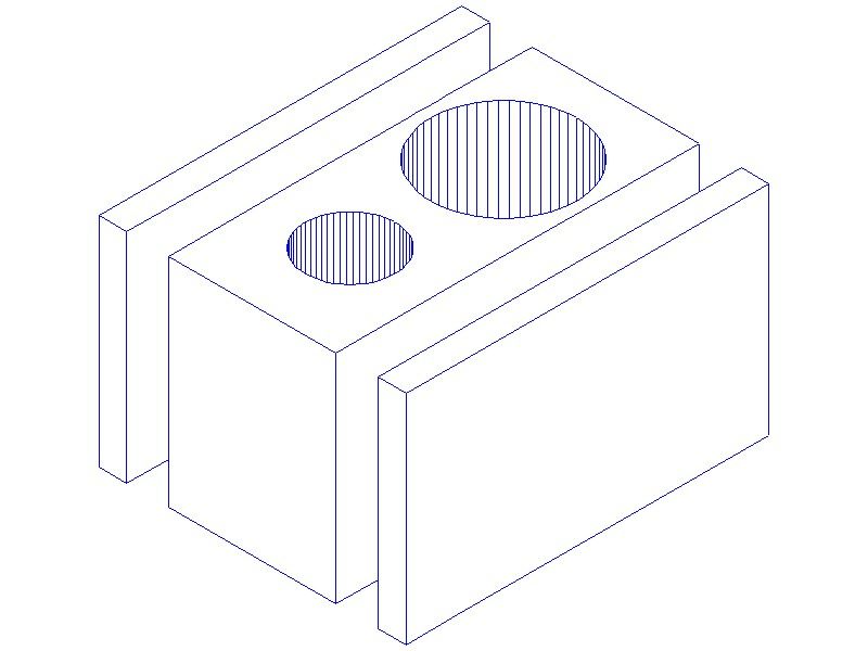

                  This is a sketch of Option 1, exploded. It is to scale using the candidate block of iron; but I have omitted all details including the ports – which would have been very difficult to draw.
                  The ports are dug out of the end faces so there is not very much depth left for the LP passages. The 52mm (2" ) LP cylinder wall is only 15mm from the port face at its closest, and on the arrangement above only about 3mm from the sides of the casting. The screwed-on plates are drawn at 10mm thick, the block nominally 60 mm wide, to hold an LP cylinder cover 75mm / 3" diameter.
                  The ports, the overall length over port-faces, and the valve-spindle and cylinder centres, are all set. I can't change them.
                  The existing block is much wider, but I drilled the passages parallel to the port faces, so quite shallow-lying, and when I drilled the valve-chest studs years (literally) later, some go straight into them.
                  The passages meet the bores by milled recesses that leave very narrow lands for sealing at the ends of the block, though the gasket would receive some support from the valve-chests – if I had thought to make the chests slightly over-long.
                  This arrangement was easy to machine but creates disproportionately large clearance volumes. One of Luker's locomotive drawings in ME showed me what I should have done!

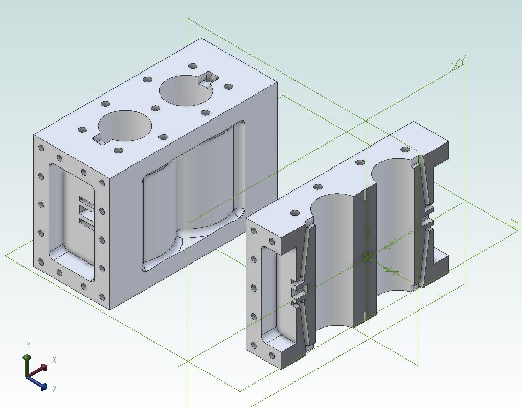

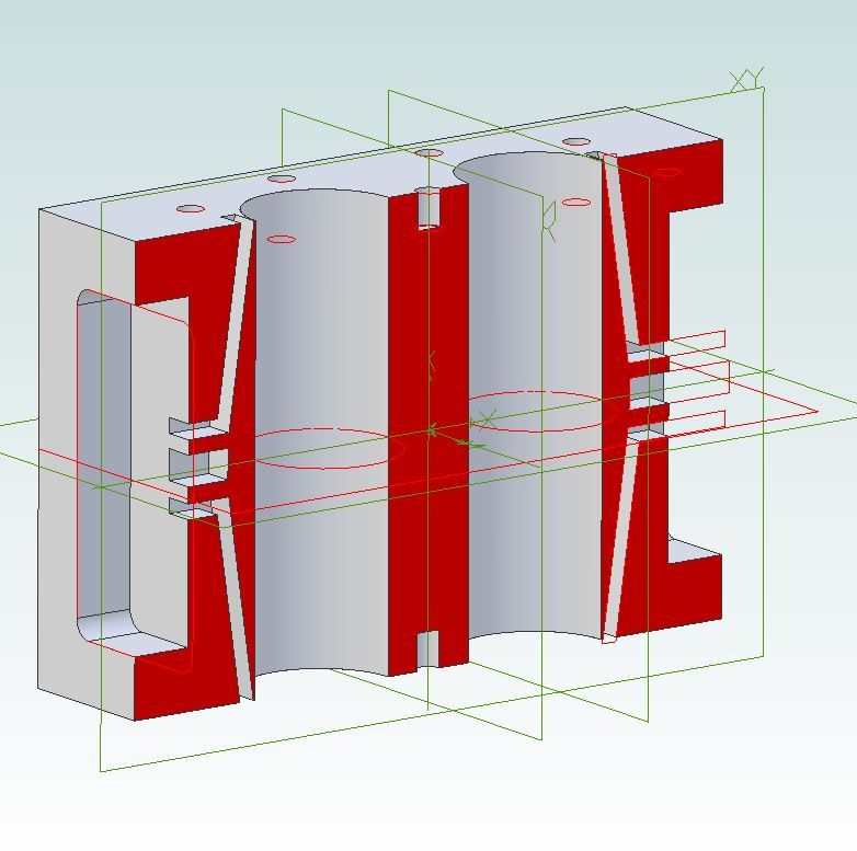

                      If you take a look at sat the Stuart compound then the chest covers are 1/8" think around the edges, allowing for the cast in "S" then you probably only have 2mm thickness to play with and that's a flat surface and you don't hear of them going pop.
                      Any reason the cylinder covers have to be round? a lobe or similar could take care of any thin sealing surface that the end notches cause
                      As for the stud holes into the passages plug them and move the stud positions or just seal the studs well into what metal there is.
                      Like Ramon I often mill the passages into a block that fits to the side of the cylinder though with 15mm to play with you have plenty
                      I think I sketched something out a while ago in one of your CAD threads, if you did vertical drilled passages rather than the angled you would need even less metal.

                        Your images there are more or less as I have made –
                        but I drilled the passages parallel to the surface and quite shallow, and the valve-chests are separate so I can machine the port faces flat.
                        This makes the "keyhole" recesses approach the end of the block very closely, greatly reducing the sealing area. It also gives insufficient depth for the stud holes without entering the passages; and prevents the direct use of round covers.
                        My plan was to fit a steel plate top and bottom, with the circular covers themselves spigotted into that; but the lands at the ends are too narrow for reliable sealing.
                        A lobed cylinder cover may work, if there was anywhere sensible for the lobe screws, but would look wrong. The top of the engine is in full view with round, 6-stud covers on a big flat surface. (11 studs as one is a shared central one.) I am hardly Highly Commended league, let alone the Hewson / Seymour-Howell level of quality, but I do want this thing to look somewhere near its prototype.
                        The valve-chest stud dispositions I have used are much as your drawing… only they give precious little room for the HP steam inlet / starting-valve (on the chest wall itself), and not a great deal for the valve-rod gland.
                        I don't think the valve-chest covers (mine are mild-steel) and the cylinder walls are sufficiently comparable. The problem with this 60mm raw-width block for a 52mm diameter cylinder, is if the wall would be strong enough even if flanked by a plate each side.. The area of concern would be adjacent to the side stud holes, on your image.
                        Taking these points into consideration, and looking at your examples, Option Three is looking more feasible: drastic surgery on the existing block, which is a healthy 110mm (about 4-1/4" ) wide. I have allowed 5 – 6 inches wide for the engine case below it, whose original photographs show a distinct step outwards to be wider, below an area with access holes to the stuffing-boxes.
