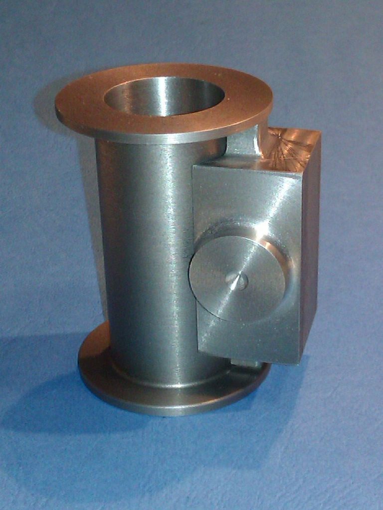

            Just an update guy’s – the valve gear is well under way but have to take a break for a couple of days so heres the current state of play
            There’s just the rocking shaft and arm to complete the top end and then the eccentric, strap and rod to do and it should be ticking over on air. The flywheel finally got fettled and primed too – only some fourteen years after it was made
            The drawings have proved to be very good – the dimensions were just scaled 1.333 and converted direct to metric ie not rounded up or down. It’s all gone together extremely well. I carefully checked the valve guide hole position relative to the C/L of the cylinder before fitting the guides and had to redrill them to make allowance for the steam chest gasket . Now that is good dimensioning

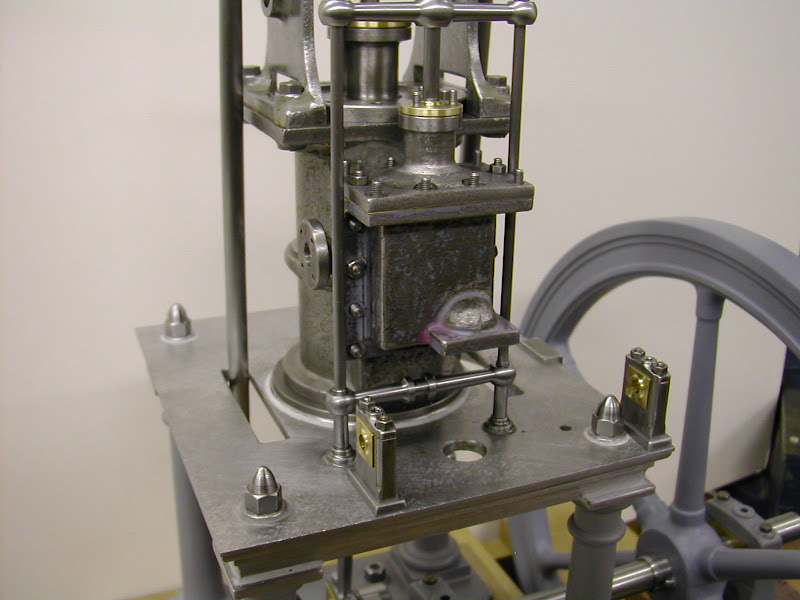

                        Thanks for the post Neil, I do have a couple of older ME references to table engines but this one is new.
                        Having read it I then checked Anthony Mounts (very) short intro on the Waller prototype. He states that this engine was taken from a book written by a director of George Waller and Co and published in 1880. According to AM this is quite late for this type of engine. I believe AM develops many of his designs from old patents, engravings etc and I assume that is the case here though no reference is given as such.
                        I suspect that there may be a degree then of artistic licence as though the text does refer at various times to the prototype design it is a rather ambiguous as to whether it’s fact or AM’s interpretation. The flywheel which is to ‘my interpretation’ could, I agree, be considered a little heavy for the type but it’s rather late in the day now to make another (of this size) given the kit available …….
                        Well I’m pleased to say that at last it’s running on air. I jury rigged the eccentric rod yesterday to ascertain the length just to be sure but like all the other dimensions it was very close to that scaled. Today then saw the rod made and fitted and a quick run for a couple of pics.
                        It appears as if it’s about to take off but ifact its not much more than a fast tick over. The airline is just pushed ito the steam inlet hole so is escaping all round and the pressure is just on 15psi.
                        In attempt to ‘slow things down a little for a better pic the hose was bent to restrict the air but the camera still isn’t up to the very slow tick over in this one either. Oh well I’m sure it tells a story
