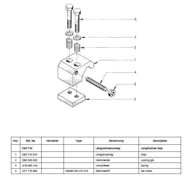

    Problem with the V10P is that there is not much space between the forward V of the bed and the leadscrew below, so fancy turny handles do not fit in there.
    My V10p Stop is a simpler version of the one shown here – the one on my 14D ( successor to the Super 11 and Super11-CD) – The 14D item is adjustable from the top. while the bolts holding the V10P one had the bolts on the bottom. I think the top bolts will not work on the V10 though…
    If you need more pic of the V10P item, etc, let me know.
    Joe
