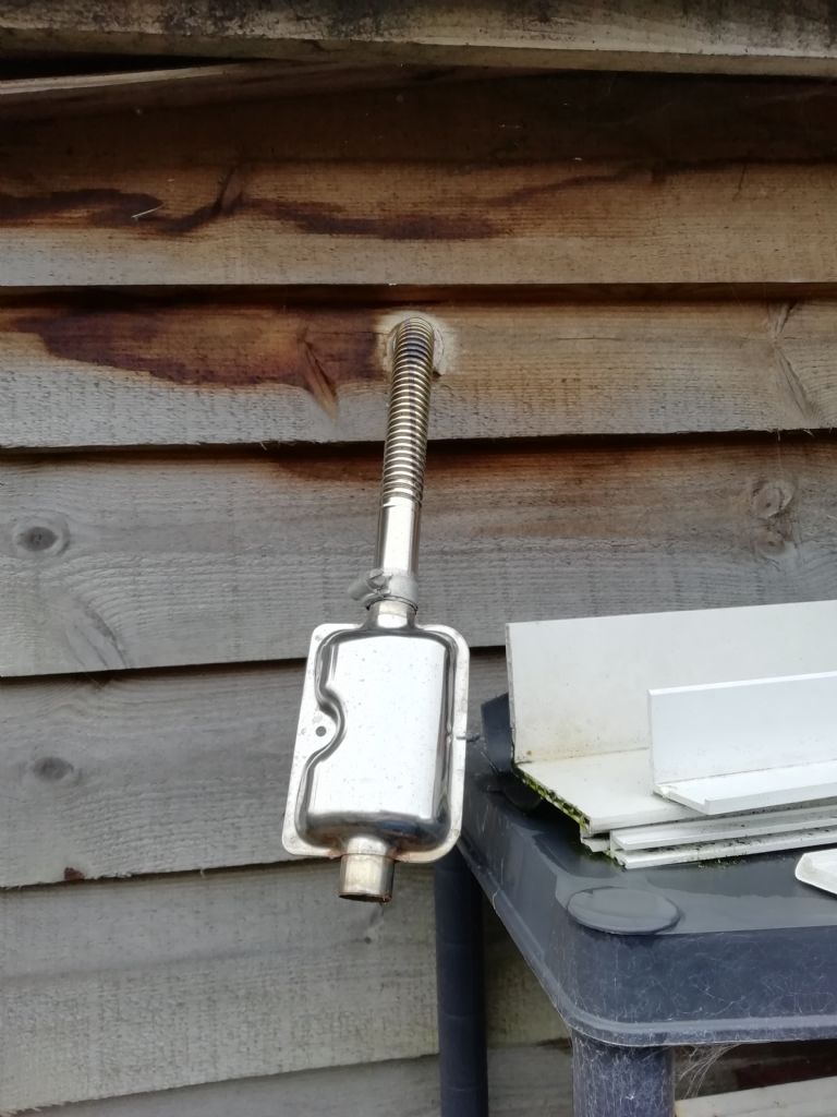

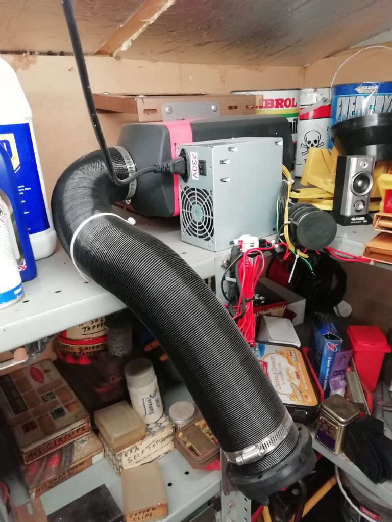

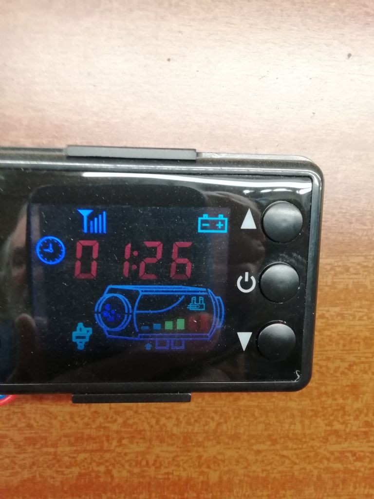

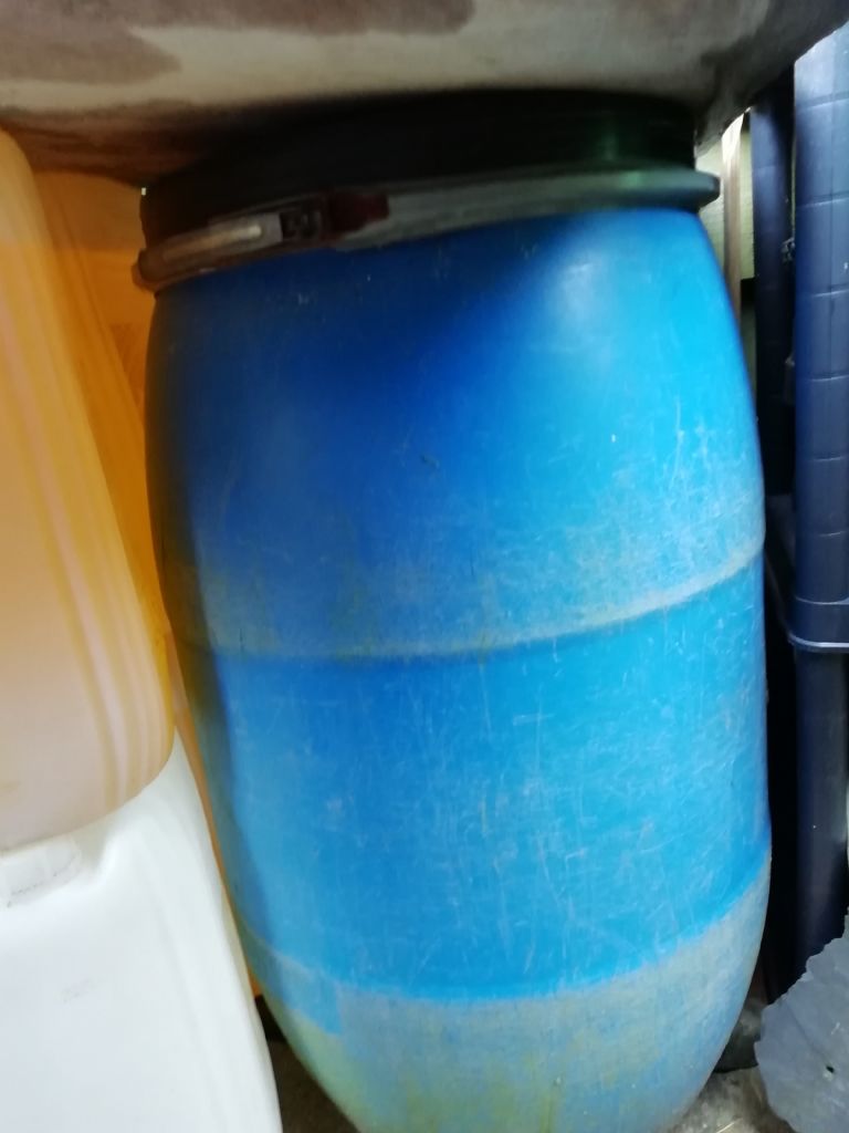

                                                    My 7 x 5 Metre workshop stands about 3.5 m high at the apex and is lined with 100mm insulation in the roof and 50mm in the walls. I have a diesel night heater, purchased on Ebay, which I run on kerosene, much cheaper and cleaner than diesel!
                                                    Main heater
                                                    Controller
                                                    Exhauster outlet insulated from the timber
                                                    100ltrs of kerosene, this will last me 2 to 3 years.
                                                    I turn this on when I get up (if I'm workshopping), walk the dogs and have brekkie and by that time the chill is taken off and it's comfortable to work in even if the outside temp is wee below zero.
                                                    Only downside is that the metal and machinery is cold to the touch but I have ways around that devil.
                                                    If I need it warmer for painting I just ramp up the heater and leave it on overnight, at less than 50p per ltr it doesn't break the piggy bank.
                                                    Roger
