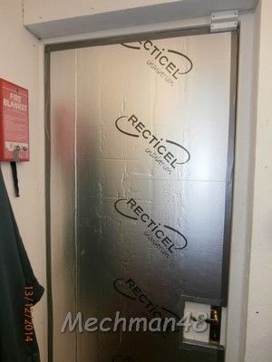

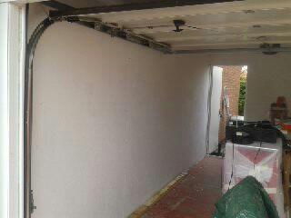

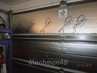

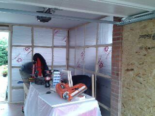

            I had written a long spiel about my garage insulation but having moved off write up to get pics, I lost it all… another pain in the arse with this forum format… this reply dialogue box won't keep anything typed, I have to copy & paste into word docx & save, have to do the same to reprint back into box.. enough of the gripes. A couple of pics to show the basic insulation set up..
            Insulated garage door..
            Access door..

                Posted by mechman48 on 07/11/2020 20:01:46:
                Access door..
                Thanks for persevering. I had a look at my doors – those panels would slot into the horizontal stiffeners perfectly. I’ll try to get some delivered.
