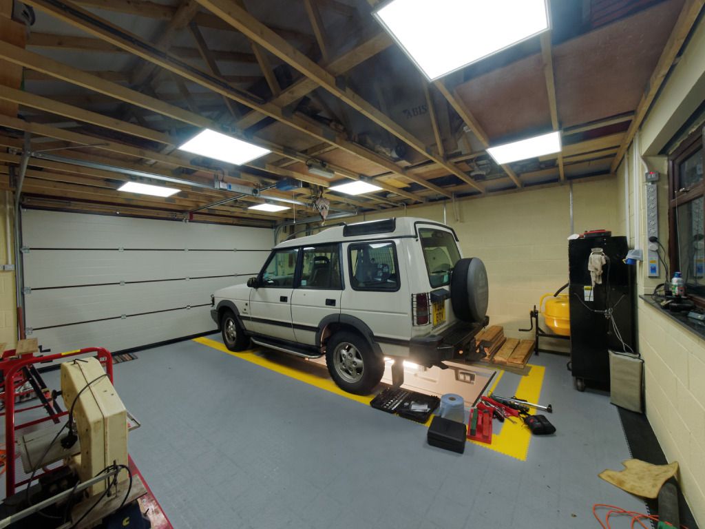

                                    When we had the new garage built, the builder was planning on using a self levelling screed to finish it off.
                                    Instead, I ran over any high ridges etc with an angle grinder and used interlocking vinyl tiles from PlasFloor
                                    http://www.plasfloor.co.uk/
                                    Note that they are plastic so might be damaged by weld splatter, but seem functional enough and easy to clean.
                                    Over a large area, there might be a bit of an issue with expansion/contraction as temperature changes.
                                    When the garage door is open, the morning sun in the summer shining on the front part does cause it to ripple a small amount, but it is over 5m wide.
                                    New Garage
                                    The garage is now rather more full, but the floor is still OK
                                    Bill

                                          Hi peak4. Nice set-up ! Just wondering: have you ever used a trolley jack or axle stand on your tiles? If so, do the tiles stand up to the highly concentrated load, and does a loaded trolley jack sink into the tiles at all and make it difficult to roll when loaded?
                                          Do the tiles recover from a heavy point load or does it leave a 'dent' in the tile surface?

                                            Posted by John Doe 2 on 31/01/2022 12:50:30:
                                            Thanks.
                                            Trolley jacks aren't too bad, even with the Disco, but axle stands certainly do dig in. One set of mine have flat plates welded to the bottom of each leg, which seems to be the way to go.
                                            For obvious reasons, it's worse in hot weather as the plastic is softer.
                                            If you have a look through the manufacturer's web site, heavy machinery seems to have the tiles fitted around it, and the installation instructions do mention leaving expansion space around the edges.
                                            At the front of the garage near the door, I've now got Dexion shelves each side, and cut small holes, so the legs sit directly on the concrete, to allow a bit more movement for expansion when the sun hits the front in the summer.
                                            The centre is catered for by having a pit in the middle, and the rear, whilst full width, is in the shade, so doesn't seem to have a problem.
                                            Bill

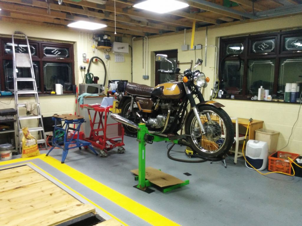

                                                  Posted by Clive Foster on 31/01/2022 15:22:02:
                                                  Peak4
                                                  Will yours stand up to motorcycle centre stands. In my case around 500 lb of Norton Commander rotary and 630 lb of Yamaha GTS 1000 "funny front end". Dont really want to add load plates because the whole idea is to reclaim all the garage space.
                                                  Clive
                                                  Clive, It will certainly manage a centre stand in the short term, though I suspect if left over a hot summer, you would develop dents.
                                                  If I'm going to be leaving a bike for a planned long time, I tend to just slide a tile offcut under where the centre stand legs will sit.
                                                  Side stands don't seem to be a problem, but I do normally have a lump of wood under them, to keep the bike(s) more upright to save space.
                                                  My stable consists of Ducati 900GTS, Yamaha XT600, Triumph Bonnie T140, & Guzzi Le Mans3
                                                  When it comes to using a hydraulic bike table, I raise it slightly off the ground on four lengths of wood, about 2"x2" or a little larger. This takes the weight off the wheels at one end, and feet at the other, as Guzzi + Bench is quite a lot of weight, but the main reason is that the tiles, whilst fine to walk on, are a bit slippy. The first time I tried running a bike up the ramp, I ended up chasing the workbench across the garage.
                                                  At the end of the day, it is a vinyl tile about 3mm thick, so it will never be impervious to dents; on the other hand, it's easy enough to lift one and replace with new.
                                                  When I cut them to size, I used a bandsaw, and a small block plane to tidy the edges.
                                                  The dovetail edges need tapping down with a hard(ish) rubber mallet.
