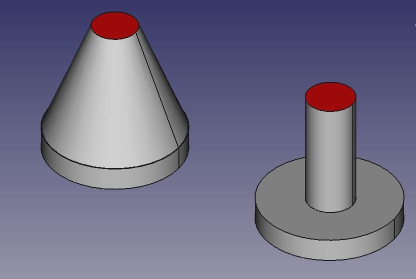

            Posted by SillyOldDuffer on 07/02/2022 16:45:57:
            Although concrete screed isn't as good at distributing pressure as chipboard or floorboards, I think it would be safe to support heavy machines provided a stiff board were placed underneath to guarantee load spreading. For example, a length of kitchen worktop 52" x 24" under my 800lb lathe and stand would reduce the floor loading to about 0.7psi, which is trivial.
            It's not that simple I fear, it all depends on the relative stiffness of the chipboard and concrete. If te chipboard really did convert point load into uniformly distributed, you could consider it the other way up, a 52"*24"worktop supported at the corners with 800 lb of sand distributed across the top surface. I wouldn't be surprised if it broke, at the very least it will deflect quite a long way.
            #585196
              Posted by duncan webster on 12/02/2022 12:36:53:
              True the sum isn't that simple because the board bends! Does it matter? I don't think a kitchen worktop would deflect much when laid flat on a floor because the load is in compression and is supported underneath throughout. It would protect the concrete screed considerably. Be interesting to measure it. Lying on the floor is different from glued or screwed to the floor, but I've no idea how much better a fixed board would be.
              A worktop flat on the floor isn't the same case as being supported at the corners and acting as a bridge. The latter imposes a severe tension load and the corners ground the total forces in concentrated form. Nonetheless, not impossible to support 800lb on a kitchen worktop bench provided the structure underneath supports it properly.
              Sam asked if I took vibration into account? No, and I don't know how to! I guess machine vibration wouldn't break a screed on polystyrene floor, or underground heating elements, but it might break electrical or plumbing connections. No idea how vibration proof underfloor heating is.

                  Posted by duncan webster on 12/02/2022 15:50:10:
                  SOD tried to argue that putting a worktop under a lathe would make the load applied from the floor to the concrete uniform. The lathe is (I assume) applying 4 point loads, so that would be exactly equivalent to having it upside down on 4 points supporting a uniform load as I said. It is irrelevant that you could support 800kg on a worktop by supporting it properly, you could put more legs on the lathe if you were that way inclined.
                  In reality the board will spread out the load a bit but to nothing like that extent. To work it out properly would not be trivial. According to Google the Young's modulus of 'particle board' is around 0.3 GPa Echip, whereas concrete is between 30 and 50 GPa Econc depending on the mix, say 40, so 133 times greater. Steel is 207 GPa for comparison. Worktop is typically 40mm thick, whereas the OP's concrete was 50mm. Stiffness is proportional to the cube of thickness, so the concrete will be (50/40)^3 * 133 = 260 times stiffer than the worktop. The bending load will be shared in proportion to the stiffness.
                  In short, the concrete needs to be thicker, even my kitchen floor is 100mm on top of 100mm hardcore, and the heaviest thing on that is the washing machine. Actually it's me, but we needn't get personal!
                  Not guilty this time, because I don't claim the load under the worktop is uniform!
                  All I'm saying is putting a worktop on the floor under a lathe will spread the load, and if the worktop was perfectly rigid, my simple calculation would be about right. Duncan says, correctly, that the actual pressure depends on how stiff the worktop is.
                  It's the difference between these two constructions:
                  They have the same areas top and bottom, so a load on the red top would put much the same pressure on the lower disc. The cone on the left represents my view, the column on a disk is closer to Duncan's position. The problem with the column bearing on the disc is that it will tend bend the disc so the pressure underneath isn't uniform: it will be higher directly under the column than at the edge.
                  The risk is putting a worktop flat on on a underheated floor wouldn't spread the weight of a heavy four-footed lathe evenly enough to prevent damage. An experiment is called for! I can't think of an easy way of measuring or calculating a pressure distribution caused by the support flexing. Suggestions anyone?
                  On the plus side, heavy objects like lathes are often successfully moved across soft ground by laying boards underneath. On the down side, boarding a lathe safely across a lawn doesn't prove an expensive floor would be completely protected.
