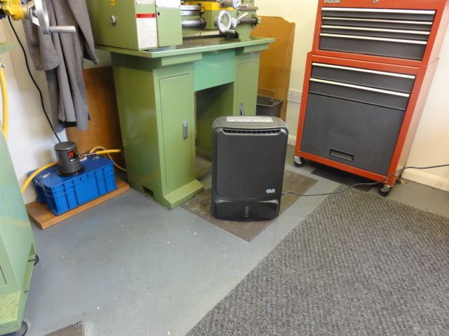

            #499298
            Jim Nic
              @jimnic
              Bob
              I'm not familiar with the machines you refer to. Mine claims to have a capacity of 8 litres per day but the collection tank is only about 1 litre capacity.
              This is mine, 350mm wide by 500mm high, branded ELU. It is a dessicant wheel device. A fan collects the moist air, drives it across a rotating dessicant packed wheel which extracts the moisture then blows the dried and slightly warmed air back in to the workshop. A second fan blows warmed air through the wheel later in its rotation to extract the water and collected it in a tank for disposal.
              I have seen some so called dehumidifiers in the past which are just a container of silica gel dessicant which sit passively collecting moisture which you then have to dispose of by heating the gel in an oven; I would avoid such a device.
              Hope the somewhat basic description helps.
              Jim
