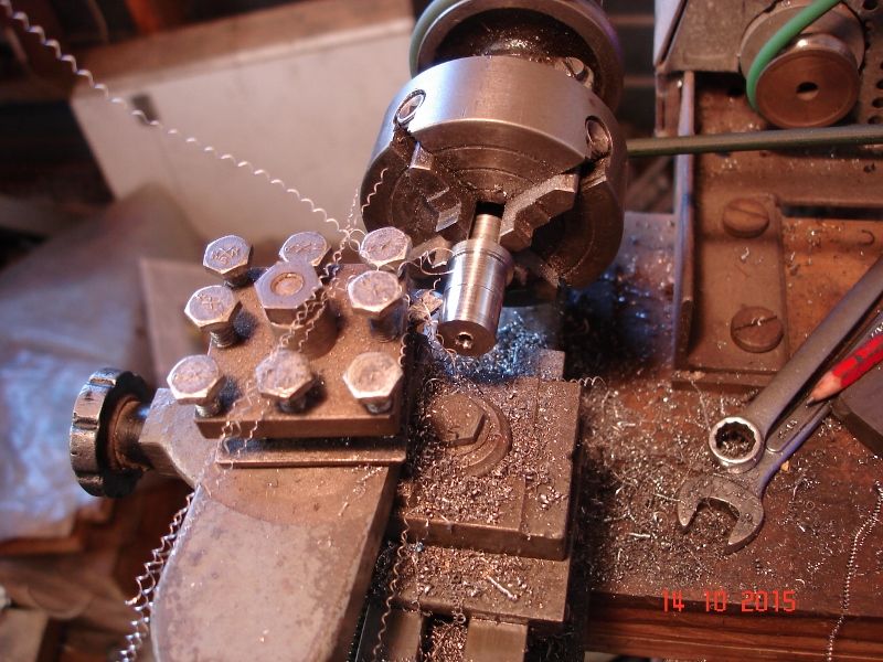

                                          Ian S C
                                            @iansc
                                            My 13 x 26 BH Taiwanese lathe has a gear box with 40 imperial pitches, 23 metric,23 diametral, and 15 modular pitches, and 40 different feeds. But then it's only a cheap Taiwanese machine, basic lathe without stand 275Kg.
                                            Don't over look a good lathe from else where, although I would look at a Boxford before I even thought of a Myford.
                                            For a bit of fun you could go this way, my Super Adept chewing its way through a bit of 304 Stainless.
