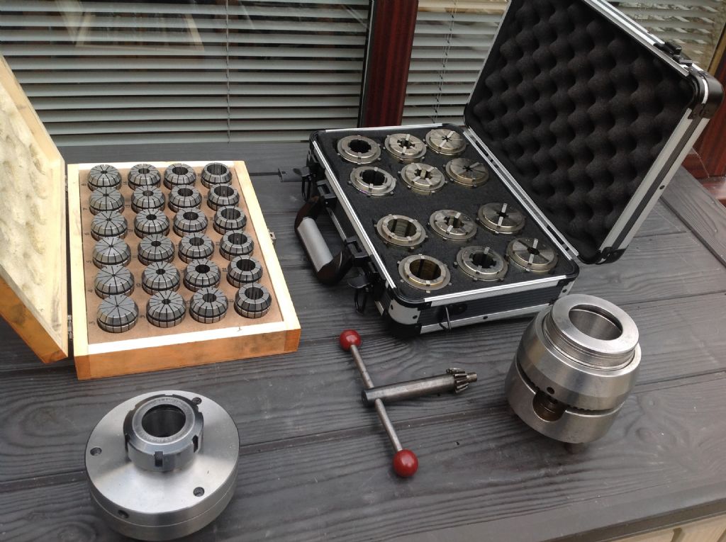

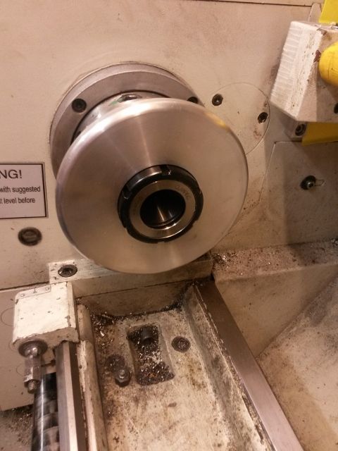

                                    I've got an ER40 on my Chester Crusader. Collets go up to 30mm, (32mm is also available). I made er ring to fit the nut, allows for quick opening of collet.
                                    Main advantage of 5C is that hex and square collets are available. I'm very happer with ER!20140802_110220 (480x640).jpg
