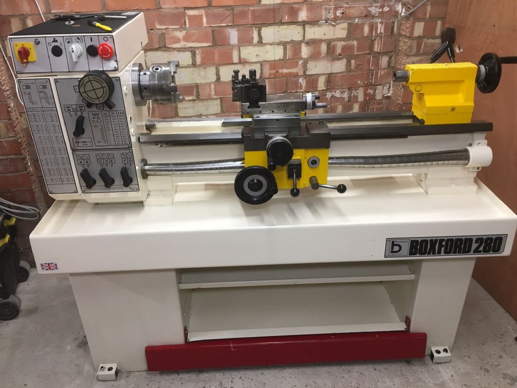

      Quick lick of paint as advised using Hammerite Smooth Cream..

        Looks good. I'm not convinced my 280 is any better than yours? smiley.
        Is yours the one that GandM Tools had advertised recently?

          No pal it was from Premier Tools
          Do you know where I could get a 280 user manual? I have the parts manual
