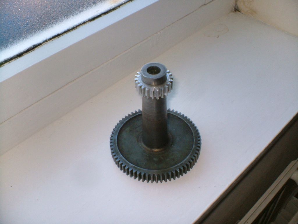

                Used ebay T6 to replace my damaged small backgear cog a couple of years ago and it's been fine so far.
                Has done many hours of milling/screwcutting/turning and seems to be tuff stuff
                Edited By Ady1 on 23/10/2013 09:23:37
