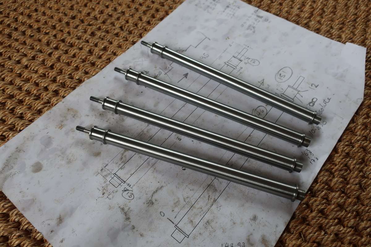

      Got around to making the studs for a couple of chucks. I got fed up with moving one set to the ER32 chuck and as I needed to make a backplate for a 5c chuck which also needed a set of studs.
      All the studs and the partially machined backplate

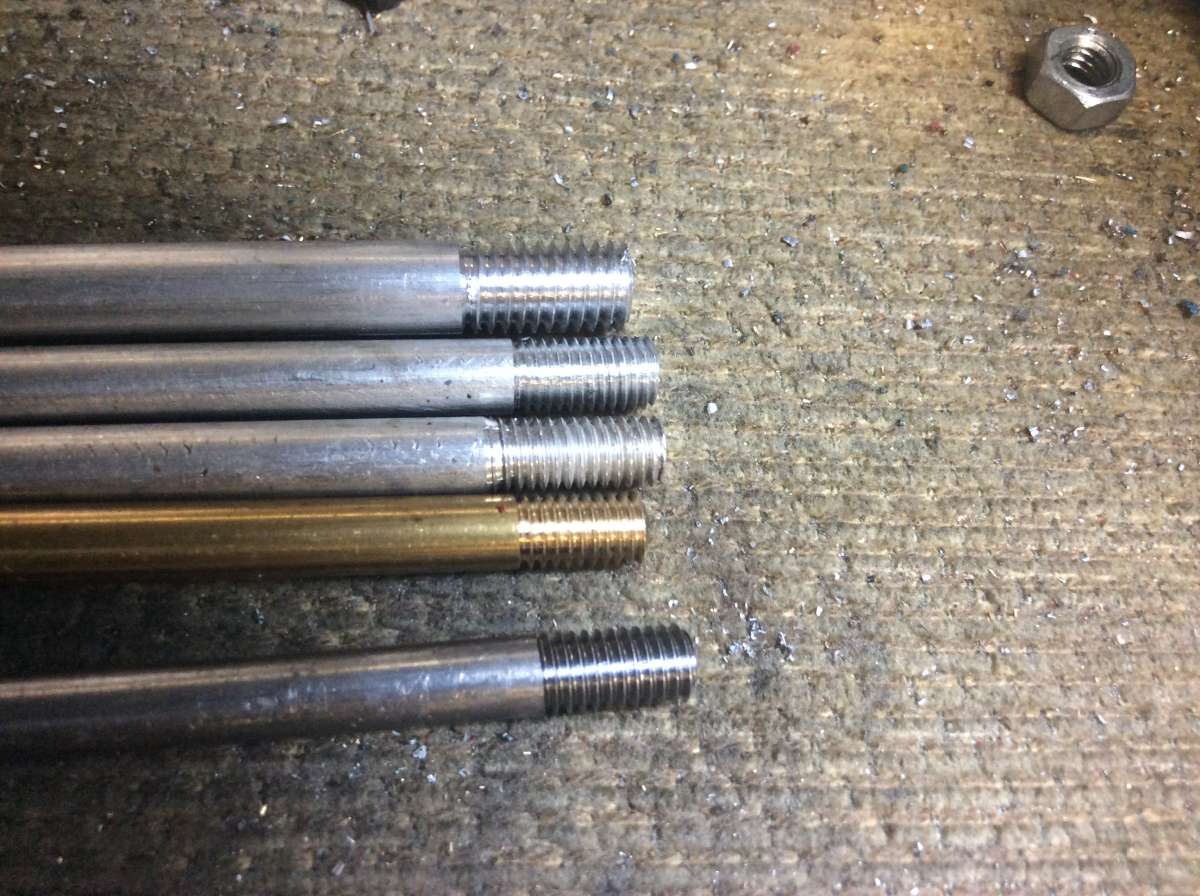

        Had a go at thread milling today on my S7, what a revelation!, virtually no load on the machine and tiny chips for swarf and full depth in one pass and you can stop the thread or let it run a circular groove, magic. Only problem is you need a motorised head for the tool post and a means of running the lathe SLOW my tacho gives up below 9 rpm so slower than that. also comm cutters for 55deg dont seem to be avail(a job for another day)IMG_3941

          Nice results, Bernard
          Your motorised head for the tool post might make a good article for the magazine.

            Not heard the term “comm cutters” but 55deg threadmills are available though mosly full form.

              Its commercial cutters Jason,yes they are available but at north of £100 a pop not for me.

                I don’t know what tpi you are cutting but these are a fair bit less until you git to the chunky ones, I’ve used their metric ones

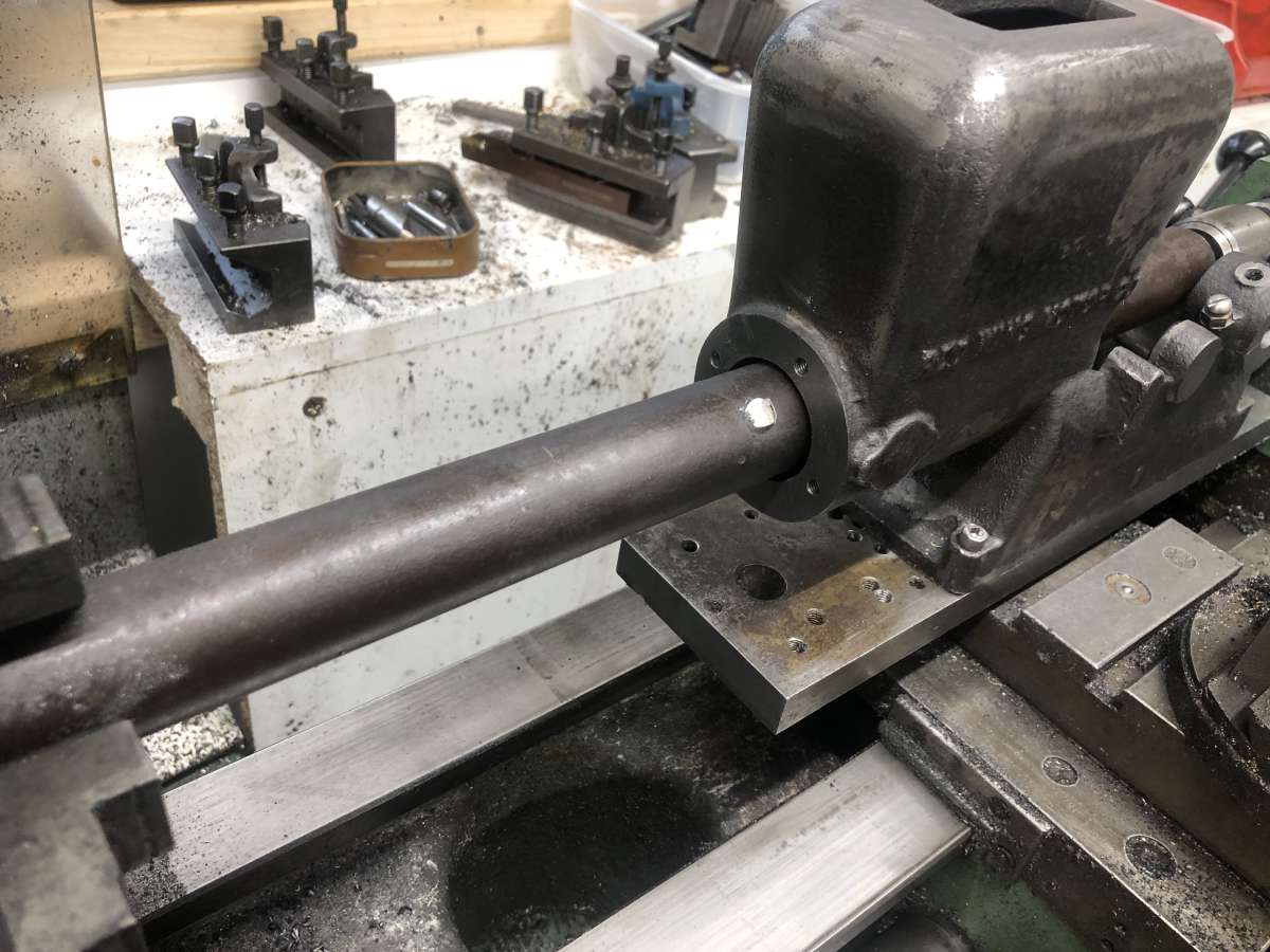

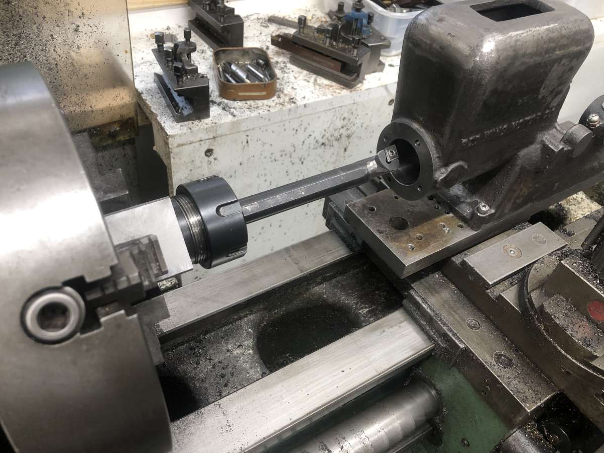

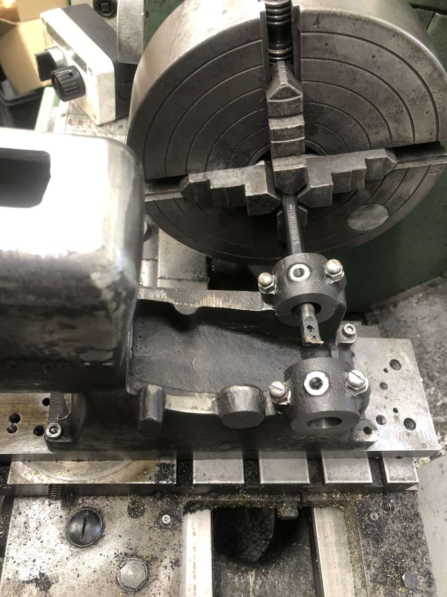

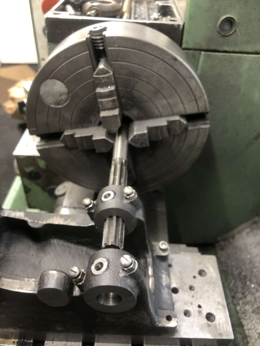

                  Yesterday I machined the Redwing cylinder bore and bearing housings, I  forgot to take any photos at the time so these below are ‘mock ups’ showing how it was done; I did not bother recreating the clamping!
                  the main casting was fixed to a steel plate of appropriate thickness to bring the estimated centre of the bore to the centre of the lathe. The actual height above the machined base is not critical, a 5/8 plate brought the height to within 0.015” of the drawing dimension so that would do. I made a between centres boring bar from an off cut of 1.125” round bar with a 0.325” bit of reground hss (ex broken centre drill) as the cutting bit. This was initially too large to pass through the casting so initial cuts were done with a conventional boring bar mounted direct in the four jaw chuck. After a couple of passes I couldn’t get anymore offset in the boring bar so had to remount it in a collet block to get the required cutting radius. The between centres bar was used for the final 10 thou in a couple of passes. Final bore was 1.248” to allow for honing. Turning the casting through 90 degrees allowed me to do the bearing housings and get the same centre height. These were drilled in stages up to 1/2” then a small boring bar was mounted in the four jaw to bring them a few thou under 5/8”, the final couple of thou being taken out with a sharp reamer. For all of these operations the casting/saddle was advanced by winding the tailstock barrel against the outer edges of the bearing to keep everything square. IMG_2742IMG_2743IMG_2745IMG_2744

                    Glad to see they are mock ups that looks like a screwcutting tool to me!!!
                    #810146
                      They can be used to bore, it’s only the pitch that makes the difference between a feedrate and a screw thread. Not much different to using the threading insert to cut a run out groove at the end of a blind thread.
                      #810181
                      Durhambuilder
                        @durhambuilder
                        Needs must! Yes I did bore it with a screw cutting tool, it was the only thing I had that would pass through the 1/2” drilled bore. I think I’ve used that particular tool more for small hole boring than screw cutting! With a very fine feed finish was excellent and at the end of the day it’s only the tip radius that differs, in effect I cut a 4000tpi thread in the bearing housings. I’ve  also used very small milling cutters for boring, just set one cutting edge up to cut.

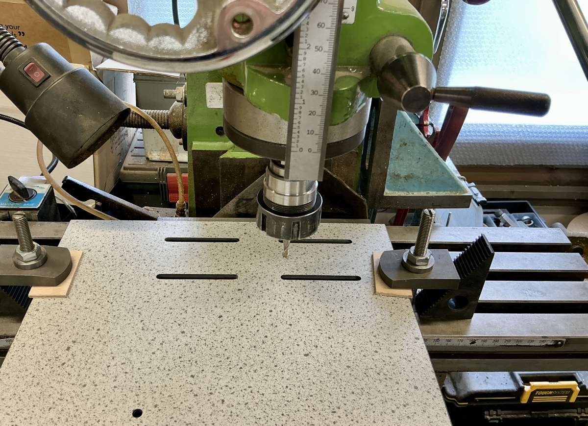

                            I finally got round to making a new base for my grinder setup. Today was cutting some 6mm slots in the Trespa to give me some adjustment for the grinding table.

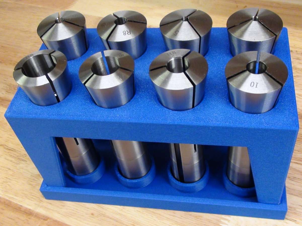

                                  While waiting for the delivery of an ER25/R8 collet chuck, I remembered that I’d got some R8 collets lurking in a drawer, so a quick measure up and an hour on Alibre Atom had the design of a collet holder done.  Expert to STEP file and print the two parts in ABS-Glass Fibre. A touch of superglue et voilà, finished.
                                  Collet holder
                                  Can’t decide whether to make a lid for it or not.

                                    In a drawer, No.  On a shelf, Yes
                                    Very nice and a good colour

                                      Thanks, Rod,
                                      They’ll be in a drawer, so I’ll save my filament!

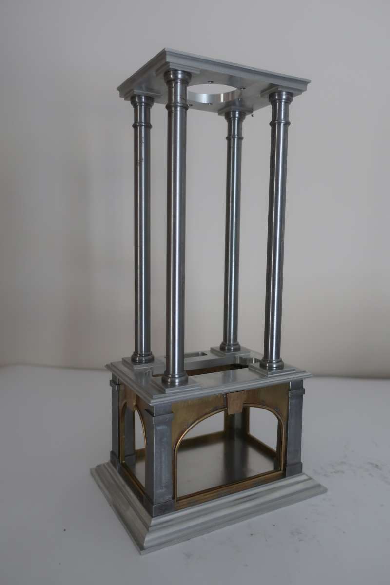

                                        Not sure that the photo flatters the capitals 😒 ..nothing a mandrel and graver won’t cure..
                                        IMG_2732
                                        #812261
                                        bernard towers
                                          @bernardtowers37738
                                          Now thats when your finish on the columns pays off!!
                                          #812285
                                            Coming along well, shame it is all likely to get painted
                                            Will you keep going up and do the cylinder next or drop back down for the bearing pedestals?
                                            #812306
                                            Diogenes
                                              @diogenes
                                              I’m still thinking over the best strategy for the cylinder, as I think it will be one of the more challenging bits of fabrication for me – so I’ll probably do the lower end first, ‘cos then I can keep moving forward whilst I think..
                                              #812317
                                              Diogenes
                                                @diogenes
                                                I see they’re going rusty even in the driest summer we’ve ever had..
                                                #812325
                                                  Sweaty fingers🖐
                                                  #812335
                                                  Diogenes
                                                    @diogenes
                                                    Yes – I must remember to dip them into the chip tray every so often 😁

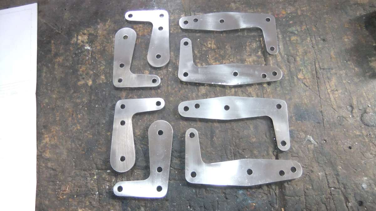

                                                      Trying to complete some of the just jobs as well as the Farm Boy engine.
                                                      First on the list is to finish machining the frames for the clamps that I need. So after three days I managed to get this far with them. Now to turn the spacers (On the smaller frames, I still need to open up the hole on the corner ones)
