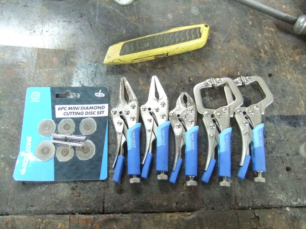

I was at a car show on Saturday and managed to pick up these six items(Stanley knife for scale) I thought at £5 for three items was a cheap enough buy to use them for small soldering jobs without too much heat loss.
They seem to have a positive feel to them for something so cheap.
Not sure how the plastic handle will hold up to heat

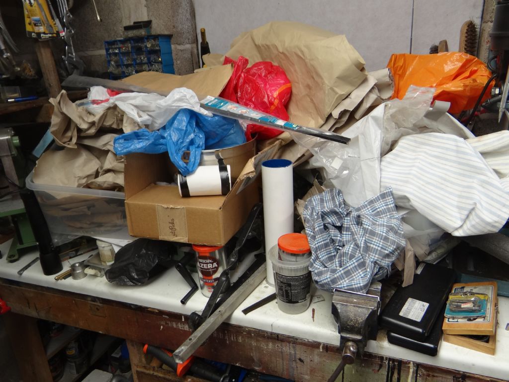

Yesterday I cleared my bench to make a simple brass adaptor to connect a vacuum pump to a capped length of PVC downpipe. A mild complication was the need to tap it BSP G1/8 to take a vacuum gauge. I need to measure how good or bad my ancient vacuum pump is.
PVC pipe and both end-caps were ready to go when I noticed I'd blocked the nozzle with plasticine. I carried the cap to my junk box in hope of finding a suitable poker. Having failed to find anything to fit the nozzle, I walked back to find a suitable punch. In the minute or two it took to find a punch, the end-cap disappeared.
Not tiny: the cap is an ⌀80mm Aluminium disc with a large brass pipe nozzle mounted on it. Wasted an hour last night searching, and decided it must have rolled out of sight over the floor. Sterner measures required.
Today, 3 hours wasted so far. A quick enjoyable turning and tapping job has become a massive hateful frustrating tidy up. I'm at the 'worse before it gets better' stage; this is my bench now:
To rub salt in the wound, I almost immediately found a tiny part dropped 2 or 3 years ago. It also was the subject of a long failed search.
Aaargh!

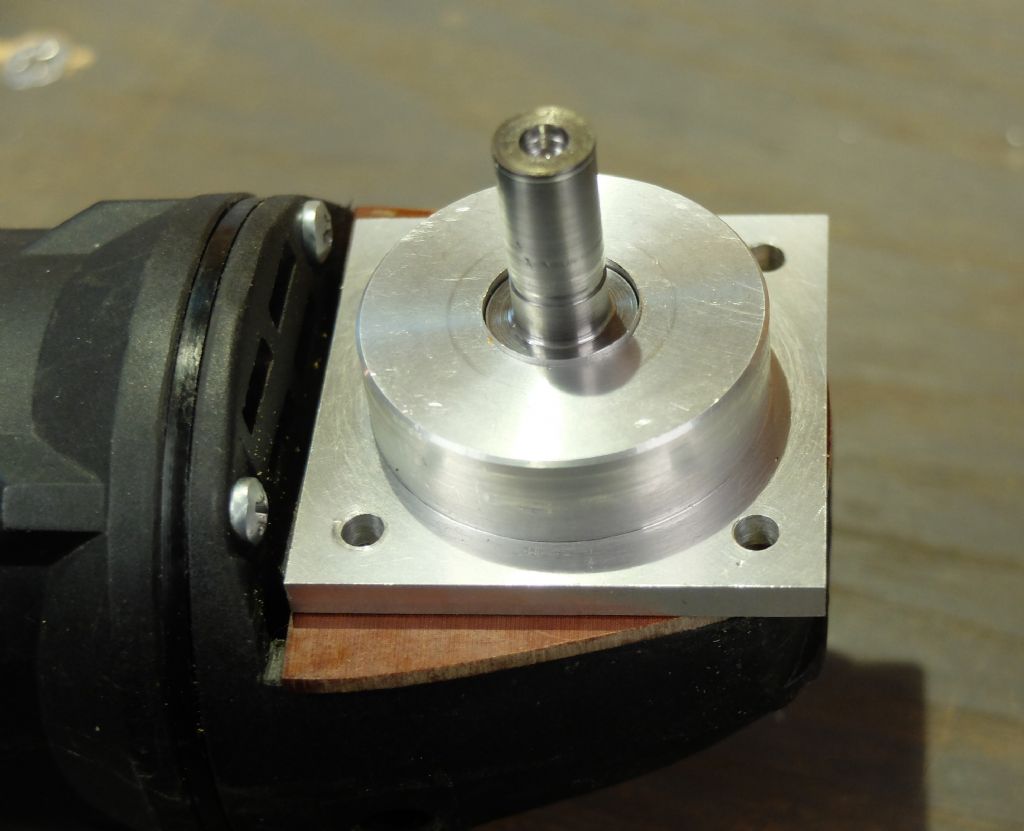

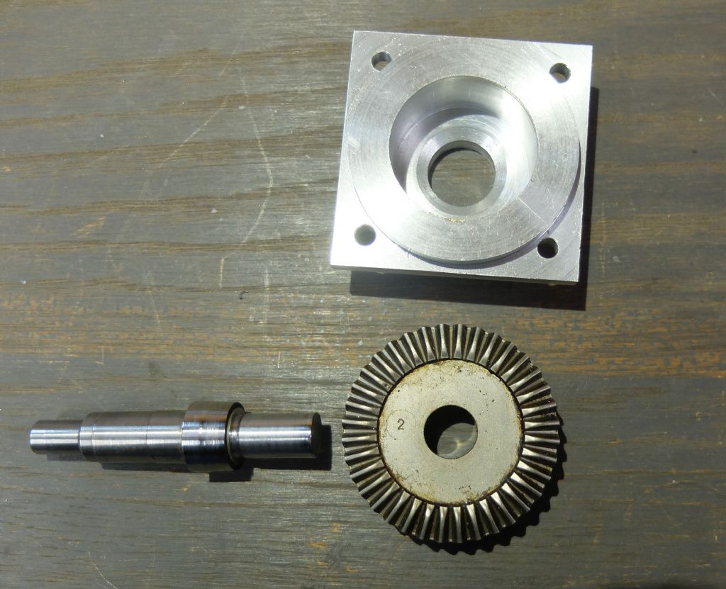

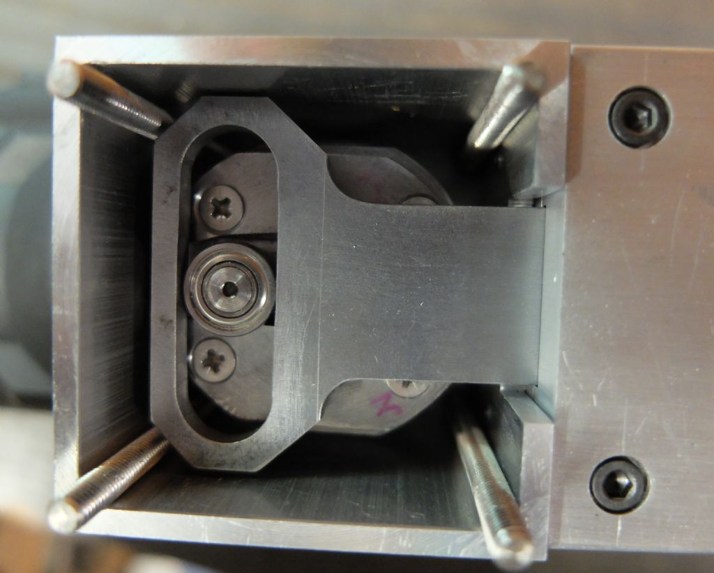

Hmm, almost a bit concerned about disturbing Nigel's efforts, but here is something not really from today, but from the last couple of weeks.
I built a scraping machine. You know, perhaps, that it is possible to buy one, But the prices, even for used ones, are way over my budget. Some years ago I tried to make such a machine from an old sabre saw, but it was much too wobbly and finally I gave up. Then I saw a short report from someone who built a scraper from an old angle grinder, and even with using some 3D printed parts. So I bought the cheapest (used) angle grinder I could find, and went to work.What I didn't see in the seller's picture was that the head of that grinder was not a casting, but a plastic part. But this was the smallest problem. My first difficulty was to remove the axle from the bevel gear. With much ddifficulties I finally managed that, and could then modify and shorten the axle. A new housing was turned from an aluminium bar, and a steel round with a slot served as holder and guide for a variable eccentric. A scotch yoke moves the scraping tool, and the whole apparatus has room in a piece of square alu tube. Well, that's it, in a nutshell
Oh, I almost forgot to mention that the machine does not run on grid power (that would be MUCH TOO fast!),
but on an old 19V laptop power supply.
Nice looking modifications Hans. The million dollar question is how does it perform?
