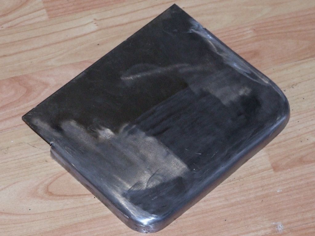

      Forming the real spectacle plates was a mixed bag. One total bog up and one that looks ok. Here's the one that looks ok, after trimming the flanged rim to roughly the right depth on the mill:
      I've also learnt some valuable lessons about flanging allowances that should make the remaining plates easier. I've run out of oxygen and acetylene so that'll have to be in the New Year.

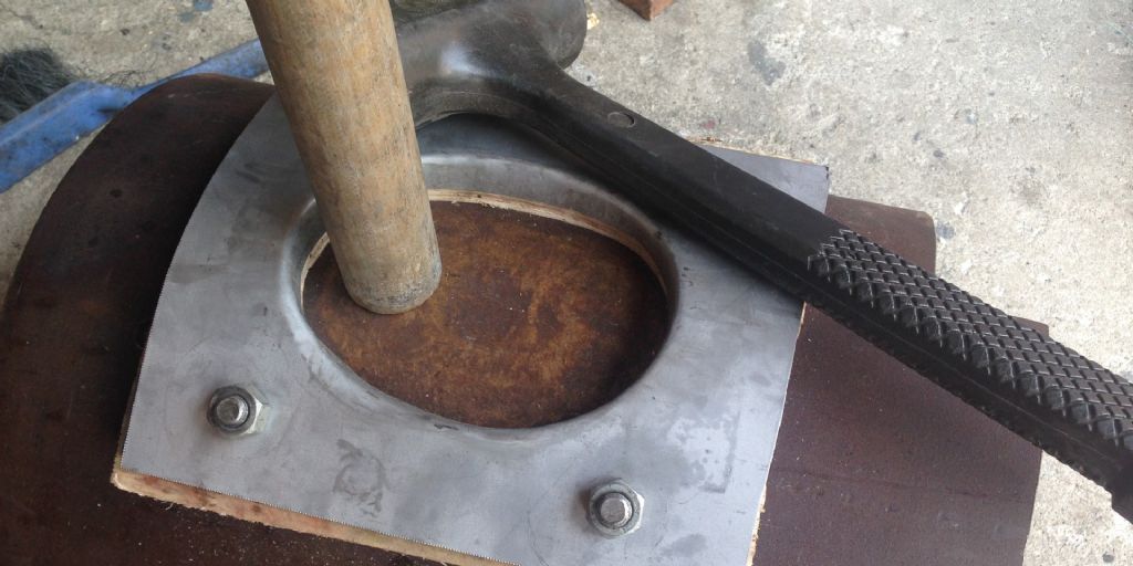

          More work on my traction engine, making lagging covers for the boiler.
          Temporary templates cut out of cardboard first to get an exact fit around the steam chest and boiler fittings, then cut out of steel sheet. The flange for the manhole made by bashing the metal sheet around a former attached to a piece of left over boiler tube with a bronze bar and hammer.
          Manhole flange attached by screws will be replaced with rivets.

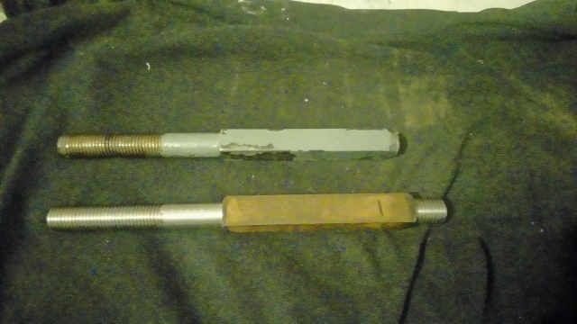

                  Not the most exciting part, a length of 25 steel bar threaded M20 on each end:
                  it took ages to drill, mill, file and heat the Loctite(30minutes on the stove while I had lunch) to unwind the broken off thread

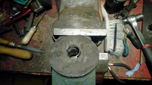

                  and the whole assembly stopping the freezer floating away:
                  It was quite exciting when that fell out of the bell on Monday…….

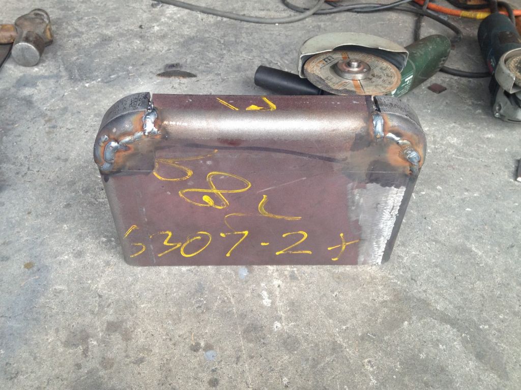

                    Andrew,

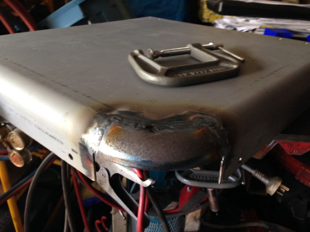

                    I made the spectacle plates on my engine by bending the 3 sides around a suitable former in a press and then welding in a segment of a pipe elbow (the flange radii bent to match the pipe elbow). Then a bit of grinding to smooth out the welds.
                    I also made the rounded corners on the tender in a similar way. (see below)
                    Achieving an accurate finished size to the outside of the flanged sides is the trickiest part as bending is one of the least accurate fabrication methods. I used Solidworks to model the plates in 3D which is able to prodice a drawing in the flattened state and show an exact position of the bend line for positioning under the press.
                    Paul.

                      Paul: Thanks for the pictures; that's a neat looking job. It'll be a fallback for me if I fail to flange properly. I'm going to have at least one more go at flanging. The existing plate isn't bad, but in retrospect I didn't get all of the flanges close to the former. That's partly my own fault for finishing late at night when it was dark, and I was running out of gas. On reflection I feel that I'm pretty near to getting flanging to work to an acceptable standard. The fullsize engines aren't perfect; so as long as I match them I'll be happy. I've also learnt that I can cut down on my allowance for the flanging which should make life easier. Especially on the corners where the excess metal causes the flange depth to grow. I've designed for a 3/4" flange and allowed 1", the excess being machined off. I can cut the allowance down to 7/8" and for the corners I can go down to 3/4" or even slightly less. Roll on the New Year when I can get some more gas!

                        Bending the flanges was quick and easy. The front spectacle plate was 2mm under size over the flanges after bending and was packed out with a 1mm shim on both sides. The rear plate was exactly to size. The biggest job was designing and making the press brake and form tools to match the inside radius of the flanges.
                        Good luck with your build Andrew,

                              Bells don't turn particularly quickly, and this is a small one. The clapper made a racket as it hit the frame and then the floor. What's slightly disappointing is that it's only twenty years old; the oldest was cast in 1588 and still going strong.

                                    Paul: Thanks for the additional information. I'm hoping to avoid packing, but if needs must!

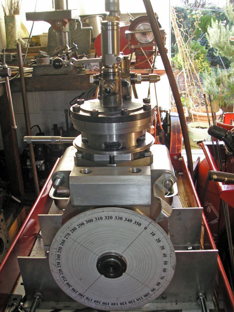

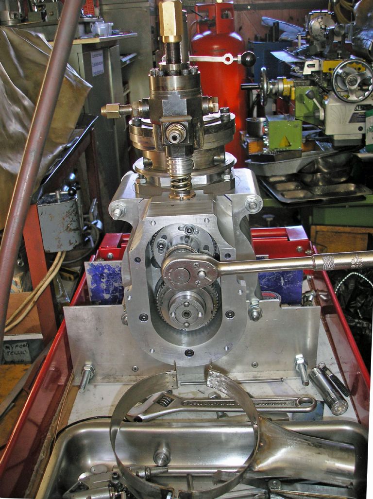

                                      At long last am at a stage to test run on compressed air.
                                      Unfortunately my compressor does not have capacity and high enough pressure.
                                      Going on my experience with flash steamers will need at a least 150psi and a lot of air my petrol head friend at work has a screw compressor and 150psi so in the New Year will see what happens.
                                      At 120psi it’s so near continually running and a sharp exhaust noise on air.
                                      With high pressure superheated steam could be an interesting noise.
                                      It has a variable compression release valve to ease starting but flattens my air supply.
                                      Will finish welding the exhaust manifold today amongst other jobs.
                                      All the best to you all for 2020.
