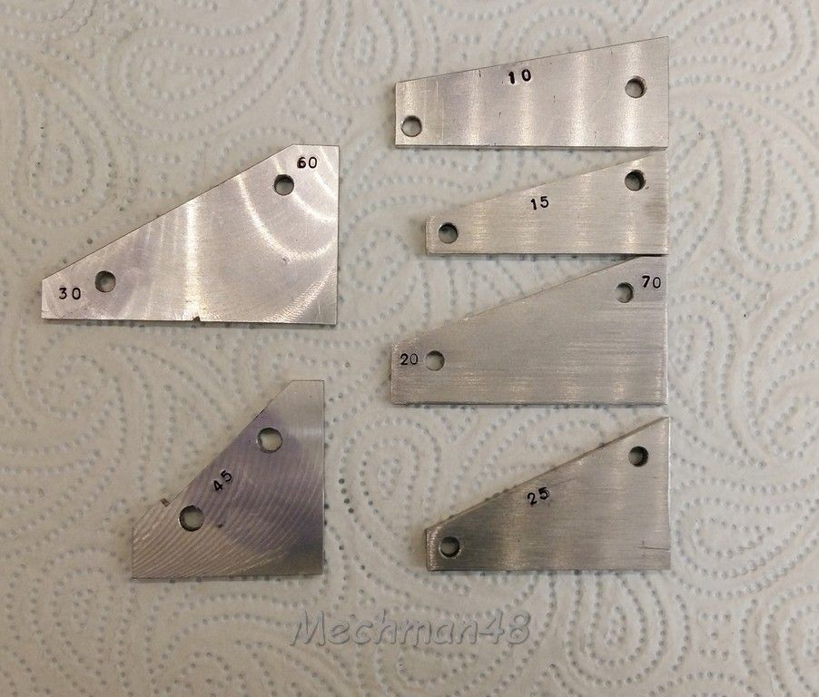

                  Finished off the set of angle plates; all within 0.1* according to my digi gauge…just need a bit more polish up…
                  George.

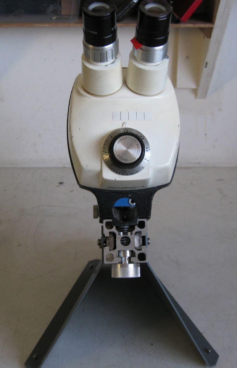

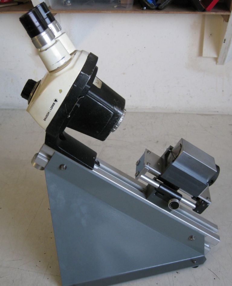

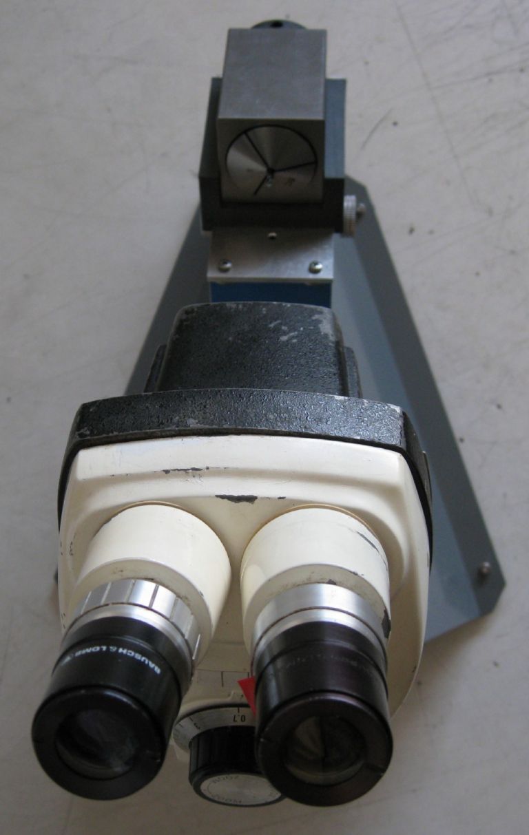

                    Completed my Drill Alignment microscope jig to align drills in my 4 facet grinding jig ( previously posted on).
                    The optical head is a Bausch and Lomb Zoom microscope, and I fitted a horizontal reticule in the right eyepiece after some advise and guidance from Robert Atkinson – Thanks Robert!
                    The 5C collet in a square block holder sits on a focusing stage as seen.

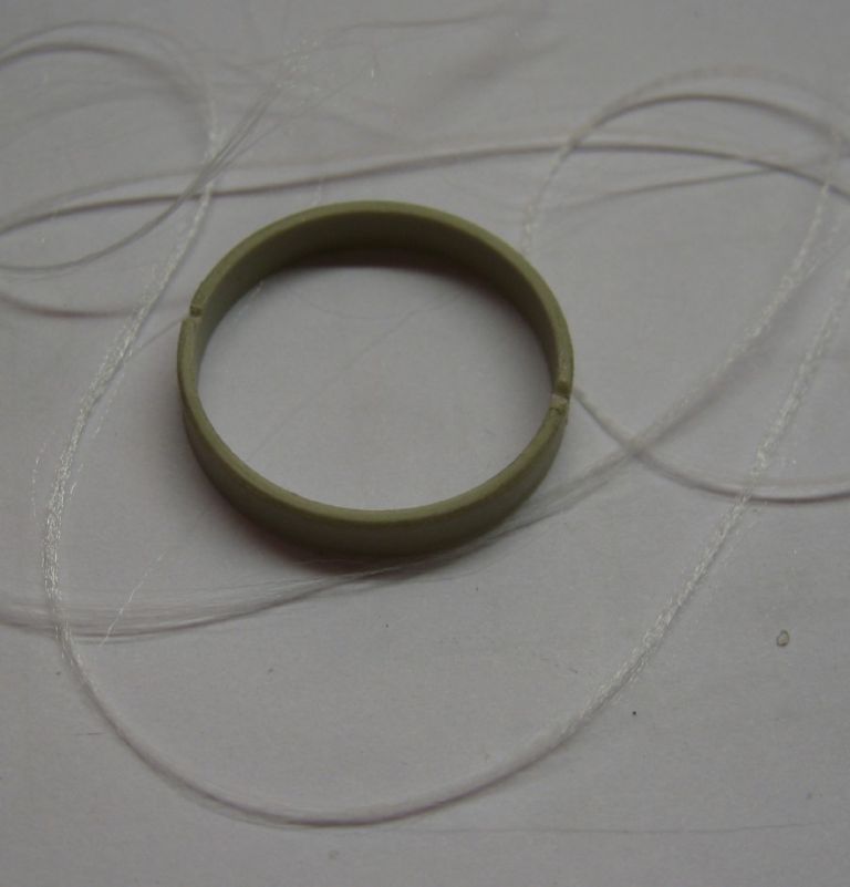

                    Th reticule is a plastic ring sized to fit inside a threaded reticule holder that screws into the underside of the eye piece. A single fibre of fibreglass was teased from some weave, and superglued to the 180deg apart slots made in the sides of the plastic ring. The ring then inserted in the holder and screwed into the eye piece until focused.

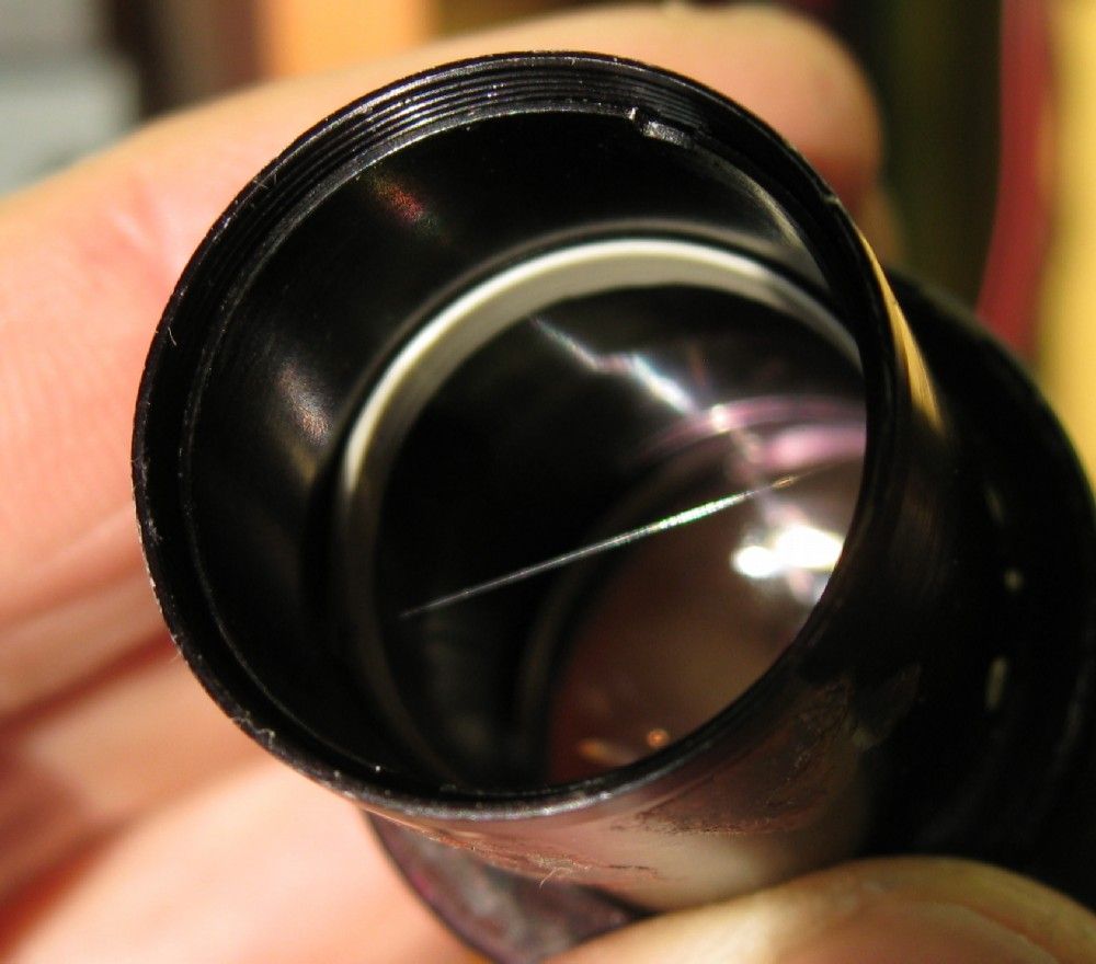

                    View ( focus was difficult..) of the fibre reticule in place, from the bottom of the eye piece.

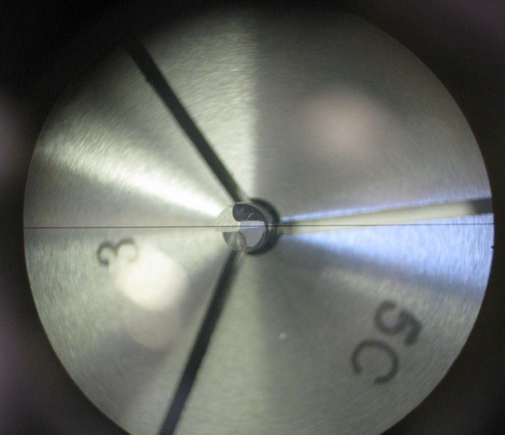

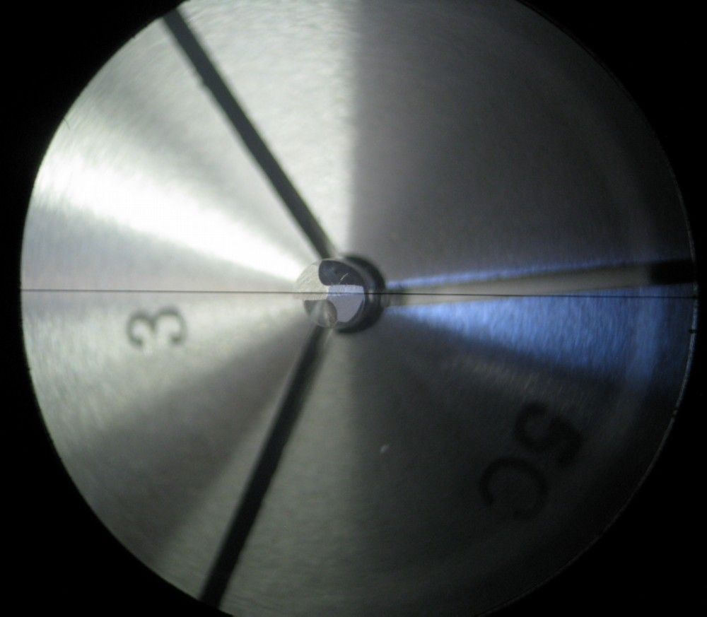

                    View through the microscope, focused on a 3mm drill, showing the reticule.
                    The camera was difficult to focus, being handheld, so the drill image is not that clear – it is VERY sharp when eye viewed.
                    The difficult part in the construction was getting the microscope sight-line horizontal and in line with the drill point at all focus ranges and zoom settings.
                    This at lowest zoom setting – at full zoom the 3mm drill fills just over half the image

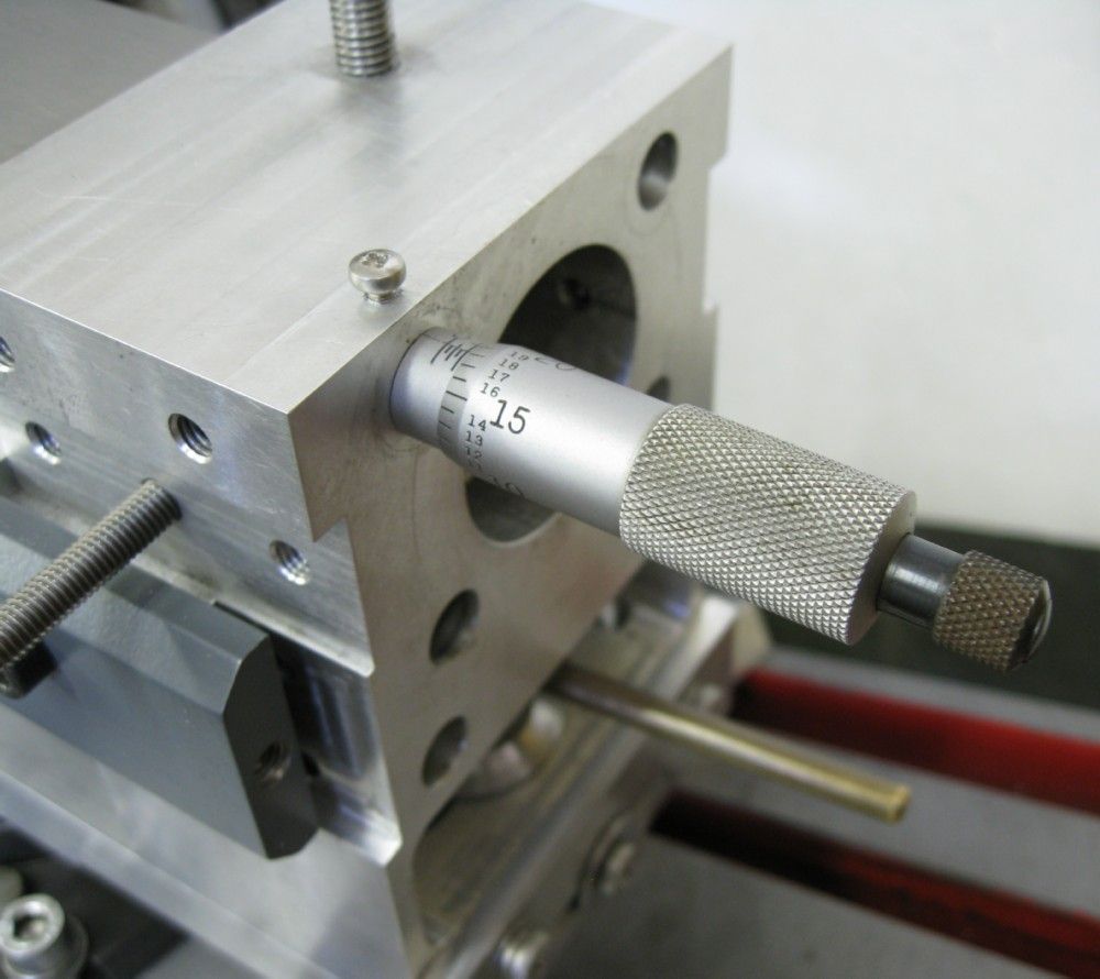

                    Then I added a micrometer to the drill grinding stage on the grinder to be able to minutely advance the drill to grind the primary facet – I was using the X slide to do that, but with small drills ( sub 2mm) the movement is difficult to keep fine. The micrometer makes it a doddle!
                    Makes sharpening drills a pleasure!

                      Just to be pedantic 0.1 degree on a wixey type gauge is six minutes.
                      A 0.1 degree error is only 1.7 thou per inch, or about 3 thou over the width of the gauge.
                      #390088
                      mechman48
                        @mechman48
                        Thanks Neil; I'll not worry over 1.7 thou' per inch in what I do
                        Geo.

                            Joseph, I've puzzled about this for a long time. As soon as you grind even the smallest amount off the end of the drill, it's cutting edge is no longer horizontal. Shouldn't you set it so that after a known cut the edge will be horizontal? Of course that implies knowing the helix angle and they are not all the same. I asked DG Brown the same question once and he replied you should set it as I suggest and that you soon learned by experience how much to set it off horizontal.
                            #390508
                            Joseph Noci 1
                              @josephnoci1
                              Duncan, you are quite correct. I try now to do as you say – If the grind is just a 'touch up', I align and grind the secondary facet, and then re- align to do the primary, especially on the drills smaller than 3mm or so. If the drill end is bad, I hack it off-hand to be rid of the chipped parts, etc, then align and grind a secondary, and then re-align and redo the secondary, and re-align and do the primary. It sounds tedious but at least with this microscope jig its quick to align.
                              I suspect I ( you and I?) are/am being over-fussy, since the many 4-facet jigs built by many folk seem to work ok? gadgetBuilder et-al seem to have working devices and they do not bother with the error. I suspect though they are all just 'sharpening', not regrinding!
                              I guess it all depends on how much you are taking off of the tip.
                              Joe
